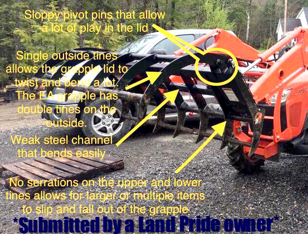

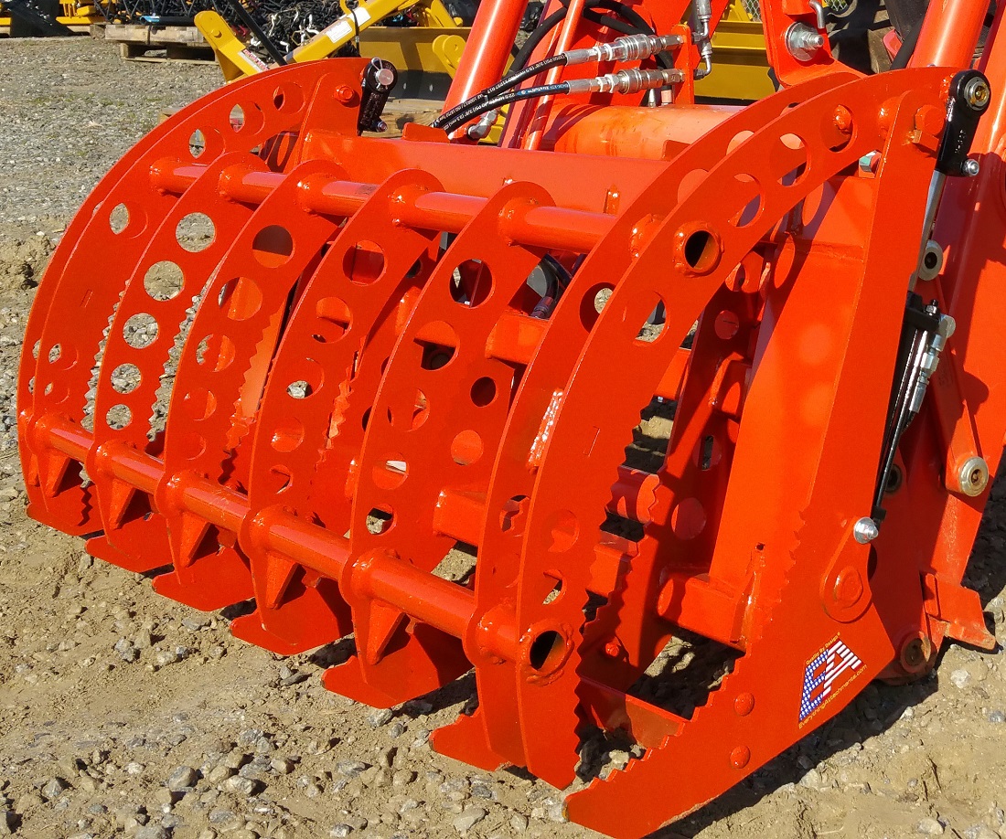

Design. End tines are doubled up. Doubled up center mounted hinge point, greasable pivot points, and the thickest walled DOM round tube you've ever seen on a grapple running through the lower tines to prevent bending. Each lid tine extends to the 2nd lid tube instead of just welding a triangle on the leading tube like the LP(10 series). We even take it a step further and gusset them, which provides extra insurance against bending. Our way is stronger and will also hold onto small and/or loose debris more efficiently. Even our front lid tube is DOM. Solid, continuous welds. Serrated upper and lower teeth for gripping and ripping.
Our Wicked Rake lineup gives me the ability to provide an ideally sized and weighted grapple for subcompacts all the way up to 100HP machines!
The Wicked 55 is just over 200 pounds, the Wicked 60 is 400 pounds, and the Wicked 66 is under 700 pounds.

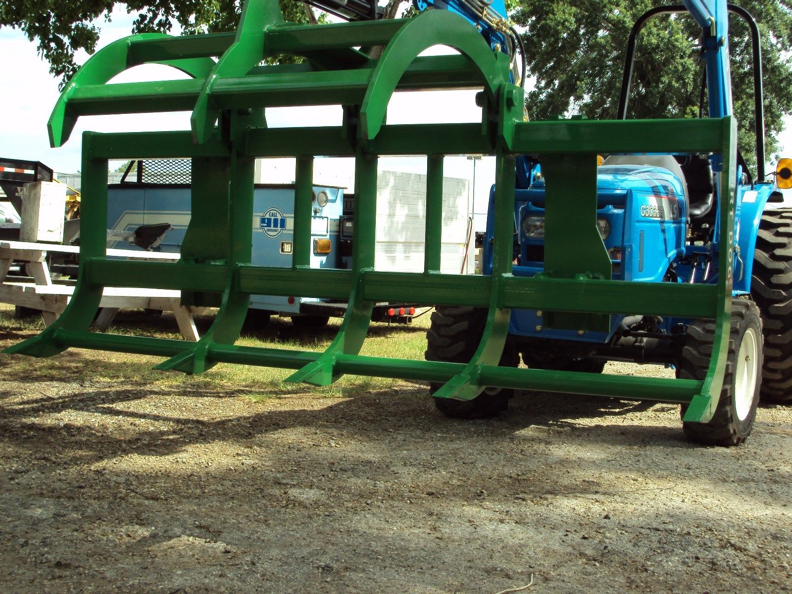

What I see is funny is advertising a root rake grapple for a small tractor, the tractor does have enough power to actually use it. Not bad mouthing a grapple, I like them, but the root rake is a joke IMO. Used one with a 50hp JD 4x4 and there is no way even with its filled tires that it would do much more then scrape the surface, and if you went a little deeper the tractor just spun wheels. The flat stock across the tines would stop it anyway.
To use a root rake you need a dozer
It was one of these, note round bars on bottom

The 55 remains with the outer hinge points. It has held up great and we'll leave it as is to conserve weight. The DOM tubing really adds to the rigidity vs no doubled up outer tines on the LP and no DOM tubing.

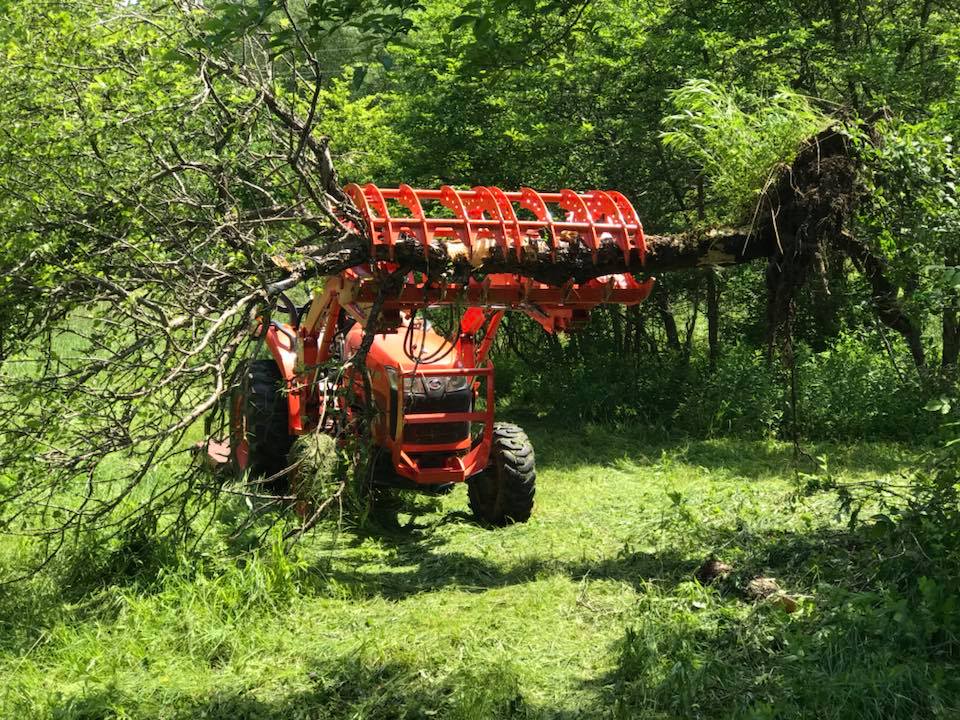

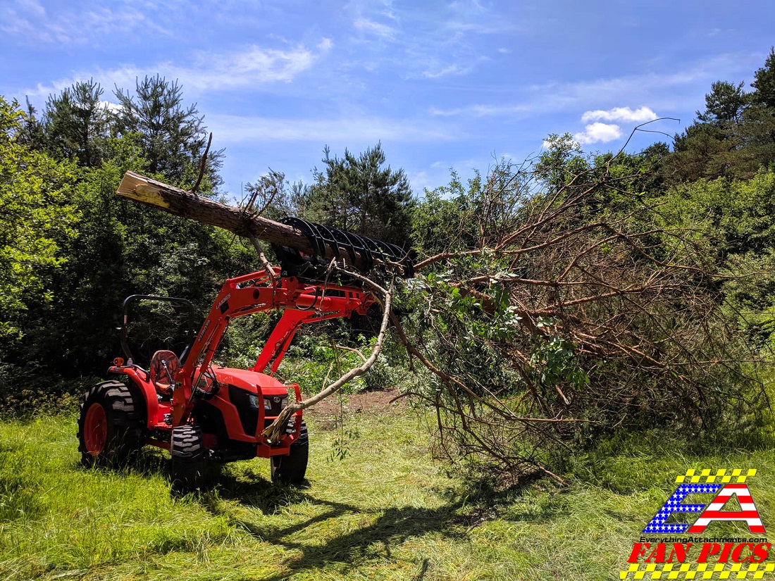

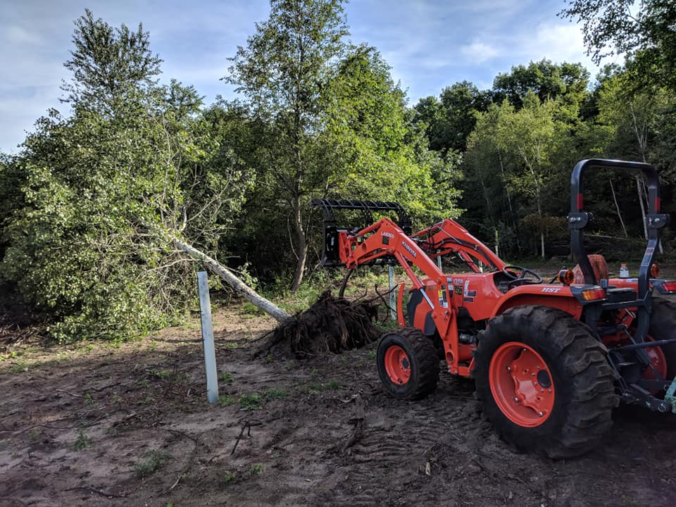

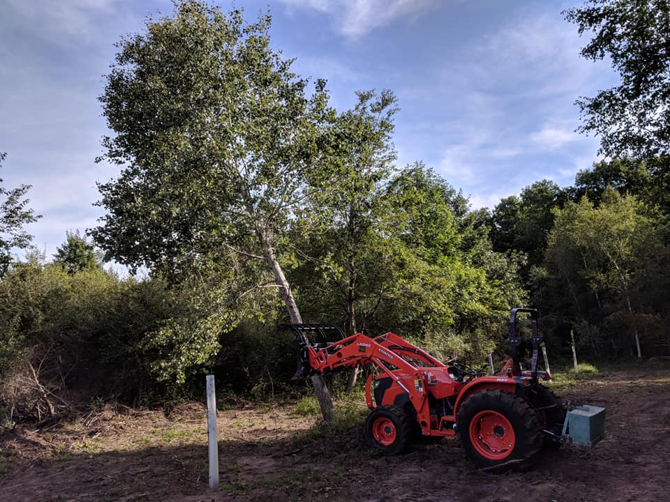

This review by a guy who chose the 60 comes to mind...
"EA 60 inch Wicked Root Grapple, I talked to Travis about both the 55 and the 60 inch root Grapple for my L3800. I had a lot of storm damage in my apple orchard that needed to be cleaned up. I would recommend giving up 200 lbs of lifting capability for the strength and durability of the 60 inch 400 lb root grapple. I'll gladly make more trips with the Wicked 60. My L3800 can't cant hurt it, it's built for a much stronger tractor. Don't worry about the wait time it's well worth it. My neighbor purchased a land pride for his 60 horse tractor, didn't want to wait for a wicked sixty. he crushed it on the first day moving firewood. I came in and completed the whole job in 40 minuets, didn't chip any paint. Boy was he pissed. LOL Wicked 60 all the way!"

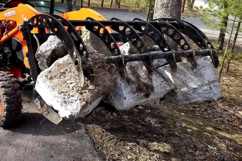

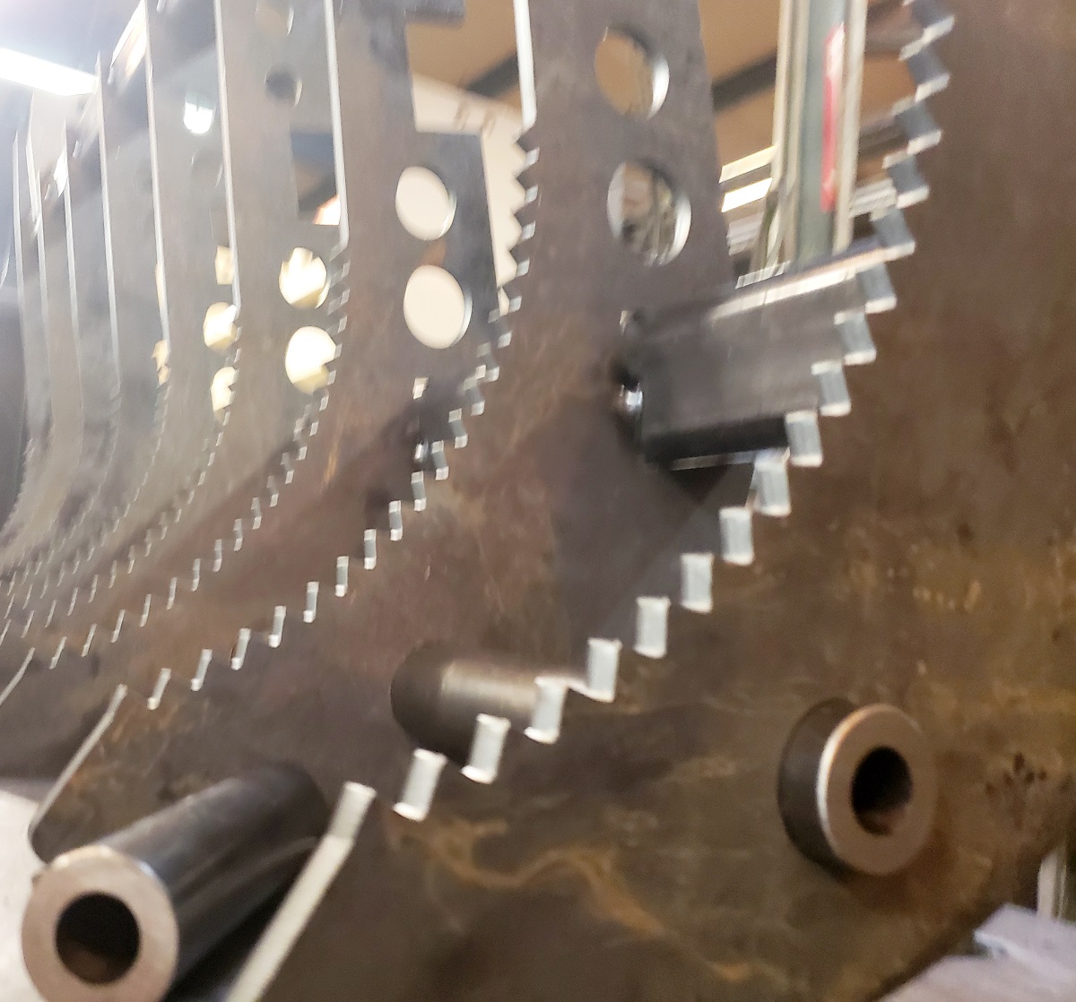

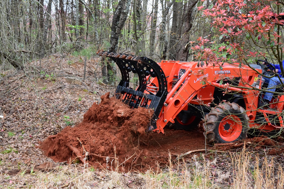

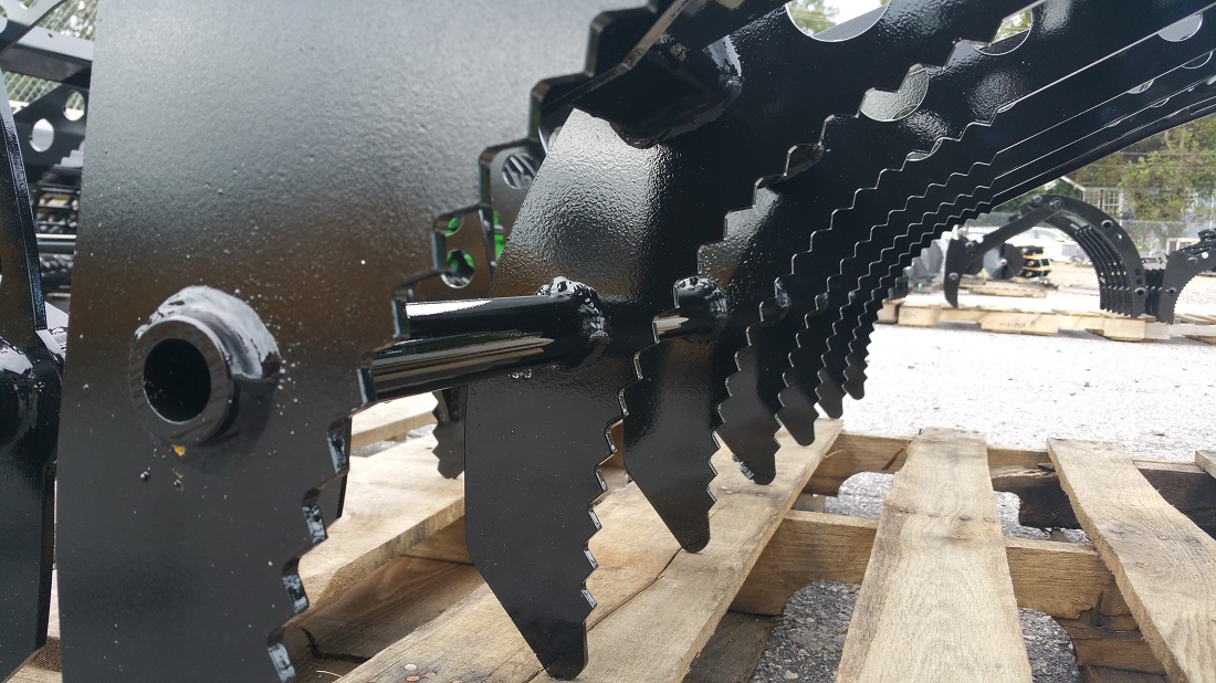

All Wicked Grapple rakes now feature round, thick walled DOM tubing on the lower tines and on the front of the lid. It's all about putting the weight in all the right places. This tubing expensive, premium material and thicker than anyone else uses, but it's incredibly strong.

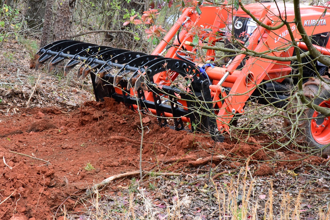

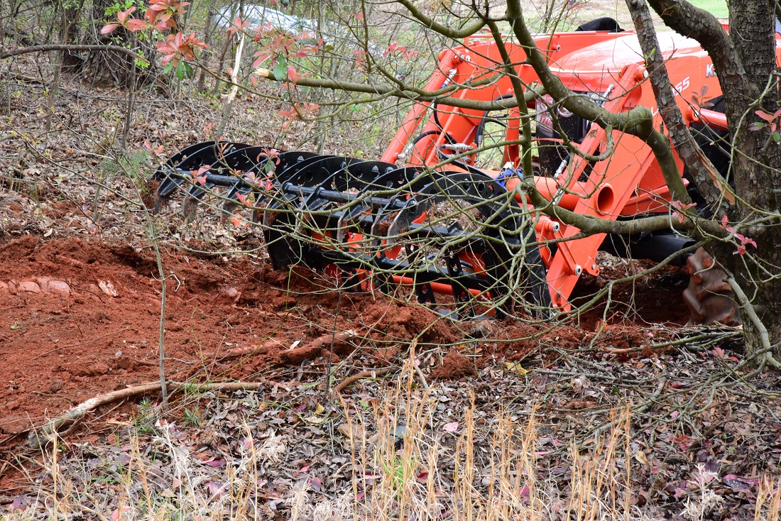

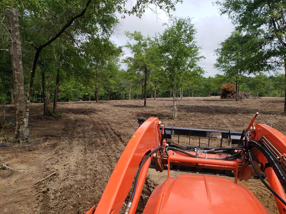

These compact tractor owners show how very capable they can be with the right tools...

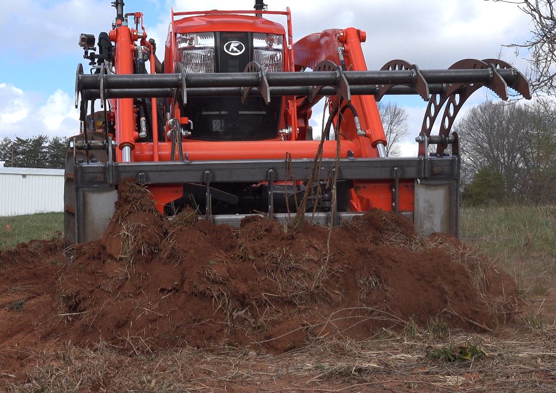

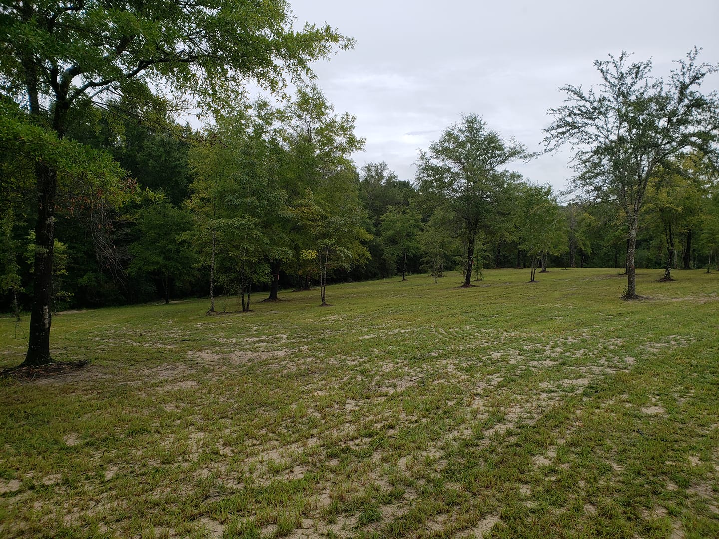

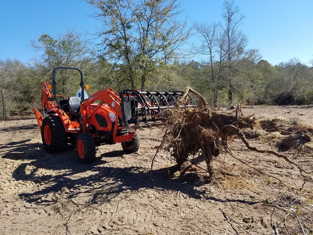

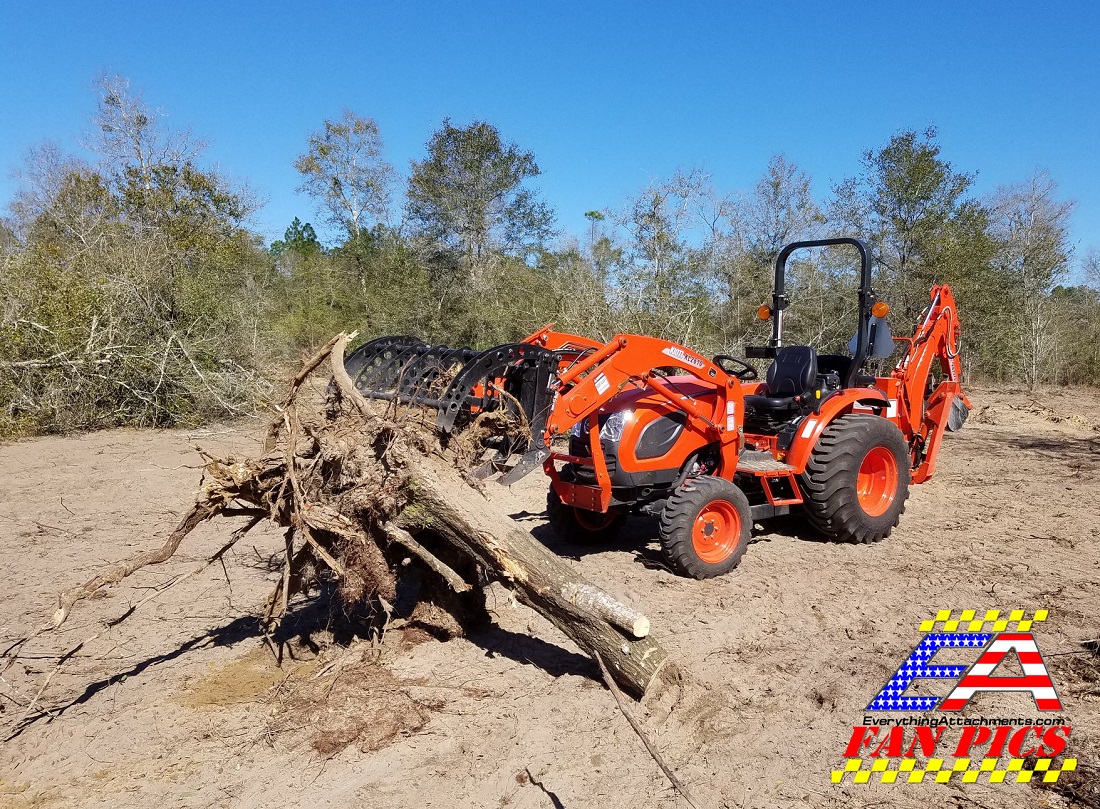

26hp Kioti
"175 hours with the Kioti CK2610HST and the Wicked 55 Root Grapple and 2.1 acres are clear root free and grass was planted! Couldn't have done it with out EA! Time to build my retirement home."

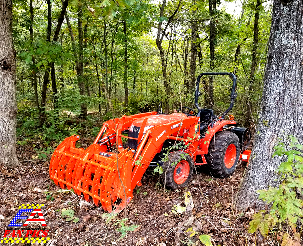

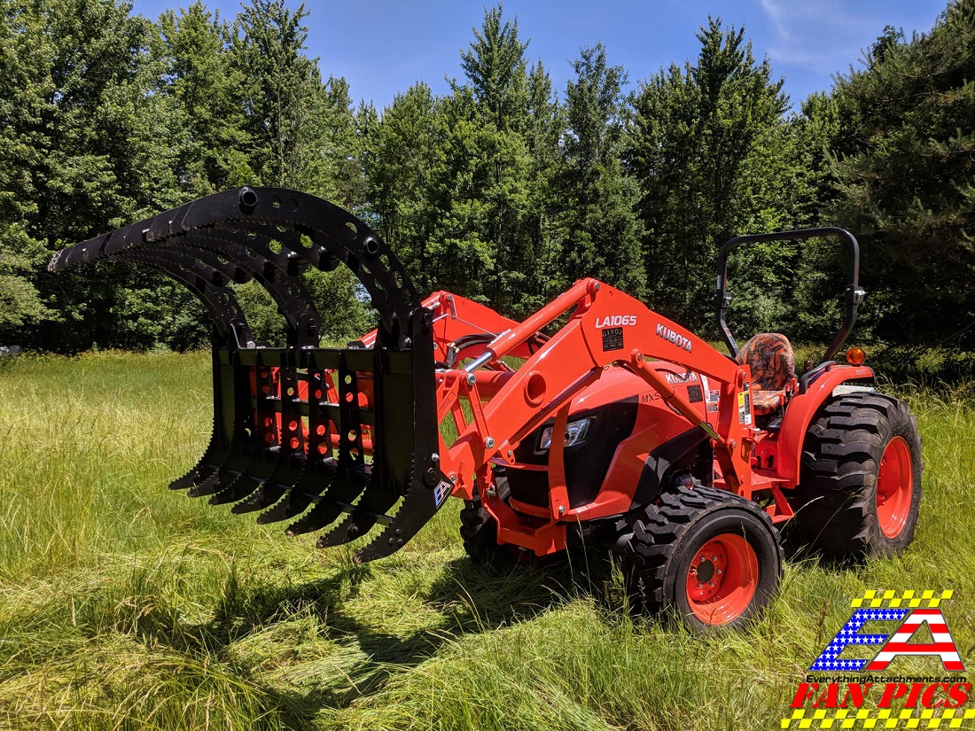

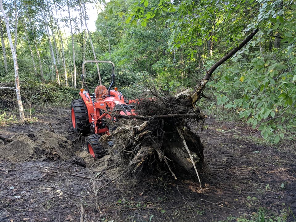

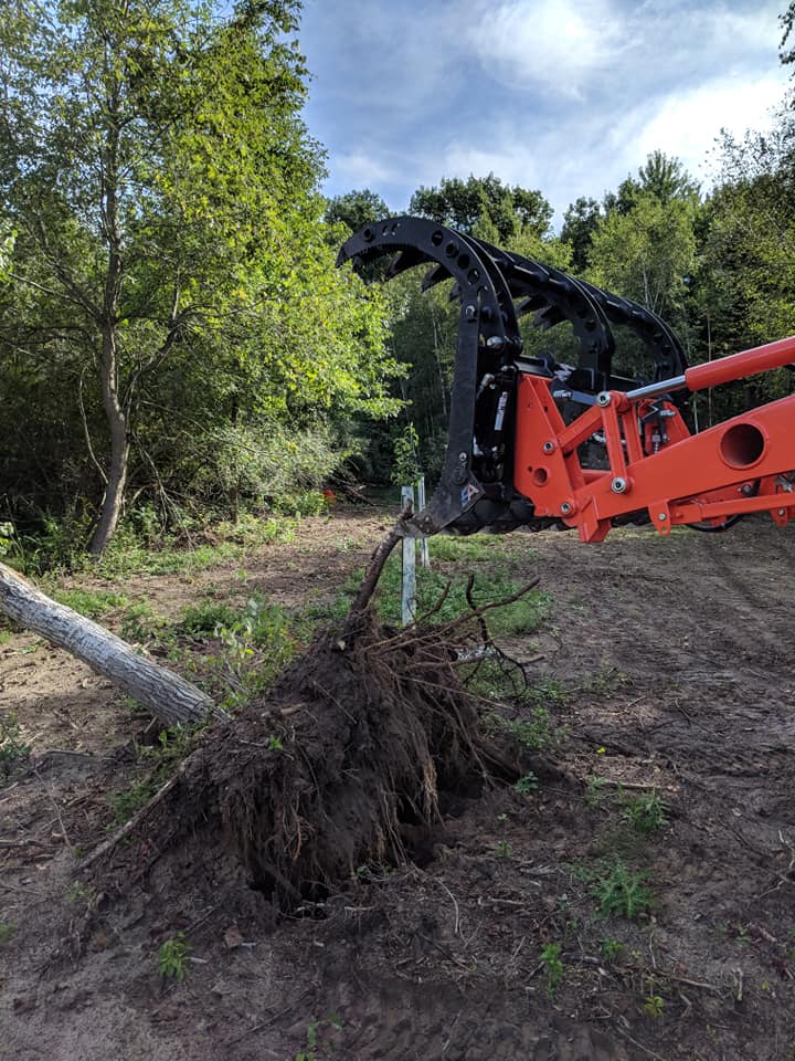

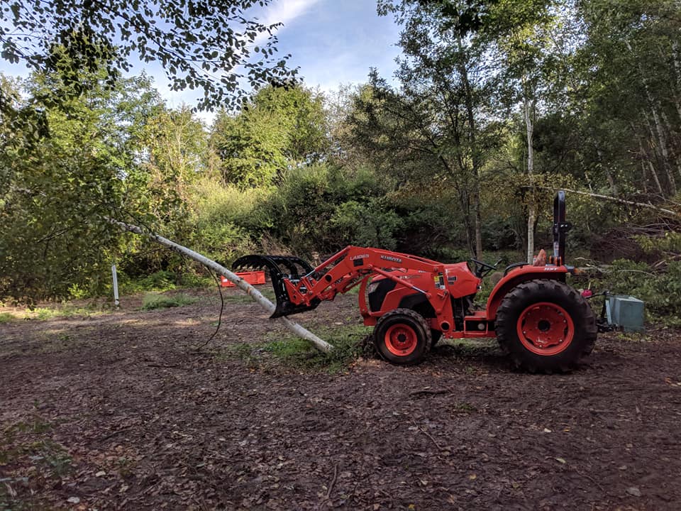

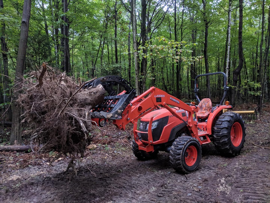

Compact MX Kubota with the Wicked 60

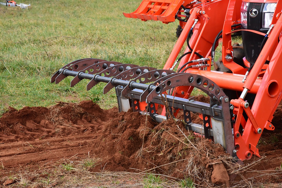

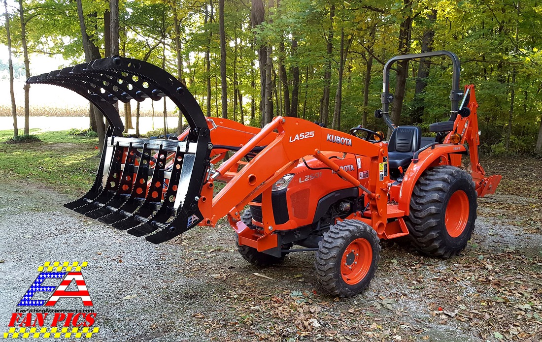

L6060 with the Wicked 60

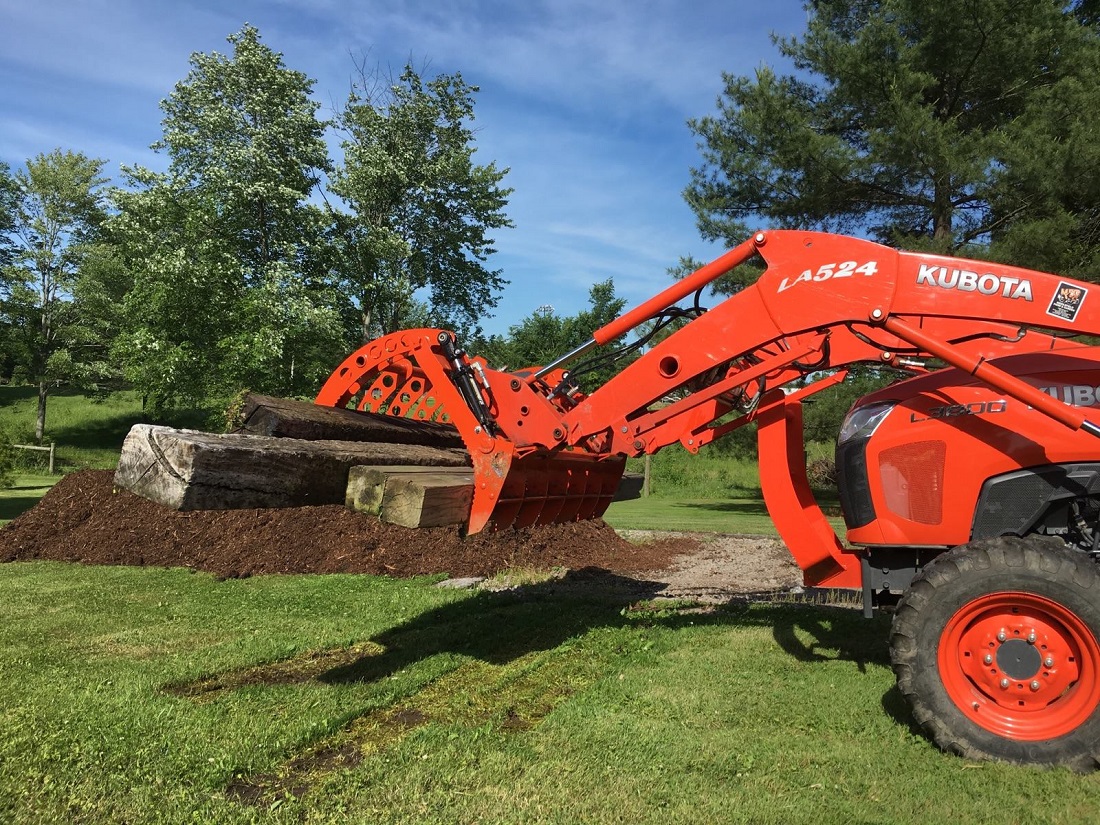

L6060 with the Wicked 55

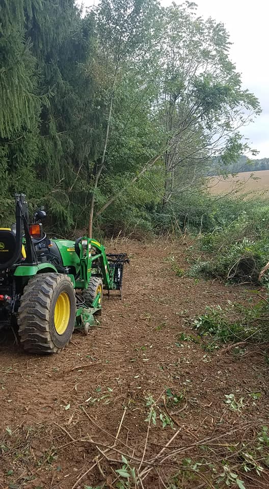

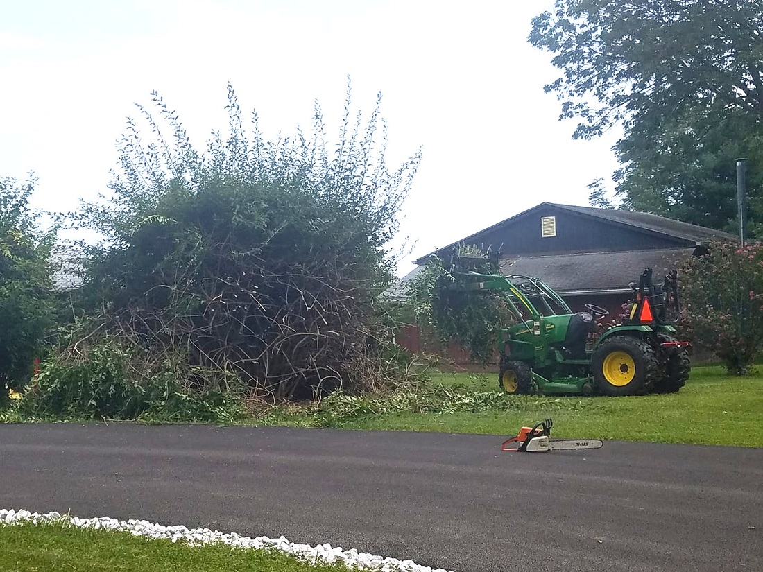

How about this John Deere 2720 with a Wicked 55. This is a small framed compact tractor.
From the EA Channel Group.
"The Wicked Grapple helps me exert my evil feelings towards 40 year old forsythia overgrowth. And forsythia in general. If Satan planted a bush it would be this crap."
