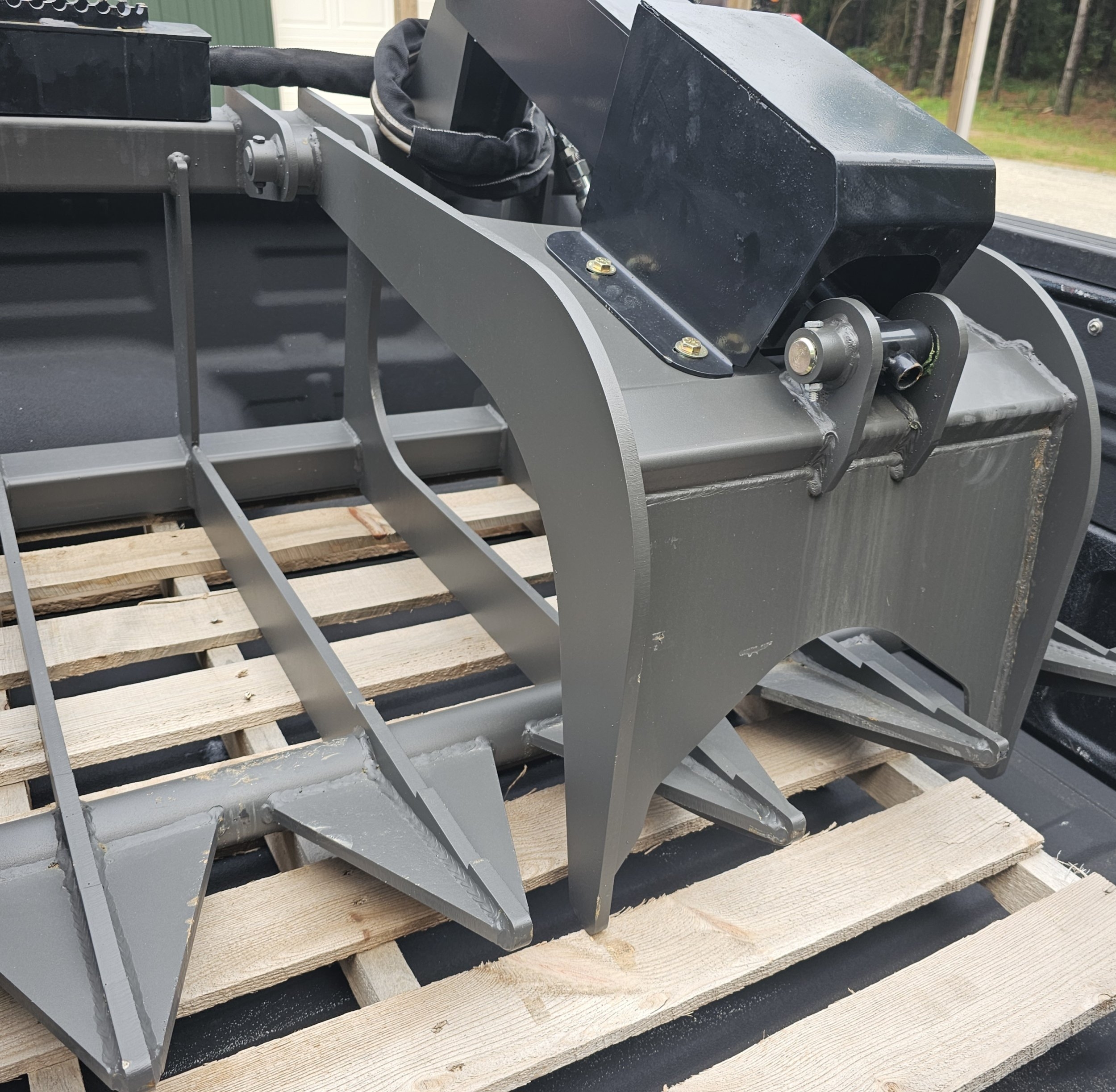

Just got this today...

You are going to pay good money for a grapple one way or another whatever the material is. I assume if the OP was looking at Wicked 55s then he has a 25-40 horse CUT. It's worth sorting out the options between all the companies that use the AR/hardox because it makes a massive difference when it weighs around 300lbs or less and can take whatever your loader can dish out without bending. You retain a whole lot of lifting capacity also. I wouldn't want a 500-600lb grapple on our CK Kioti (unless the ONLY use was having a super wide grapple to grab massive piles of light brush) It would work but it would just be annoyingly heavy for most jobs and picking up big logs or rocks would be out of the question.
I would absolutely find a similar brand that uses hardox or similar and weighs about 250lb to 350lb absolute max.
Looks like homestead has really stepped up their game. Good weight for the 55 60 and 66. AR 450 teeth. Not much to not like.

Just received my 55" Homestead Pinnacle series grapple last week. It's very well made.
