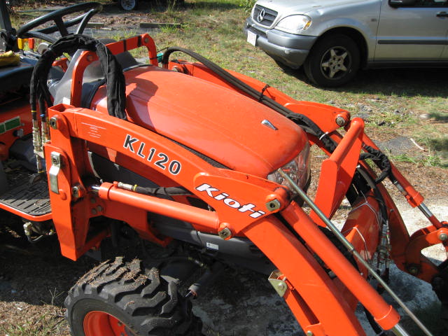

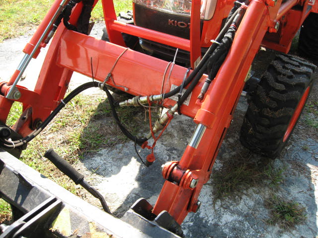

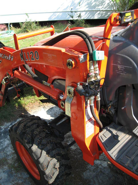

I hope you did a neater job than I did! :eek: I wanted to get grappling as soon as possible so I zip tied everything into place and went to work. One year later I can report that not a single zip tie has failed and the installation looks as amateurish as ever. I've moved tons and tons of brush and stumps but haven't yet gone back to make more permanent attachment points for the hoses and QCs etc. I must have a strong streak of "bailing wire" mechanic in me. Or maybe I'm just a slob. I won't ask Mrs. Island Tractor to vote on this question.
