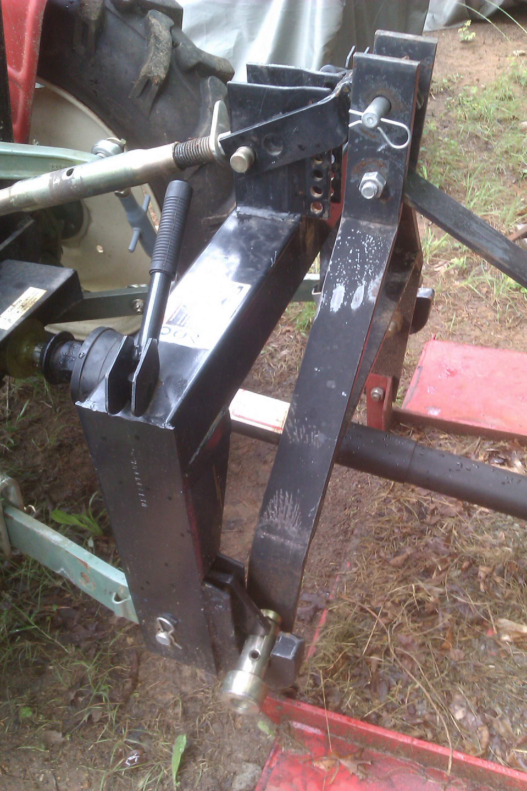

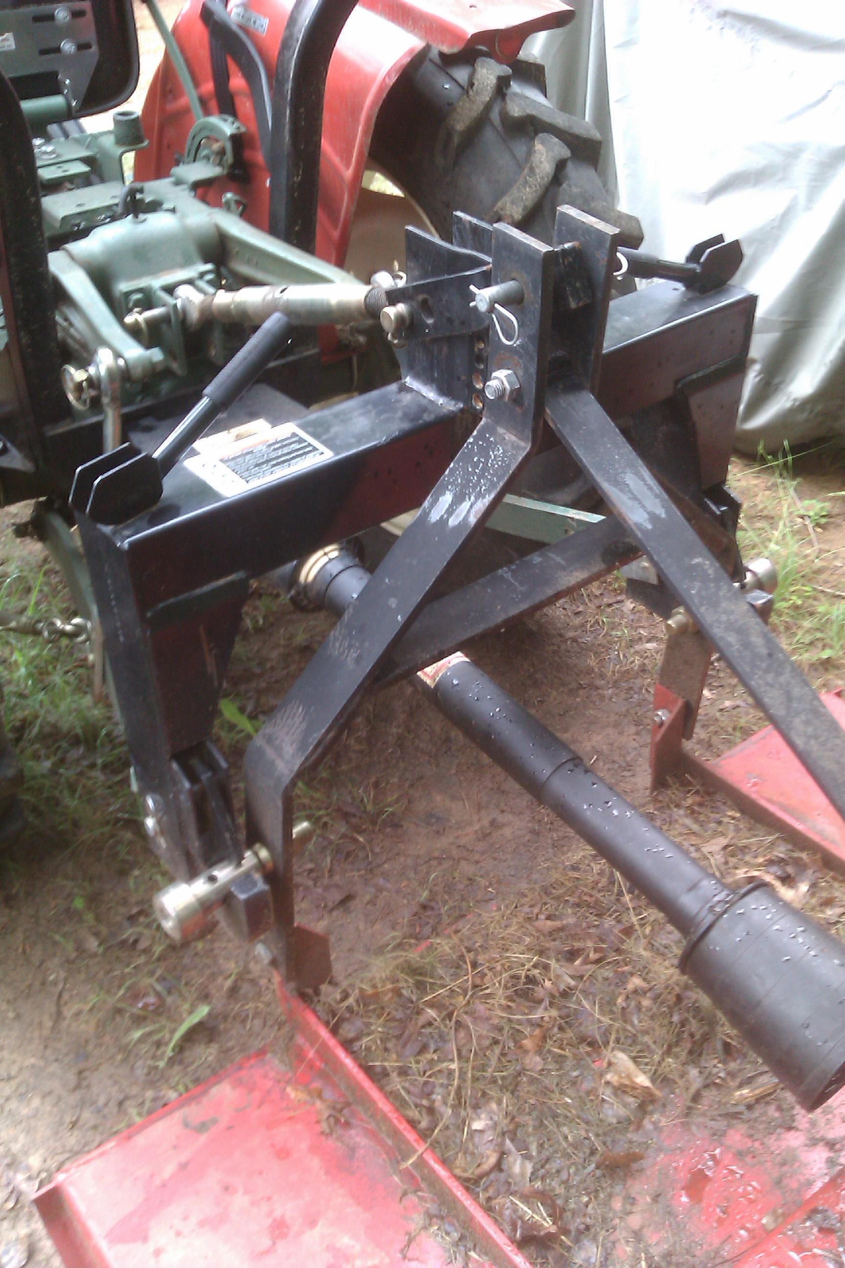

Got a request for images of how my Clipper 400 mates up to the HF quick hitch:

I bought the harbor freight quick hitch this weekend for $64 including tax! Had a $75 coupon, and the manager let me use a $20% off coupon with it. I then went to TSC and bought the cat 3 to cat 2 bushings, and put cat 2 to cat1 bushings inside that.
I hooked it up to my Countyline carry all, and found the top hook barely works if I let it only hook to the Cat 1 hitch pin. It is practially a wedge fit, so I really don't see a need to try to move the attachment holes only to then put bushings on it. Have not tried it with my blade yet.
Seems to work well the few times I tried it. sometimes I have to get off the tractor and stand on the 3 point arms to get them to go down and disengage.

So if I'm understanding things correctly, these Quick Hitches have hooks that are too large for standard Cat 1 pins and you have to put adapter bushings on the pins on the implement.
From reading other threads it seems that this is not unusual for Quick Hitches. My question is why aren't they sized properly to start with for Cat 1 implements if that is what they are designed for as the HF manual for theirs indicates?
   / Another Harbor Freight quick hitch success story #26
The industry standard for a Cat 1 quick hitch is to use bushings to Cat 3 on your pins. Don't know why.
