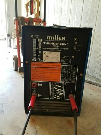

Gman, is this what you have?
Is the machine shown below AC only or AC/DC? What's a good price for it?

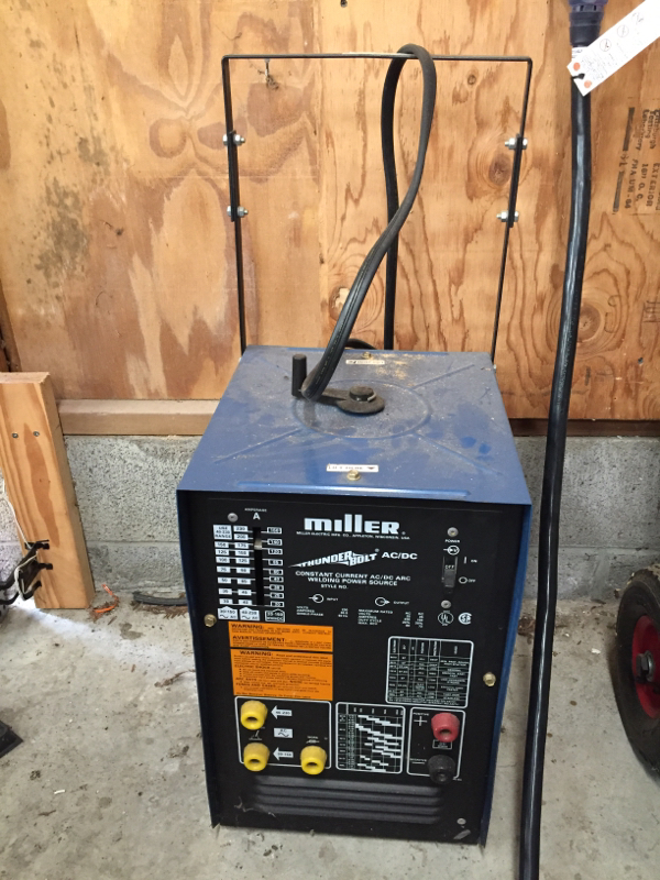

This is my 80's ac/do Thunderbolt.
Ok, comparing pics, I see yours said "Constant Current AC/DC welding blah blah blah"
The pic of the machine I posted says "Constant Current AC welding blah blah blah". Didn't notice that the first time.
Pass, especially for $300.

You got it....the one you posted was AC only. I actually have a second Thunderbolt AC/DC I picked up at an estate sale because it was cheap and have it listed on Craigslist now...looks like a new welder is going to look at in a few days.
The one thing I've been told to look for with this style welder is to crank the amp control all the way up and down and make sure it doesn't get really hard to move at any point...that's a sign it overheated at some point. In short, a consistent feel the whole way is what you're looking for.
This is the first one I bought....$200 with a set of leads, an extra 400amp electrode holder, a cart for it with wheels and 35lbs of Lincoln Excalibur 7018 1/8" rods. All of the recent pictures I've posted on my "Ugly Beads" thread have been of welds done with the Thunderbolt. If it can make a good bead with me learning overhead, it's got to be a decent welder!
