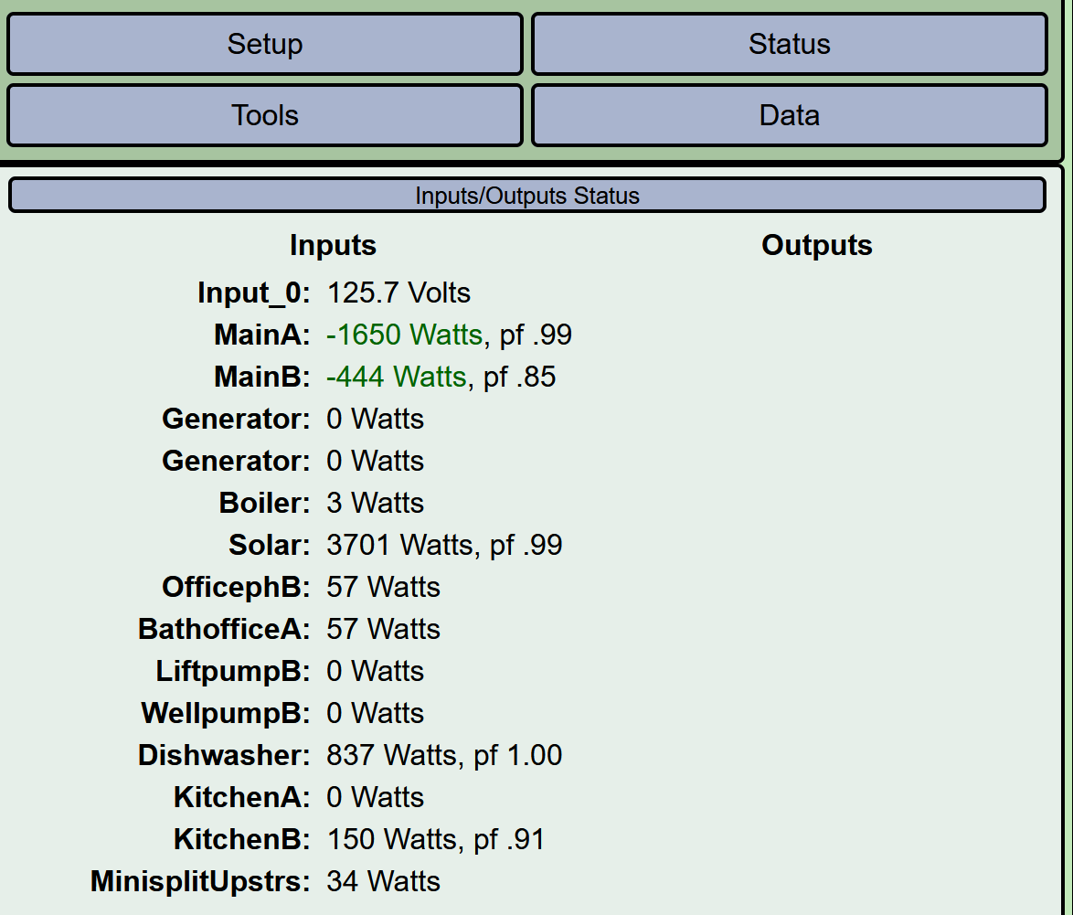

Here is a
Momentary snapshot of power generation and use.
7.5kh solar array that generates just short of 9 mega-watt-hours per year.

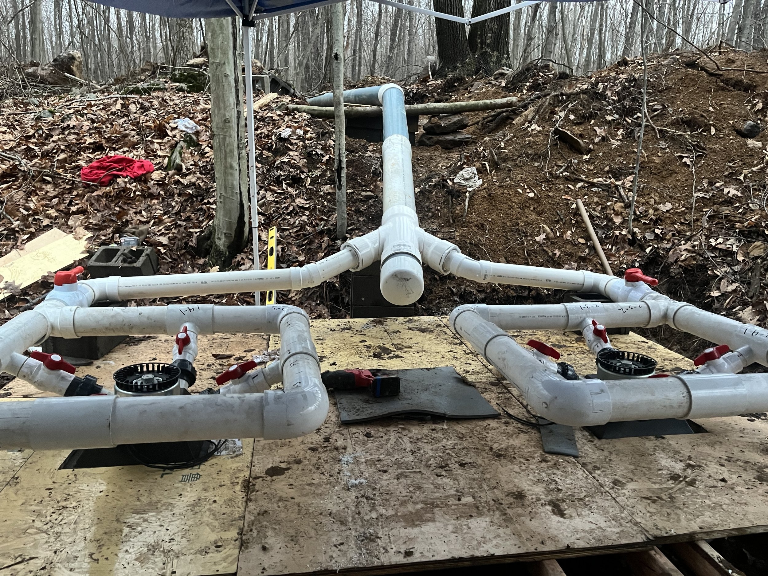

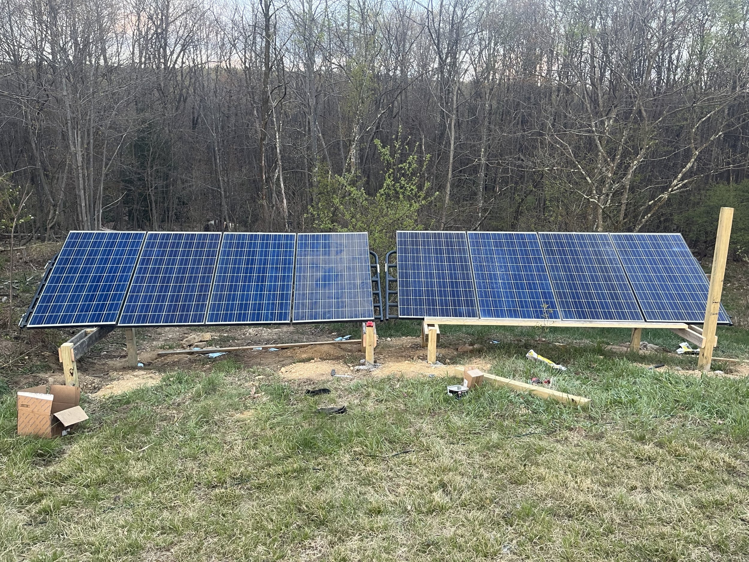

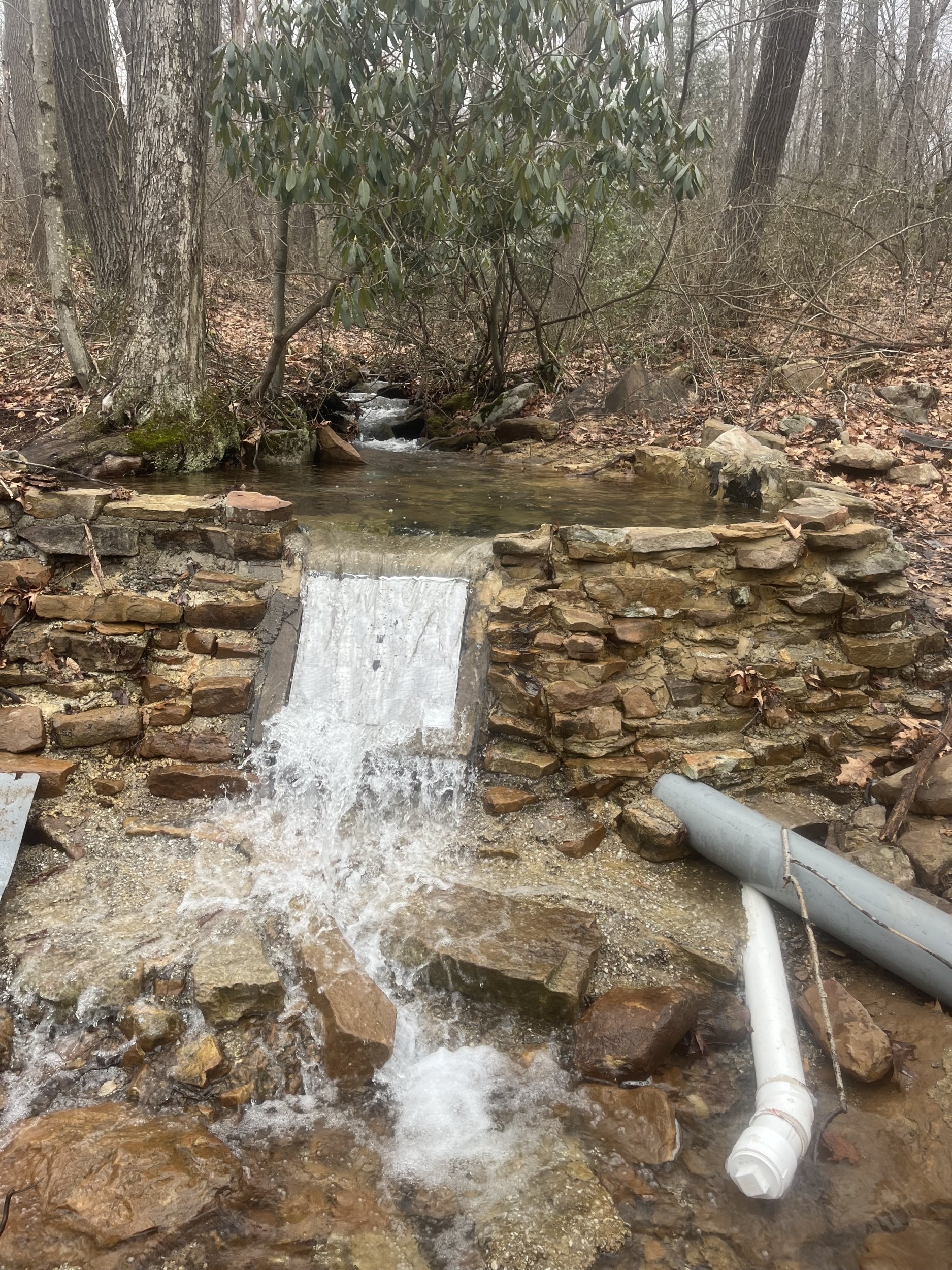

Sometimes solar isn’t the best option for some peoples situation but for my household it makes perfect sense. We live on top of a mountain and don’t use air conditioning at all. We don’t need it. We also get a ton of snow and we are the last on the power line. We lose power quite often. So, I installed 20 solar panels (5kw ) along with all the necessary equipment, inverter, batteries, charge controller etc. I just ordered 20 more panels to run wifeys hot tub and to make us completely grid free.
We also have a very nice creek on our property so I installed a micro hydro system that produces around 1.8kw continuous.
This system completely powers our not so efficient house even in the dead of winter. I installed a Mrcool 5 ton inverter heat pump and I also use a wood / coal stove in the basement.

Here is my weir I built and the coanda box to catch the water. Also two of my 5 solar arrays and the battery bank. For some reason Indont have a good pic of my inverter/ solar charger etc..

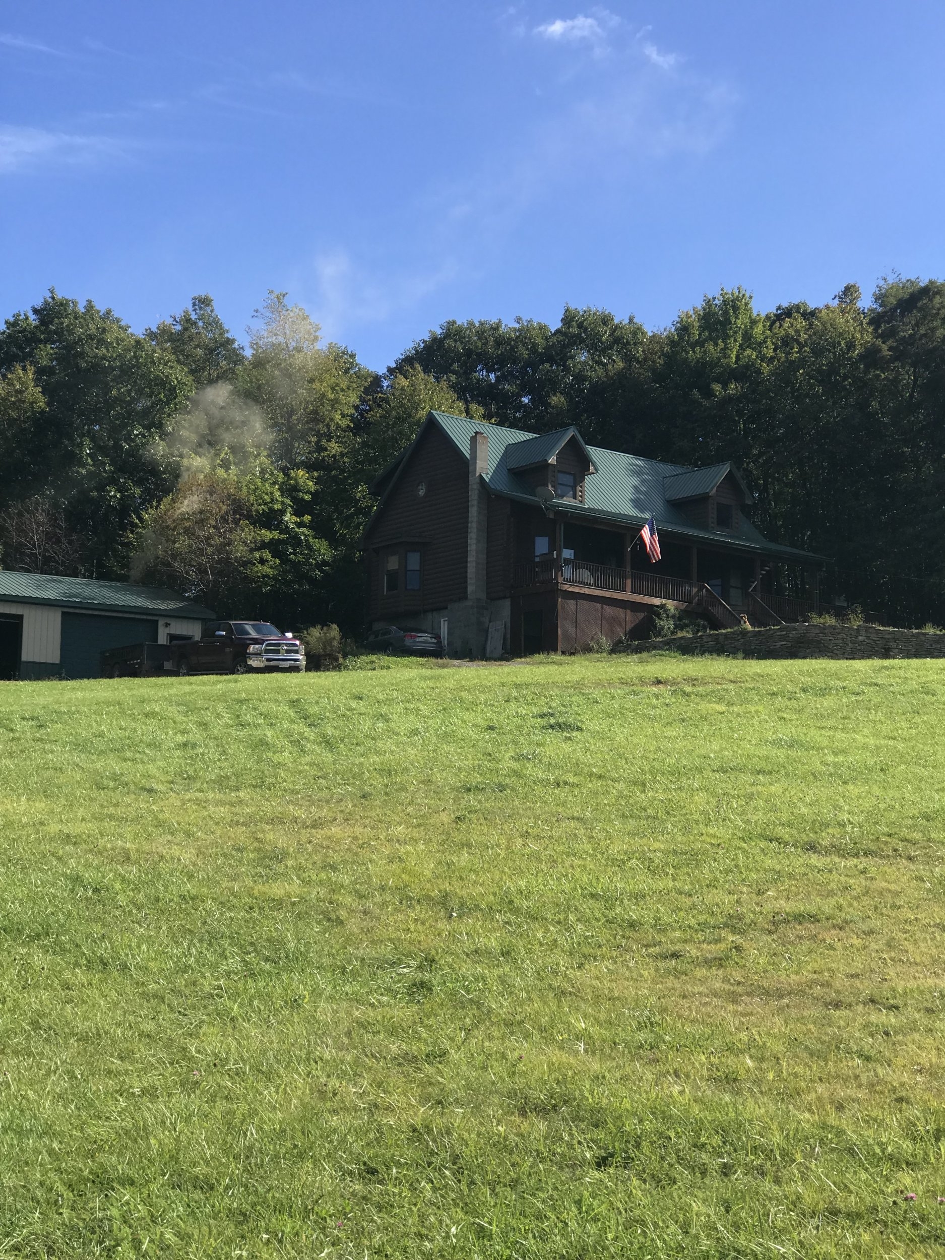

and a pic of the house which isn’t exactly frontier roughing it but it is out I. The country and secluded

funny seeing those. if you were to divert a natural stream out our way and put something like that, youd be fined and probably tossed in jail.
we had a good friend that simply tried to use some stream water to irrigate a small patch of field. was fined. how they determined this i have no clue.

I researched it throughly beforehand. It is a non navigable waterway that dries in the summer so no aquatic life and we actually own the water rights for years back to boot.
