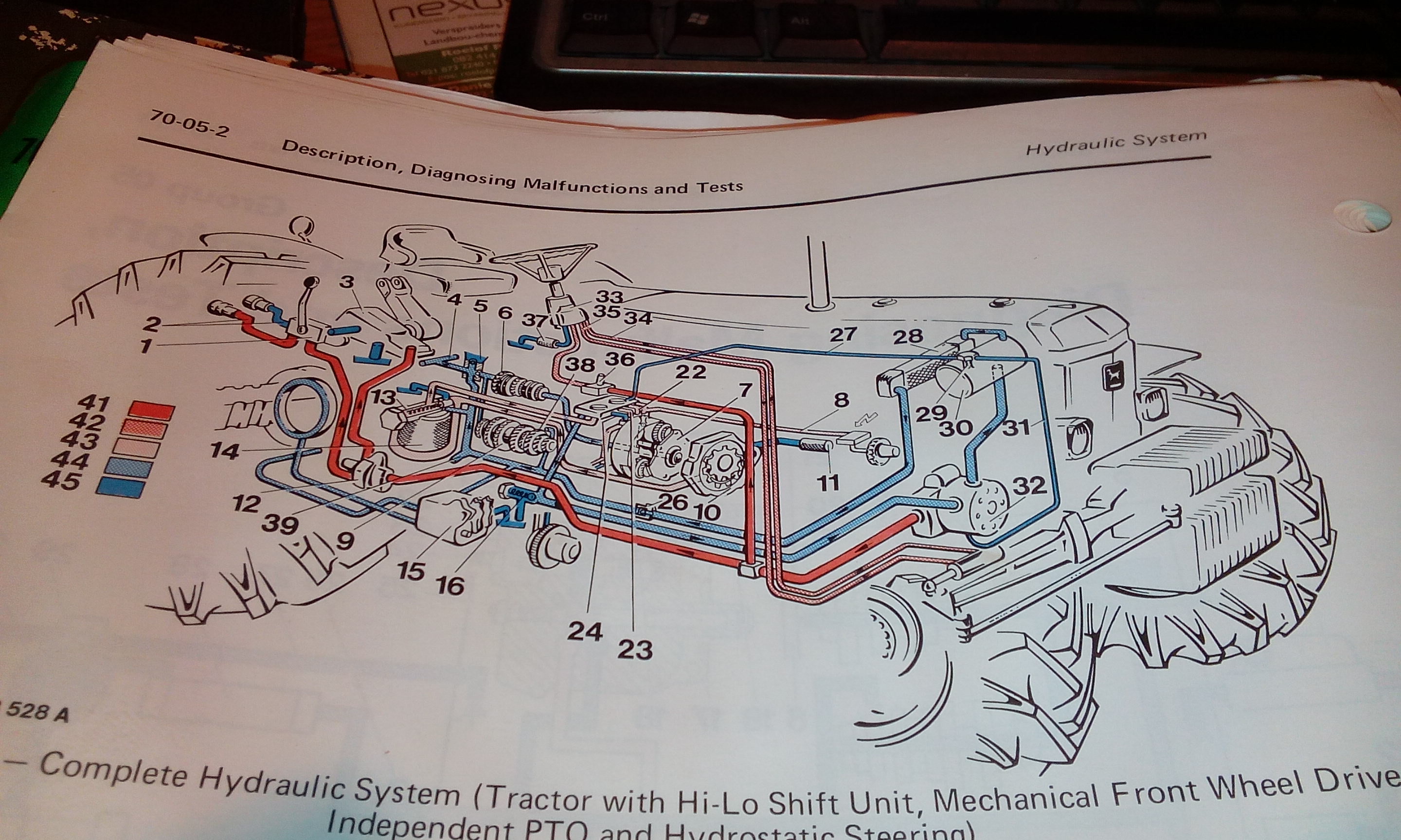

My questions are-Can I remove the pick up screen and just clean off or even replace the filter when needed?
Does anyone know the routing of the oil?

The sump screen is the only filter that protects the transmission pump. If you remove the screen, the transmission pump will not last very long I am afraid. The oil routing is sump screen to the transmission pump, then to the filter, then the oil goes to the shifter cover if you have hi-lo or independent pto. The pressure relief valve controls pressure for transmission functions and some is bled off for lubrication of transmission. Then oil that is left over goes to main pump up front. If pump up front is not demanding oil, it then fills the front reservoir and then through the cooler and back to the transmission case through the cooler relief valve.
