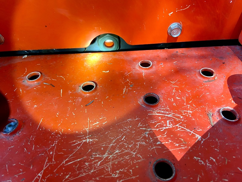

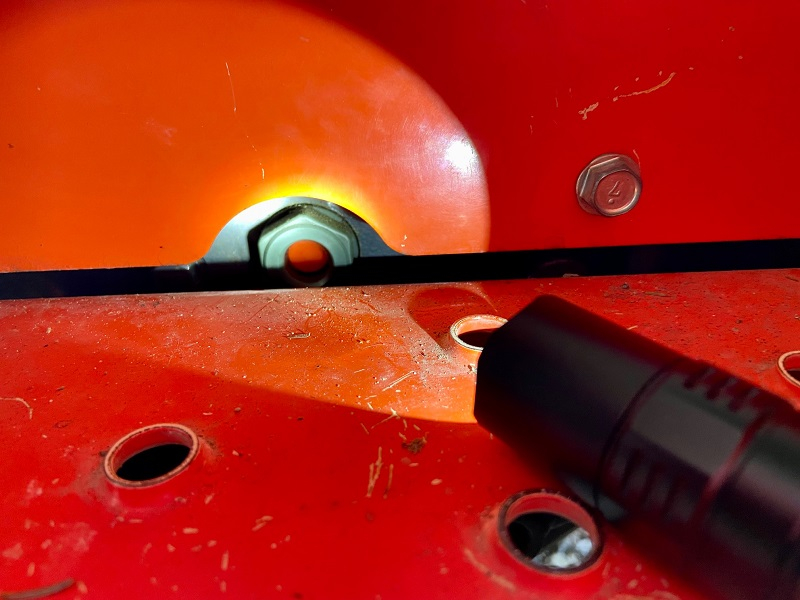

Ok, added the dye and went by the hardware store yesterday and picked up
one of those hand squeeze pumps like people use to pump kerosene. Stuck it
in the tractor and pumped out 3.5 gallons. Now when it's idling the sight window
looks like this:
and when the engine has stopped the sight window looks like this:
I also got a 3/16 wood dowel to use for a dipstick and notched it at the level of fluid with the engine
off and the sight window full. This what I'm going to go with.
Thanks everyone that commented. I appreciate it. At 73, I don't remember or get around as well as
I used too. A little advice now and then is welcome for sure.
Dano
