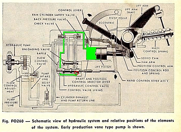

I hear what you are saying but the ballast box hooked on the back bounces at any height. 1" off the floor or at full height. When I changed the "O" Ring on the piston, the bore looked to be in fine shape. I did not check it with a bore gauge but it had no scoring at all.

With this new information, I would suspect the control valve isn't sealing properly. With your ballast on the lift and engine running, remove the hydraulic fill cap under the seat and look for a very small leak.
There are 4 valves in the lift system: Control Valve, Unloader Valve, Check Valve, and Back Pressure Valve. Its the unloader valve that seems to give the most problems. While you have the top off, pull it and replace the O-ring. Double check to ensure you have the correct O-ring and verify the valve moves freely in its bore. Don't use abrasives or wire wheels while cleaning up the valves or bores. Also make sure the control valve moves smoothly. I would leave the check and back pressure valves alone for now.
The green colored path in below photo must hold without leaking. Somewhere along that path yours isn't holding which is causing the lift to cycle. Based on your recent description, I would suspect the control valve.

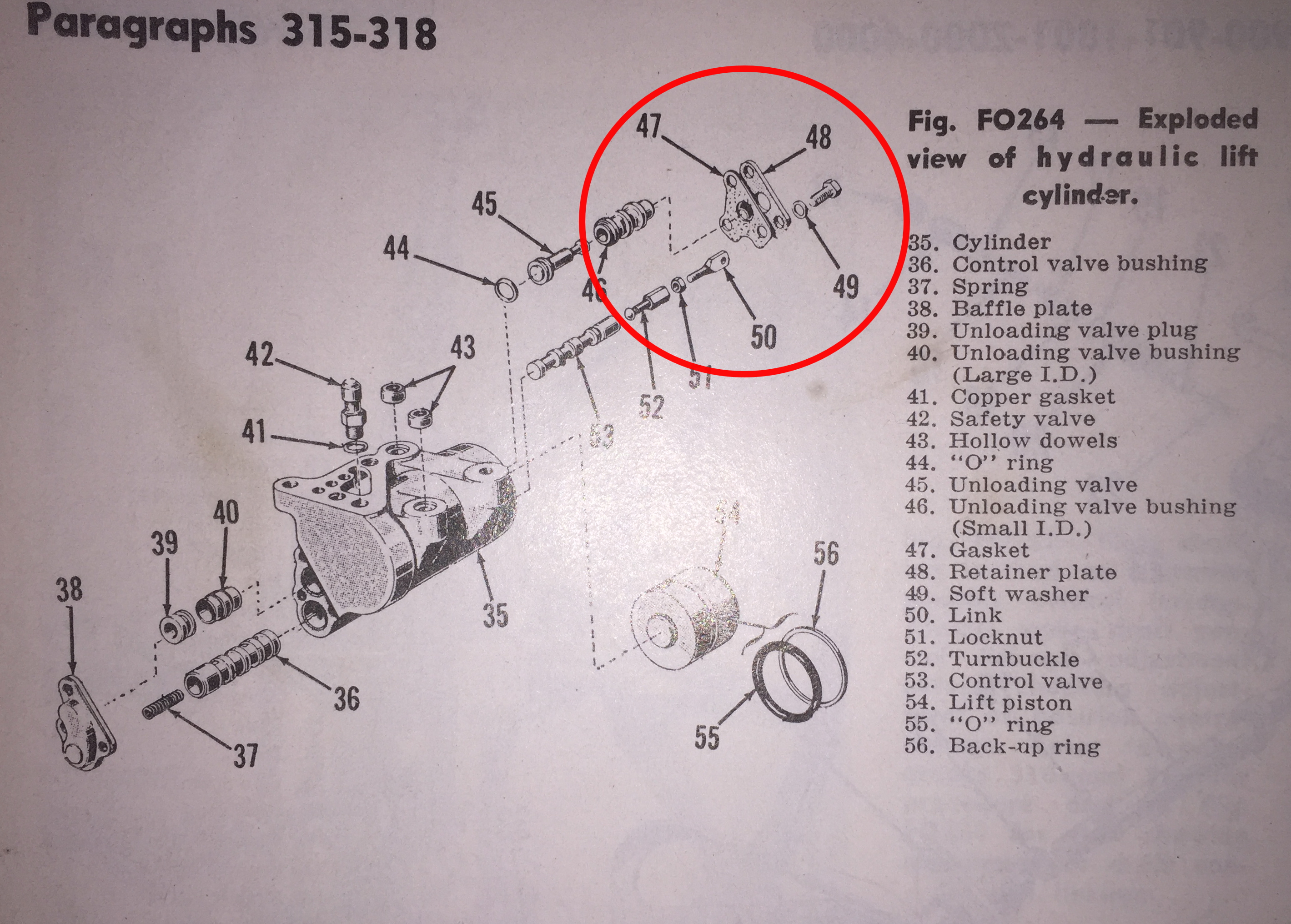

So, in reading this afternoon in the I&T Shop Manual, I made a discovery.
This is what the manual says regarding the retaining plate of the lift cylinder.
When reinstalling retainer plate(48), use new gasket (47), and BE SURE that sealing washer (49), is installed under cap screw located between control valve spool and cylinder bore. RENEW WASHER (49), if damaged in any way.
I have no idea what this sealing washer is about but I doubt I put it back on. I know I did not replace the gasket. The special sealing washer is no longer available so I will have to get something from a place like McMaster. Anyone have any ideas about this washer?
   / Another Lift Cover issue. #6
Thanks ALL.View attachment 544615
Maybe a copper washer will work
That would be my guess. I just hope someone can chime in and talk about the importance of this soft washer and a perfect gasket.

You can buy some gasket paper at the auto parts store and some copper brake caliper washers:)
I have gasket material and can purchase a sealing washer but I am in hopes that someone will chime in with some info re: this gasket and sealing washer. I am confused as to why only 1 out 3 cap screws have to be sealed.
Bob W
I think all 3 but it only shows one in the photo
