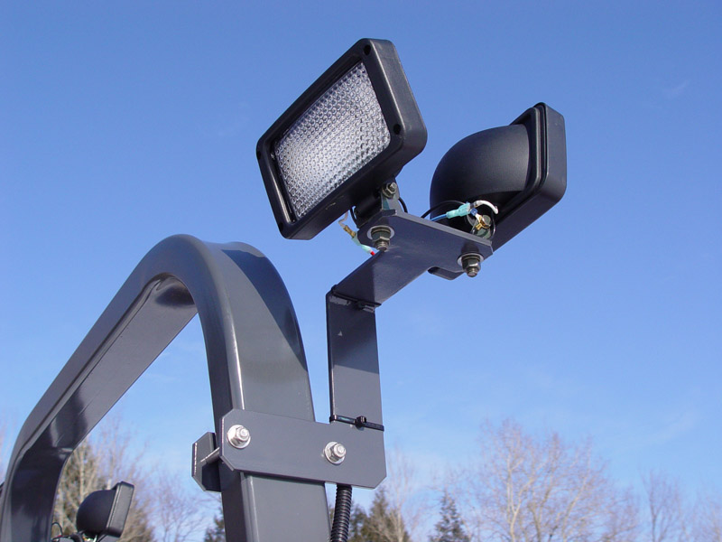

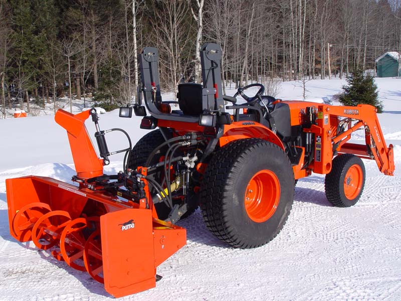

Ok guys, here's my home made light brackets.
It fits even if the ROPS is up or down.
  • Photo #1 and #2 show the general look of the thing.
  • #3 shows a close up of the bracket
  • #4 ROPS down

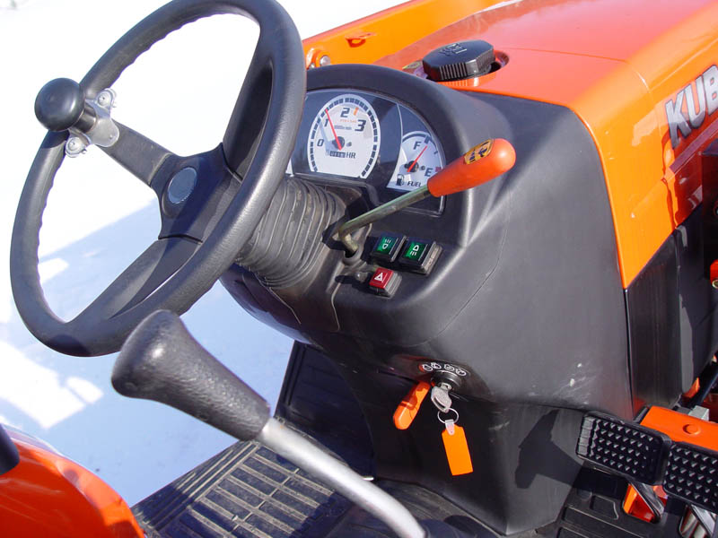

  • #6 dashboard
  • #7 dashboard close up

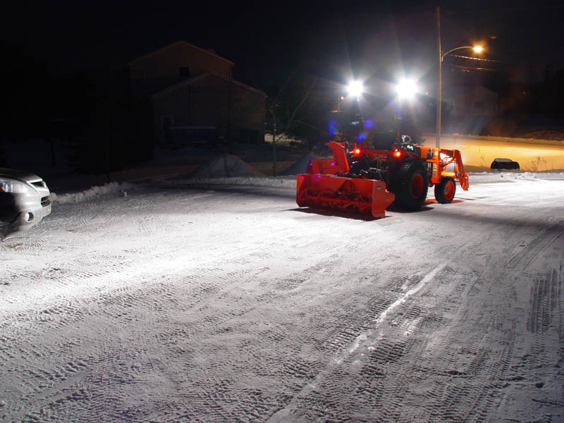

  • #8 dashboard at night

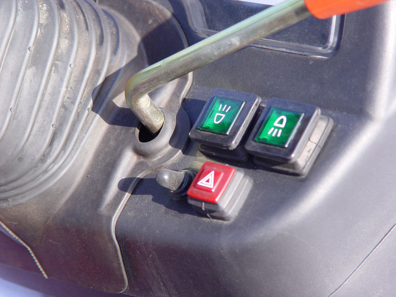

  • #9 dashboard unused blue indicator now plugged with my front light switch

55W halogen work lamp, flood light pattern: I must say that the illuminated zone is better than what I'd expected. The dash switches are genuine Kubota parts. I first saw those switches on a L48 working light kit (option). The switch is very well made and it called me daddy. So on my dash they are. ;) Here's the part number: 36919-54222. A bit pricy for a switch but I tell you this, it worths every penny.
Farmerford
Paint matches really well. Is it Kubota?
Yes the paint is Kubota Dark Gray 70000-00210 (acrylic enamel). 2 layers of primer and 3 layers of gray paint. Once the enamel has hardened it's ok but it cannot be compared to a powder coated paint or even an epoxy one. For light brackets it does a good job.

Are the light switches stock and if not, where did you get them.
I've bought the switches directly at my Kubota dealer. Usually that switch is mounted on Kubota excavators or TLB like a L48 and maybe a L39.
Each pairs of light are protected by a 15 amps fuse mounted on a panel inside the engine compartment. They cannot be turned on if the tractor isn't running (to prevent draining the battery). The switches are illuminated only when the head light switch is activated. Actually it was pretty funny to rig the wire harness beneath the dashboard to make it works that way.
The lights are just a bit lower than the top of the ROPS so where the ROPS can go the lights can too. And the width of the lights are a bit less than the tires' width so where the rear wheels can pass through the lights can go too. The brackets are solid enough to resist small branches but we're talking about lights so caution is always required when passing nearby trees. I'm aware that I have a tractor not a tank.
   / Another lights project for my B3030
#9
I forgot to say that the brackets are made only with mild steel 2" wide by 1/4" thick. It cost nearly nothing to make. All the bolts, washers and locknuts are stainless steel. And euhhh... the wire gauge is 14.
I'll use the lights mainly for blowing snow but I'll use them too when digging with the backhoe. Sometimes when digging a hole or a trench it's hard to see the bottom in the half-light. Now I'll be able to use the rear lights. For God sake as I think about it I could even mow my yard at midnight. :D Hmmm... I don't think that's a good idea after all.
Oh, back to serious matter. I'm quite happy with the 40 amps alternator. The 14 amps dynamo that I had on my BX23 was a bit annoying because at idle rpm the 55W light mounted on the rops wasn't very bright. At rated rpm the brightness was good though. With an alternator it's totally different. Idle or rated rpm, it makes no difference at all, the brightness is always good.
