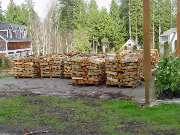

Whoaa..... That's a stack of wood. /forums/images/graemlins/shocked.gif However, you have one difference. I see 3 young bucks working the splitter and stacking. That's cheatin' /forums/images/graemlins/grin.gif...
The reason I now have a tractor and log splitter is because my son moved out 2 years ago to college. Like I have told him, it has cost me a fortune to replace him. Not only that, but I get to pay college tuition as well..... Gonna be a lean Christmas this year.... /forums/images/graemlins/frown.gif
Anyway, the attached picture doesn't come close to yours, but if we're comparing quantities, this is what my last project looked like in the staging area.

GregJ:
Can you approximate the amount on each pallet?
Is it a 4 ft by 4 ft pallet stacked 4 ft high?
That would be one half of a cord, if those were the dimensions, right?
But based on your weight estimates, it would be about a third of a cord.
Just wondering. I like your method. Id like to use it, too.
I heat our home with exclusively with wood, too.
I think some of those heavy duty tph pallet movers are rated at 2000" arent they?
Thanks, dwight

Dwight,
The pallets are 42x48 and I do stack them around 48" high. The species of wood make a difference, as well as the moisture content when it comes to weight. I have mostly alder, which is a hardwood, but a little lighter than most. I have stacked a few pallets that my B7500 just couldn't lift. When I stack the pallets, I want them to be as heavy as the tractor can just barely move, because I know that the next time it will probably be 30% lighter. I have found 2 solutions to a board that is too heavy for the tractor to lift. First I try lifting the front wheels off the ground using the FEL with the 3ph in the float (or down position). Then I raise the 3ph as far as it will go. Then I raise the FEL and as the front end of the tractor goes down, it will usually raise the pallet a couple inches off the ground. This is usually enough so I can transport it to the drying shed. If I just can't get it off the ground, I just take off one layer of logs and that has always lightened it enough to move. Even with one layer off, it's a lot of pieces of firewood that I won't have to touch again until I burn 'em. /forums/images/graemlins/smile.gif
