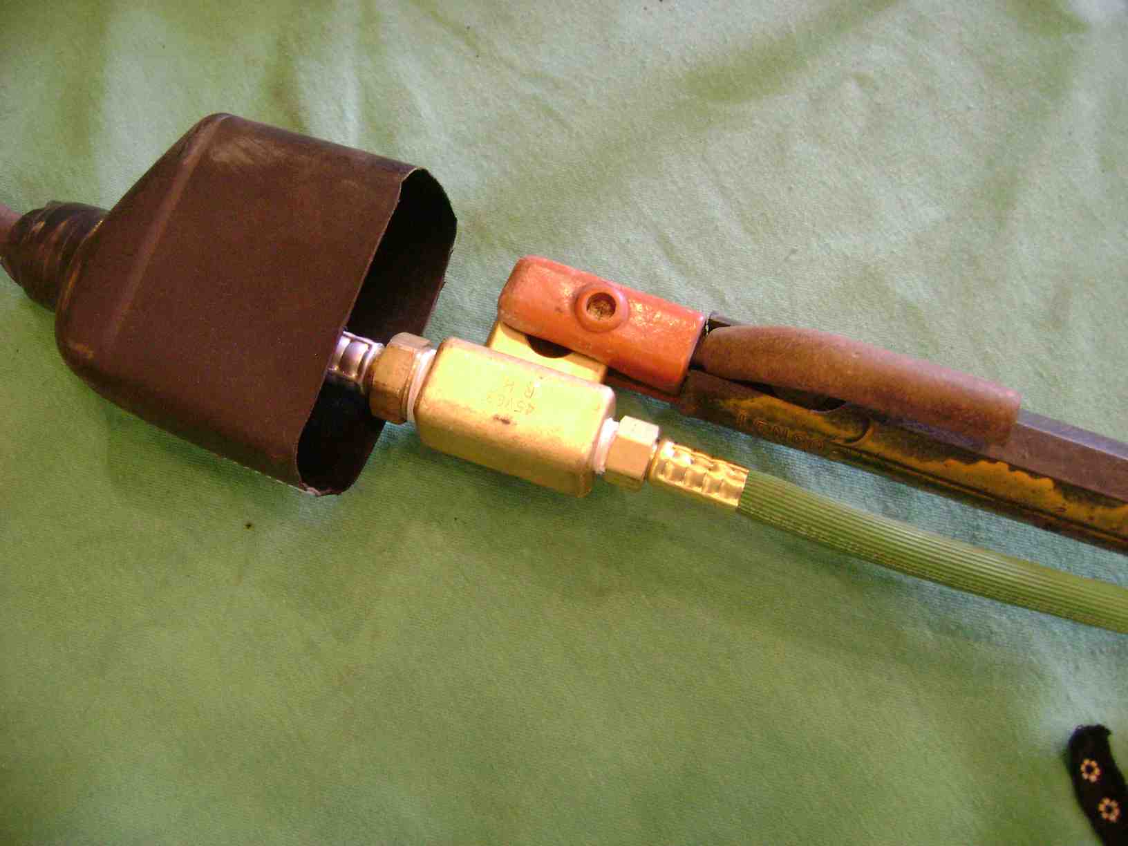

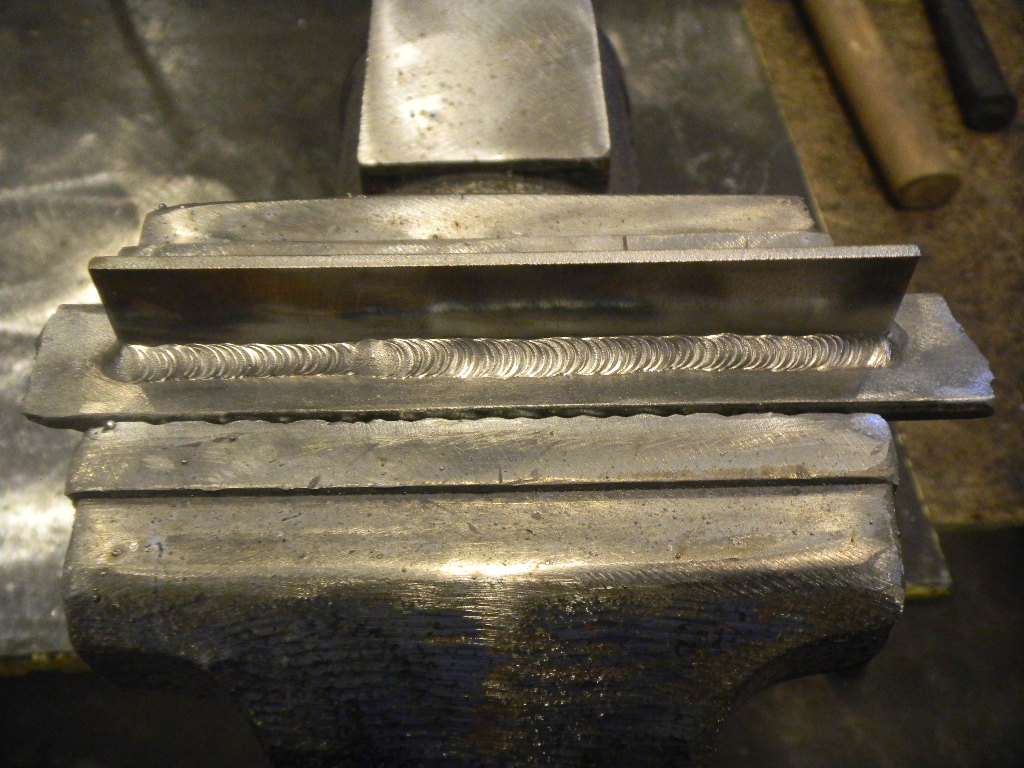

If you think you can live without the aluminum option, you can poor boy Tig welding with any CC machine. You won't have a foot pedal, but xray welds are made everyday with scratch start Tig rigs. Here is a Tig weld I made with my Tig rig, and my Everlast PowerArc 200 stick welder.
Remember now I'm not much of a Tig weldor.:eek:
