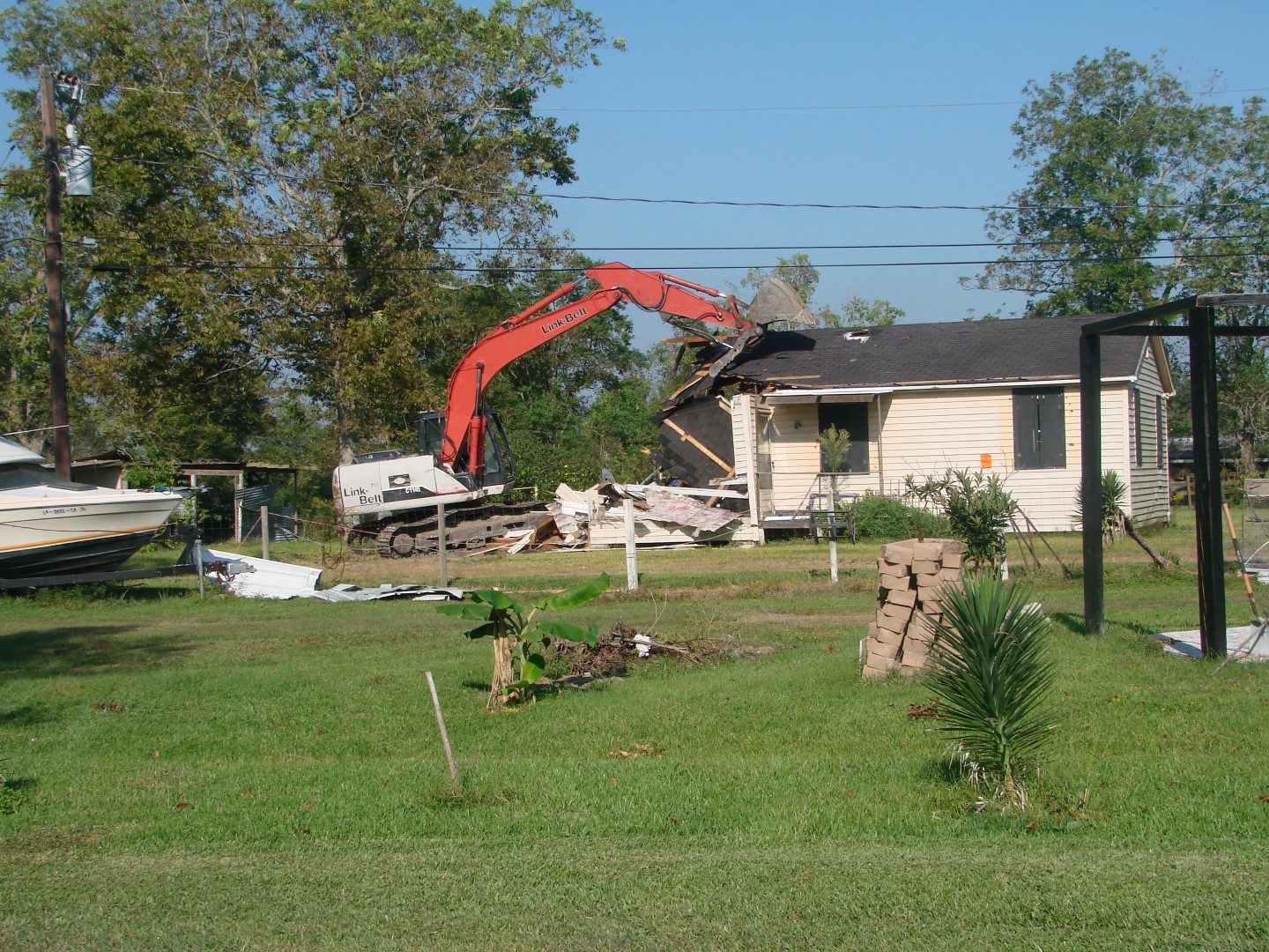

My neighbor had a contractor install his metal roof using 1X4s and the next hurricane 2 years later blew the metal off one side of his roof breaking all the 1X4s that were holding it down or pulling out the short screws that went through the 1X4s. My roof was not damaged at all as the 2X4s were strong enough to not break and the longer screws did not pull out. Attached is a photo of his home after the hurricane.
