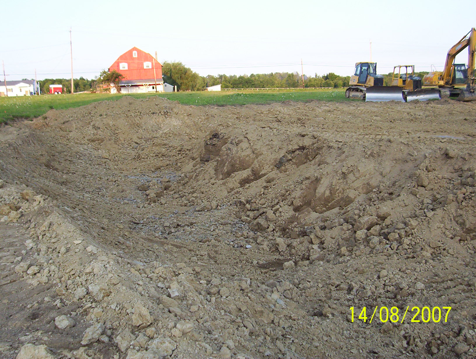

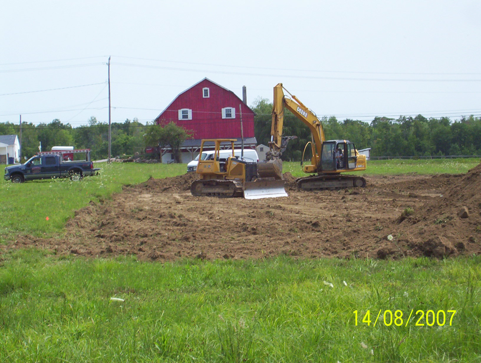

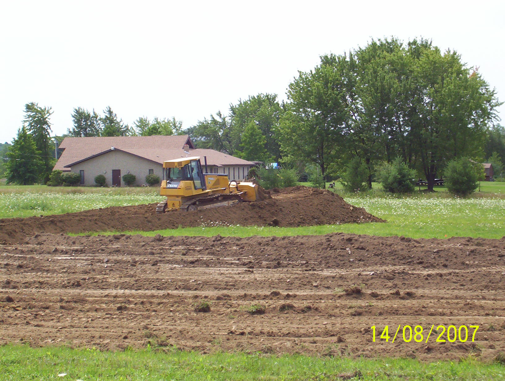

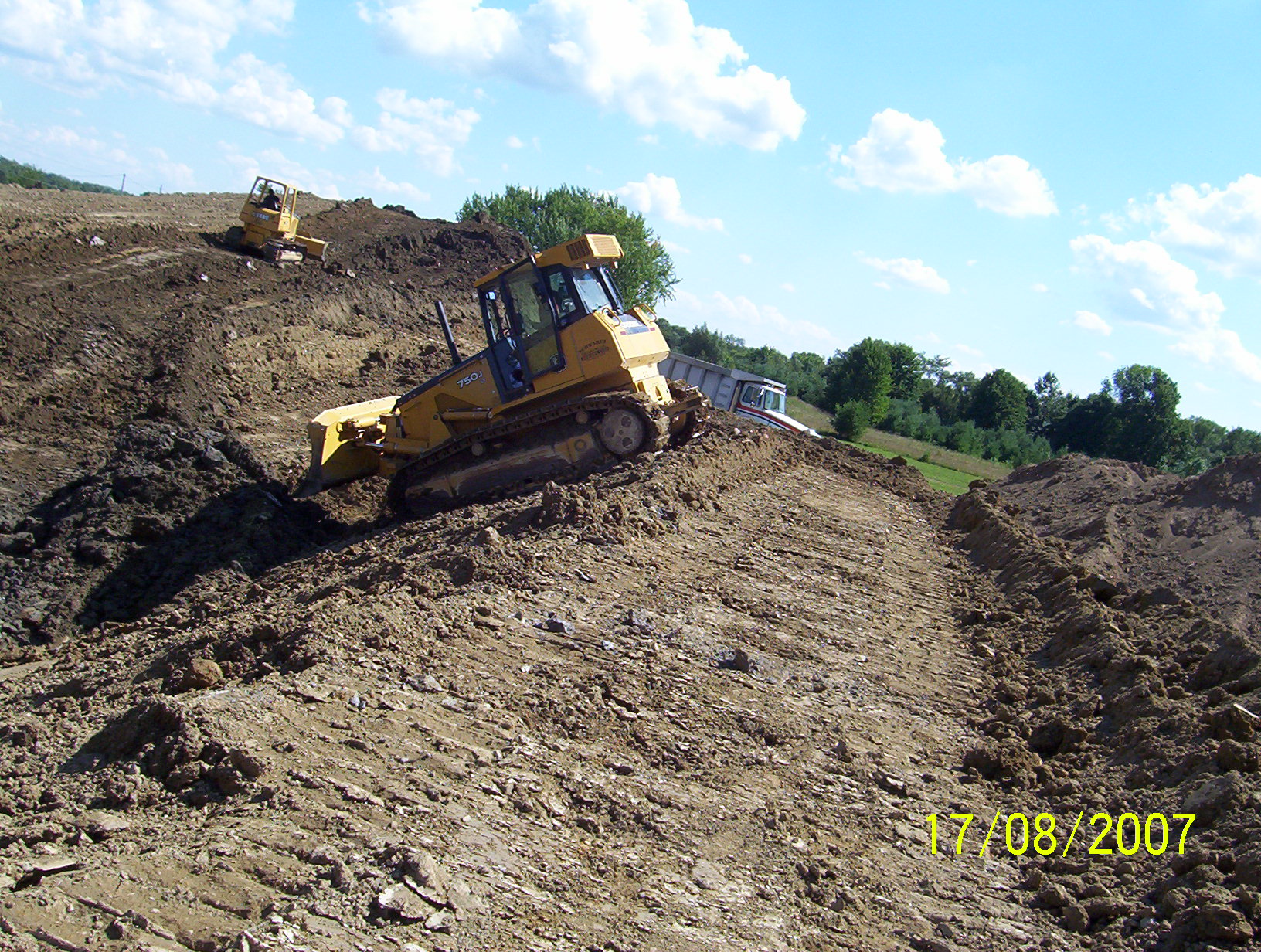

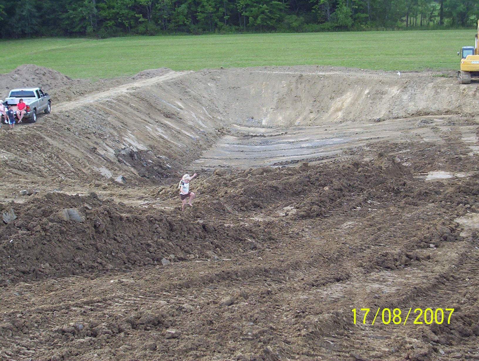

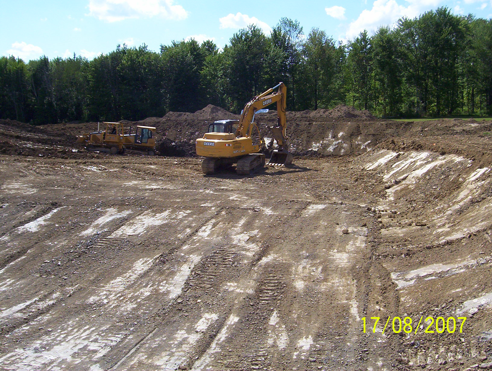

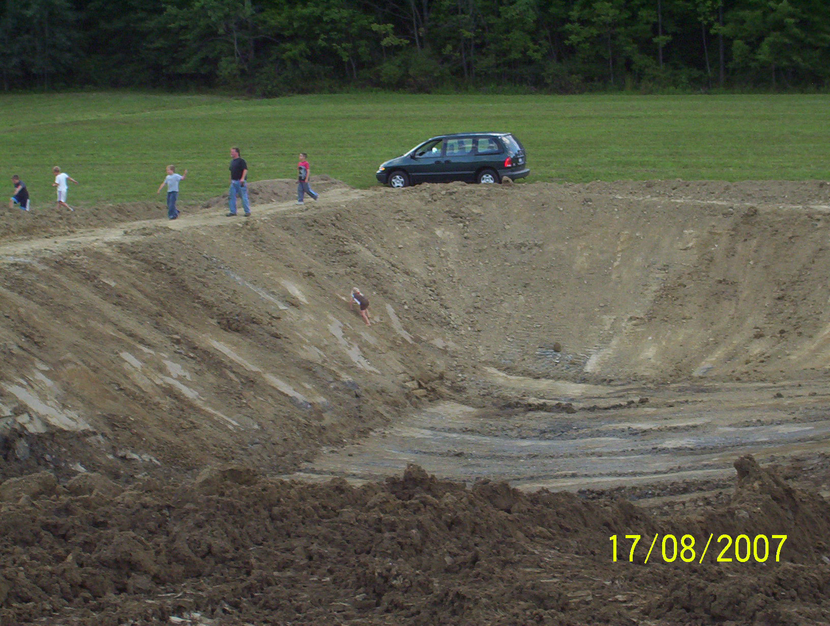

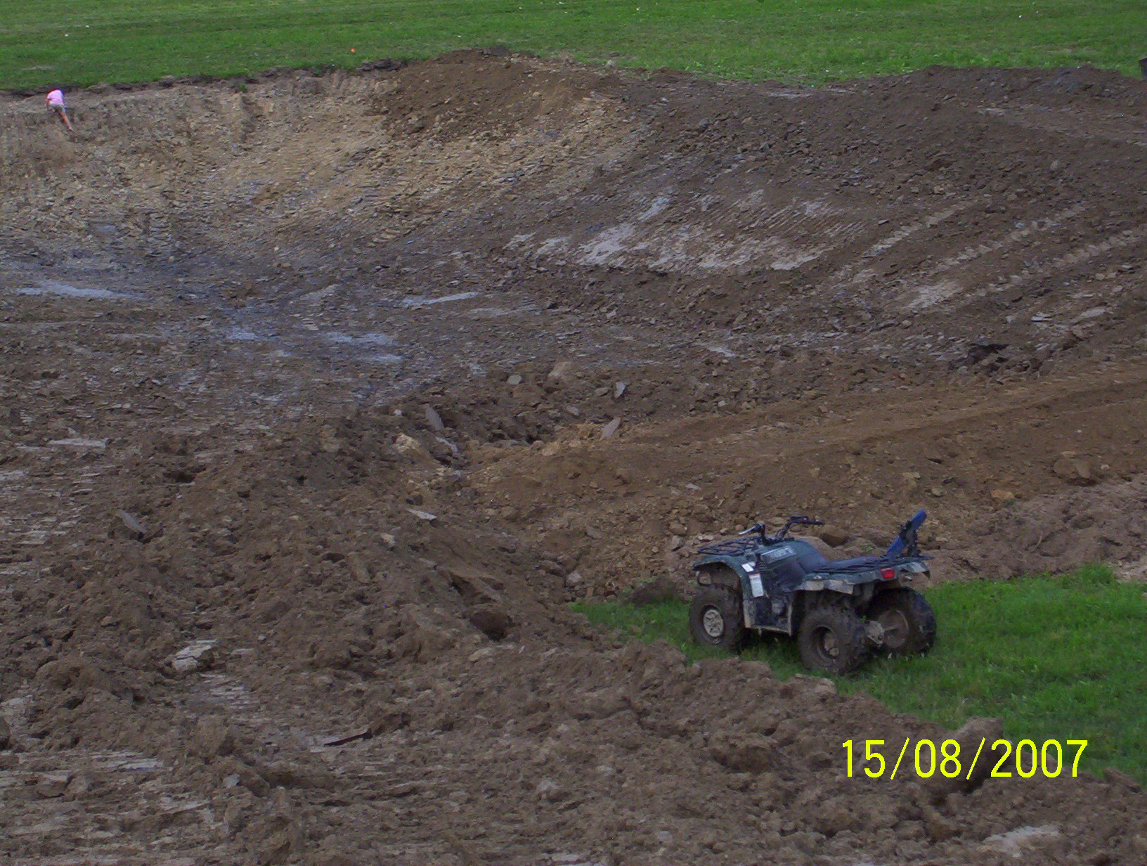

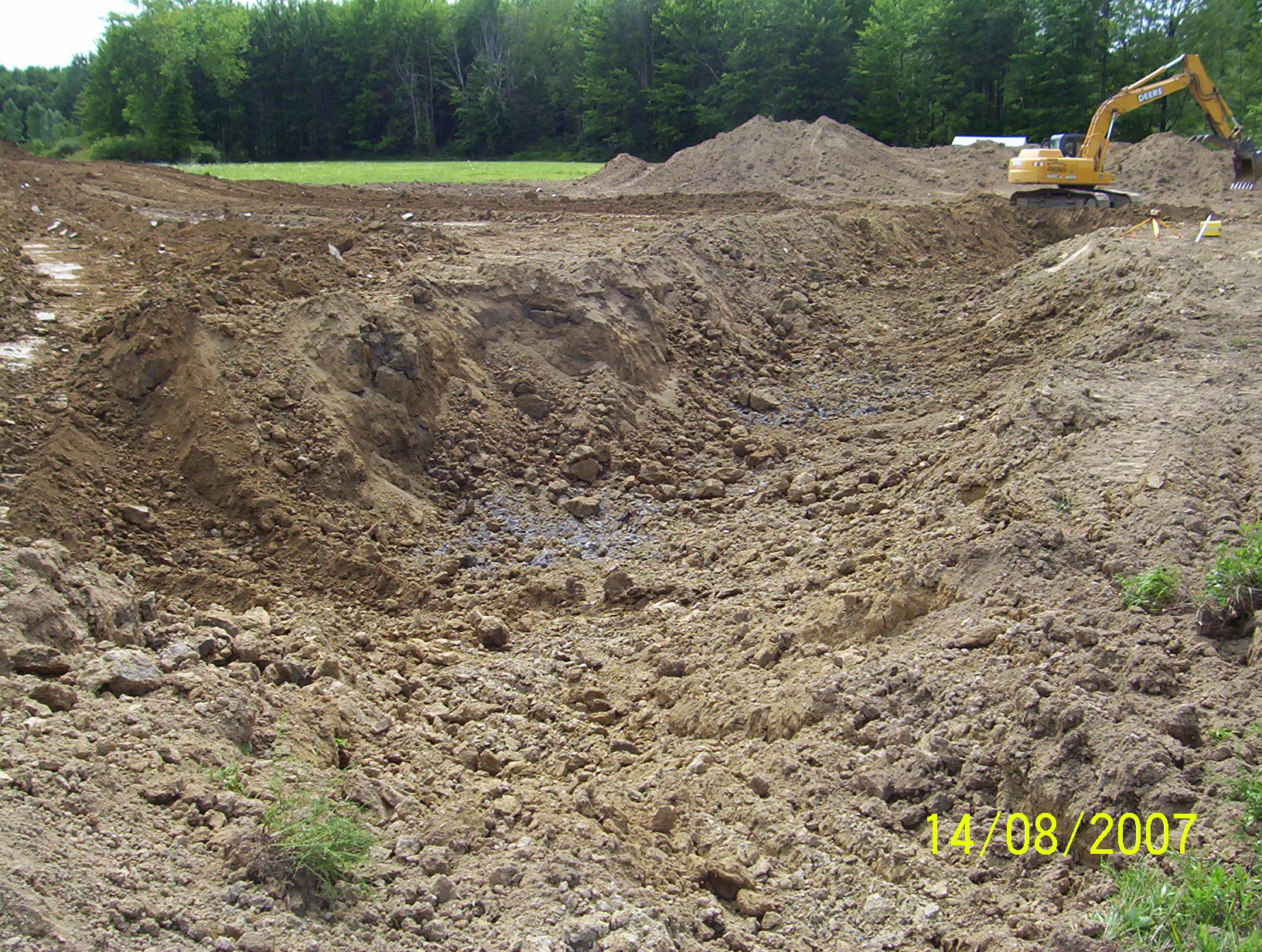

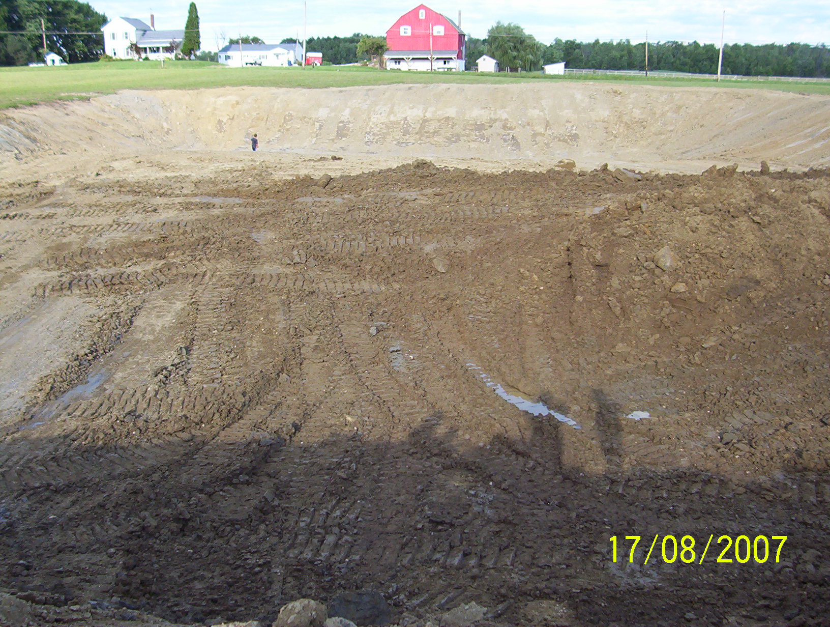

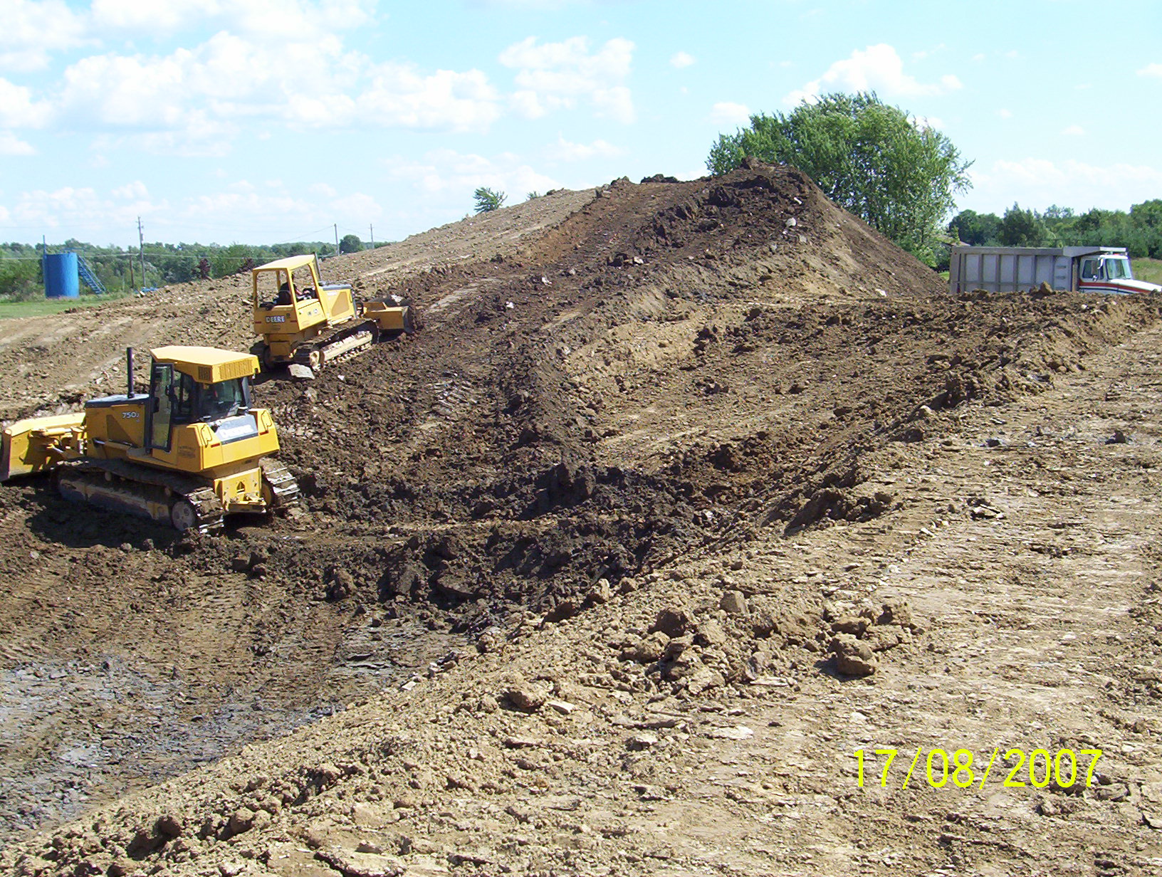

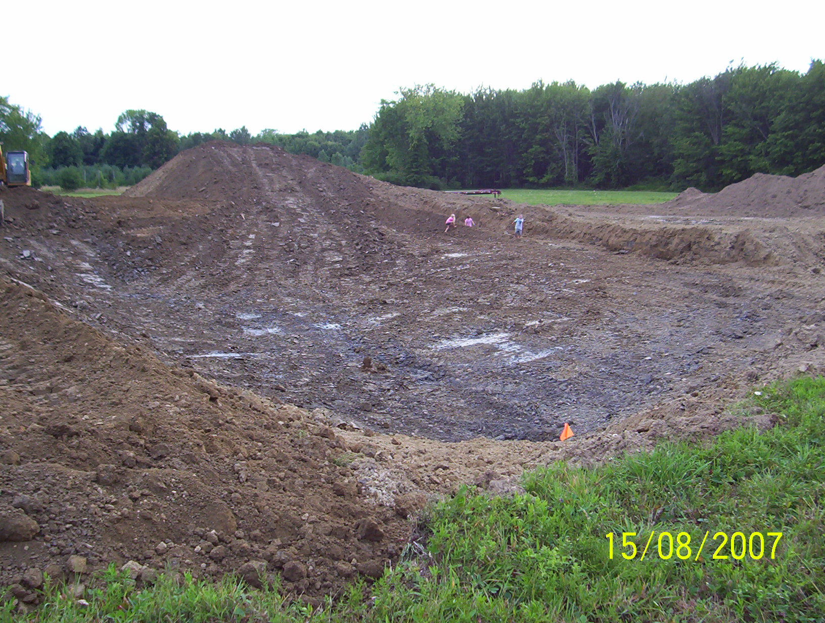

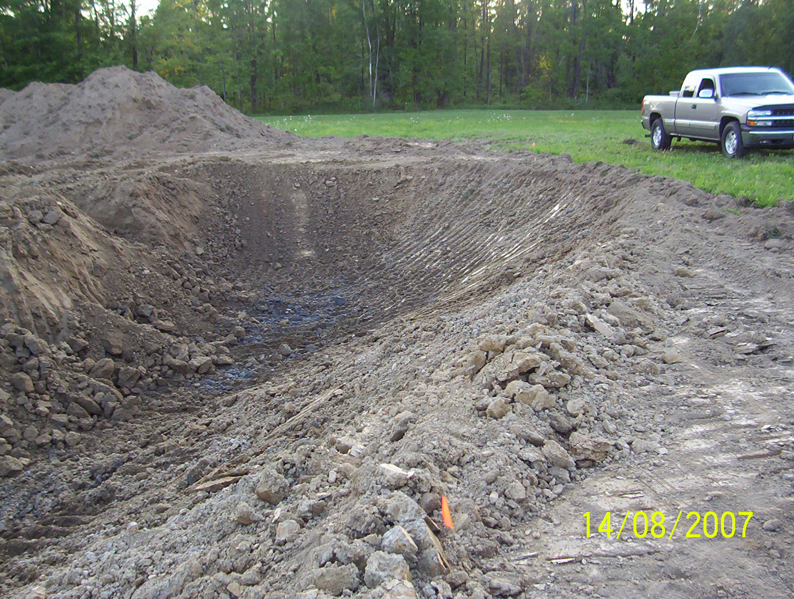

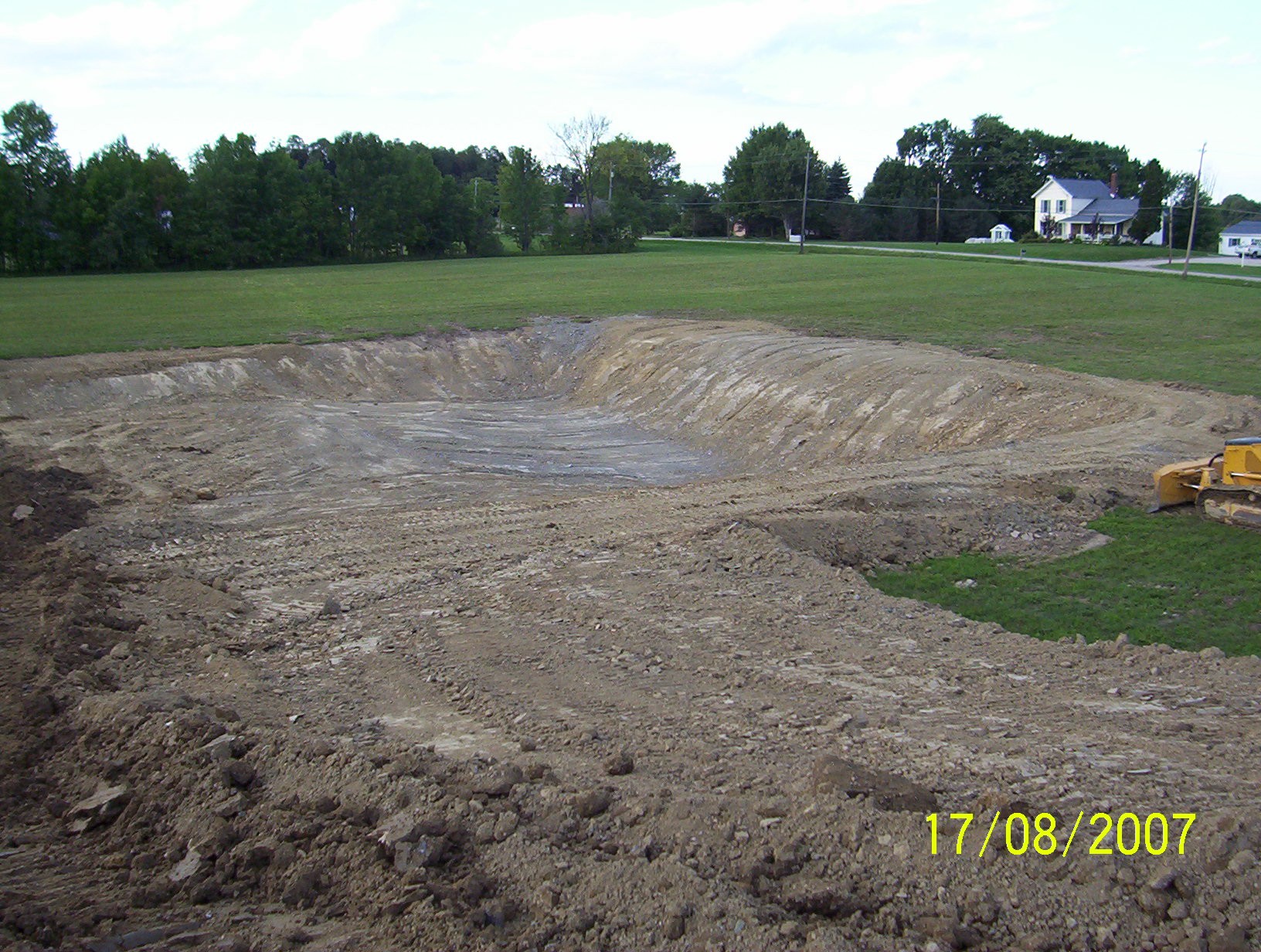

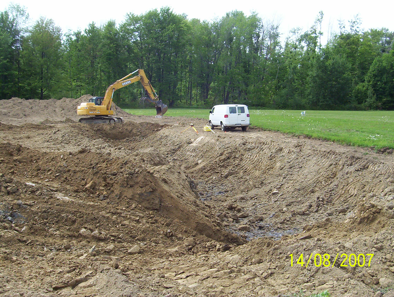

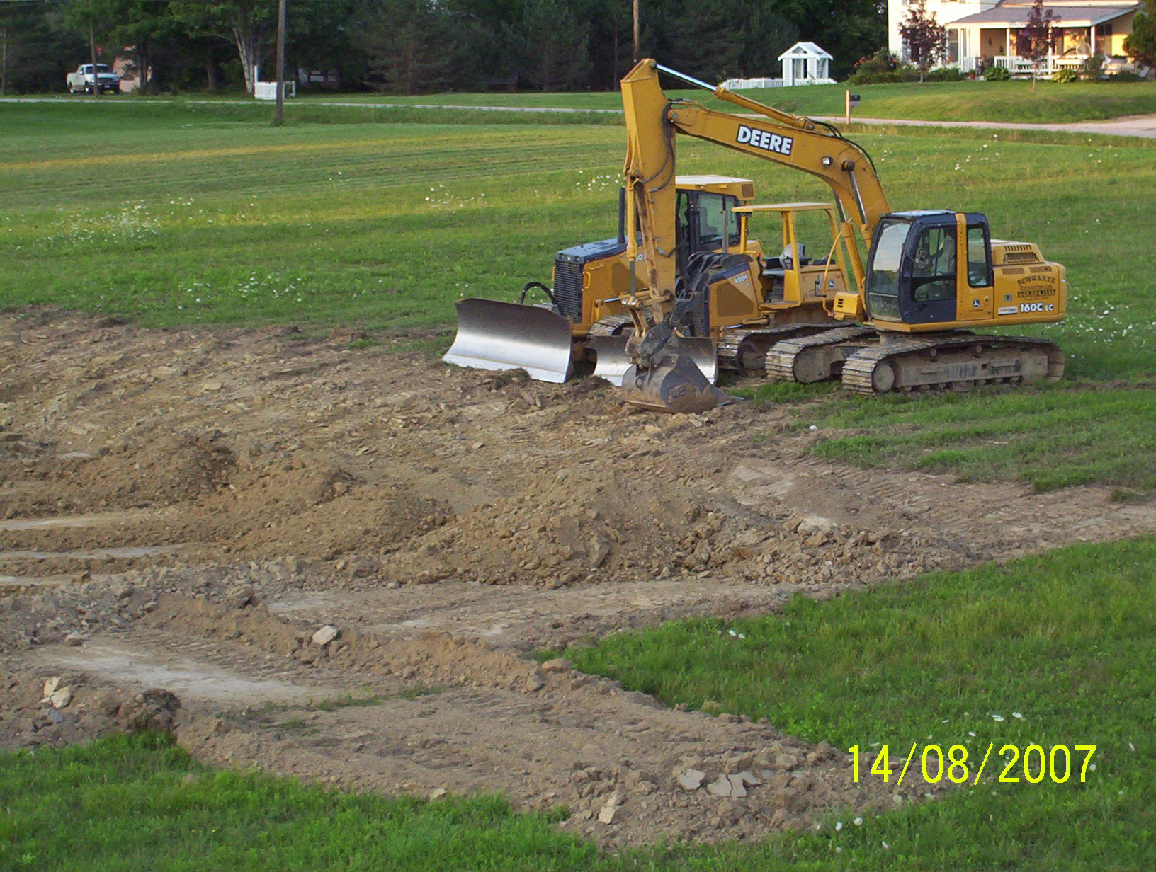

Hello all,, I am finally having my pond dug, and thought I'd share some photos of the process,, since I know how well we love pictures here on TBN. The pond is going to be approx. 200ft. long X 150ft. wide,, and run from 6 to 12 feet deep. Frankly, I'm amazed at the amount of dirt already , and they've only just begun.:D

Looks good. Are you going to put a liner in it or will it hold water?

Only thing better then a dozer moving dirt is TWO dozers moving dirt!!!!
What are you doing with all the dirt? Digging is one thing, getting rid of what you dig is where the real challenge begins. hahaha When I dug my ponds, I created contours, dropoffs, holes and debri piles for the fish to use.
Great pics. Thanks.

Small finish dozers? It appears we have two 100-hp+ JD dozers working on this project.......I don't count the excavator as I reject it's serious usefullness. Many, many good sized tanks in this part of the country have been built with a Farmall and a fresno, or a TD-12, or a D-6b/D-5 Cat........having two decent sized dozers on a job is nice. And they should be charging in excess of $100/hr per machine to do the job or their ripping their own shorts.

Naw, no liner,, the bottoms all clay, so holding water shouldn't be a problem.:D

Actually Eddie,, thats one thing I'm still trying to figure out,,,, the habitat-debris piles for the fish. Not sure whether or not to simply drop some old x-mas trees down on the bottom,,, or create/make some type of man made habitat for them.. And ahh yes the dirt,,,, WOW,,,,, well for starters,, I'm gonna build up a small hill for a shooting range, but I doubt that'll even dent the mountain of clay I have already and they're just starting. LOL
Probably use alot for fill, and the contractor says he may have a commercial job coming up soon, so he may buy some of it for his project. And I then plan to use those "funds" to buy a 3pt. post hole digger !!:D

Hi Joe,, I'm told the dozers are running around 150 HP . They seem to have a pretty good system going. The excavator digs and breaks up the clay, and the dozers push it up out of the hole. And I'm also told one of the dozers weighs around 45000 Ibs. . I don't know what they're actual per hr. charge is, I knew what I wanted to pay,, and the contractor came darn close, so I went ahead with it. The bottom will have a nice contour, probably unusual, but contour non the less. Will get more pics up soon showing the progress!!

Don't ask me how I know this but If the bottom is clay, have the operator scrape some off the bottom and onto the sides to seal them up as well. It saves a lot of leaking and swampy conditions at the dam edge of the pond.

Hi ToadHill,, thanks for the heads up. I do remember the contractor saying that he had to scrape the topsoil off around the outer edges/berms as well, so that the clay berms would "tie in" with the virgin ground clay to prevent leaks. So, hopefully this will work out well!!

Neat project. It sounds like you've got a good experienced contractor doing your work. But, if it is not too late, has your dam area been "cored?"
Coring uses the track hoe or a back hoe to dig a trench, or core, under the dam area. The ditch is then filled with good clay and compacted with either the dozers or a compactor, several inches at at time. This makes a very tight dam.
Keep the progress and the photos coming.:)

Hey Knute, thanks for the positive input. I'm not positive, but I don't think that they've used the core method. As far as the banks though, I'm impressed to see how easily those dozers can make it up them,, they are very steep. Hopefully tomorrow I can get some more pics of their progress, as one side is pretty much done. I'm assuming that weight of the machines running back and forth , up and back down into the basin will put a pretty good "compression" or packing effect on the clay as well.

I was going to mention coring. but it looks likethey are already far along with project. That is about the only use I can see for an excavator on a tank project. If you dont have good claycontent in dam water will seep through it, may have a marsh on backside of dam. Good place for mesquitos and snakes. We just dont build tanks like that here. If you have to push dirt morethan 100 feet then it is not economical with a dozer. Those are small finish dozers with 6 way blade, made to push loose dirt, like on a building pad. the blade is staight and cannot haul much dirt. A 6 size machine with a semi u blade is more suitable for this type of work. Scrapers are the only cost effective way to go.Not only can they haul the spoil out, they also do a great job of compacting on the dam.

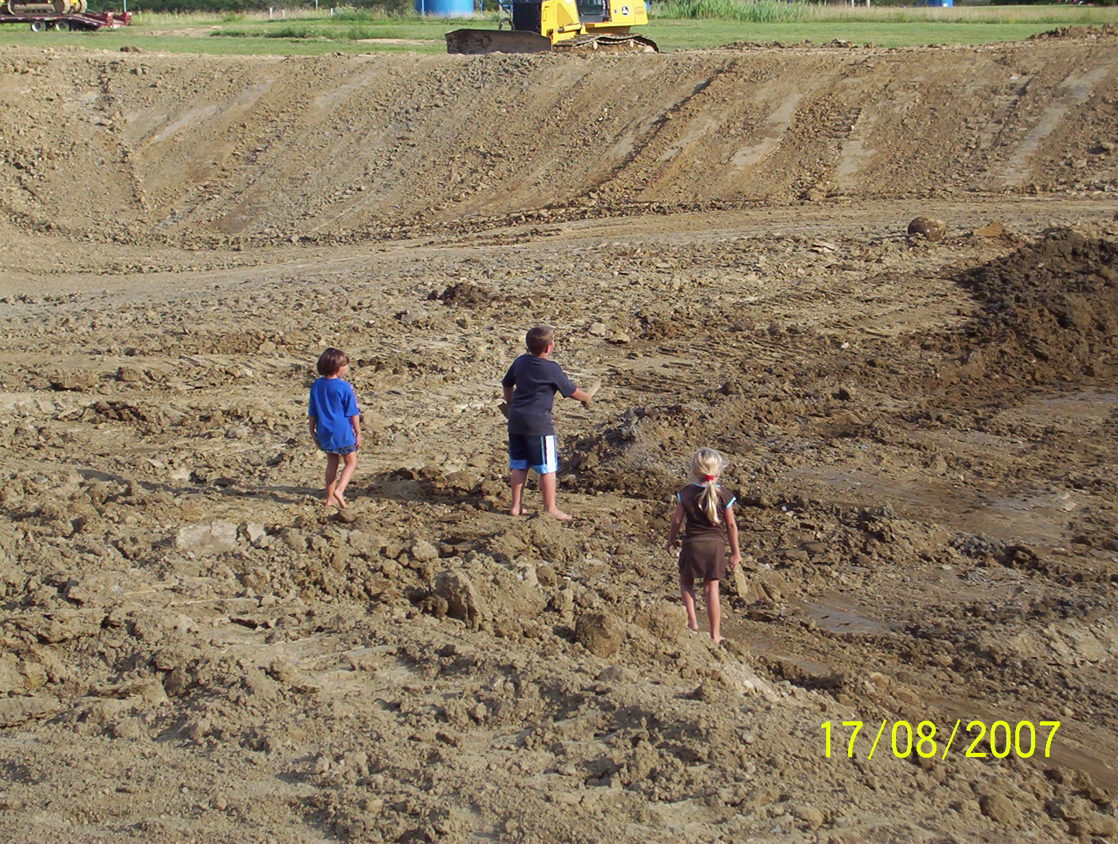

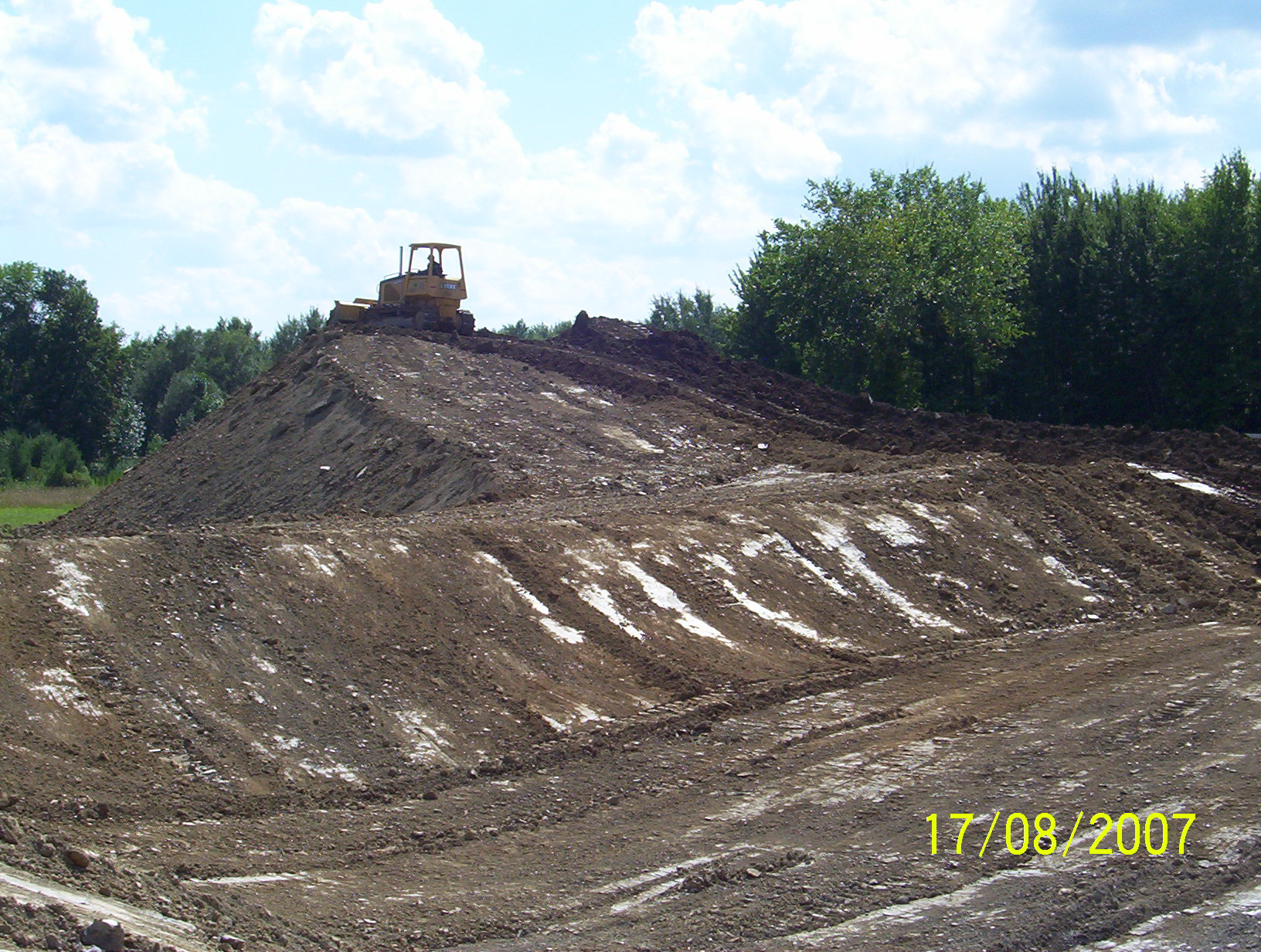

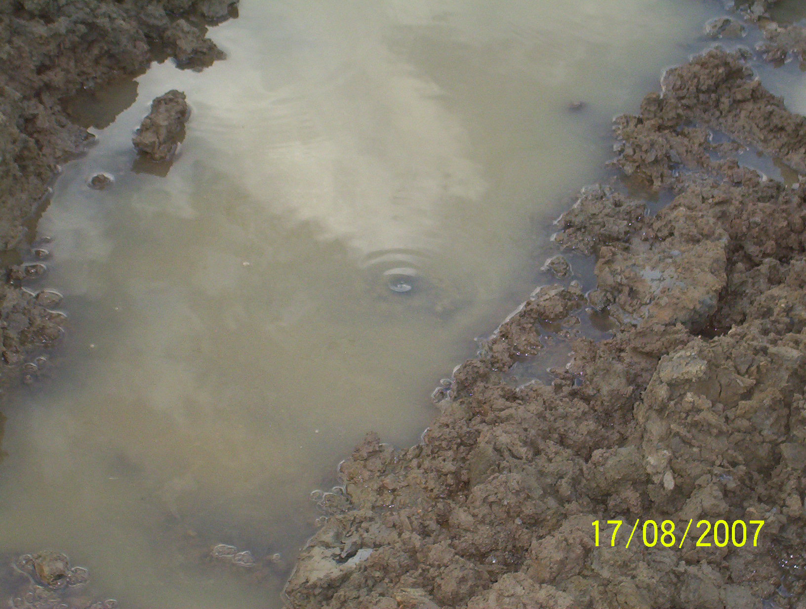

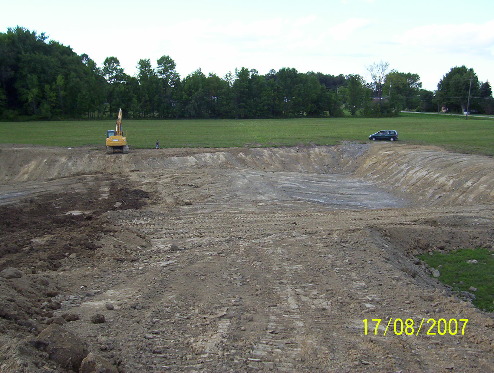

Well, it's been three days now, and the pond,,, or "tank" for my Texas friends:D ,,, is nearly done. And to add to my excitement,, today about a half hour before quitting time,,, the guys hit a spring!!!! I started getting so soft that the dozers had a difficult time. I've been taking more pictures than a "Japanese Tourist",,, and I know we all love pics,,, so I'm posting some. The ones of what appear to be a simple mud puddle, are the most noticible part of the spring,, as if you look closely you can see the water bubbling up from the ground.
