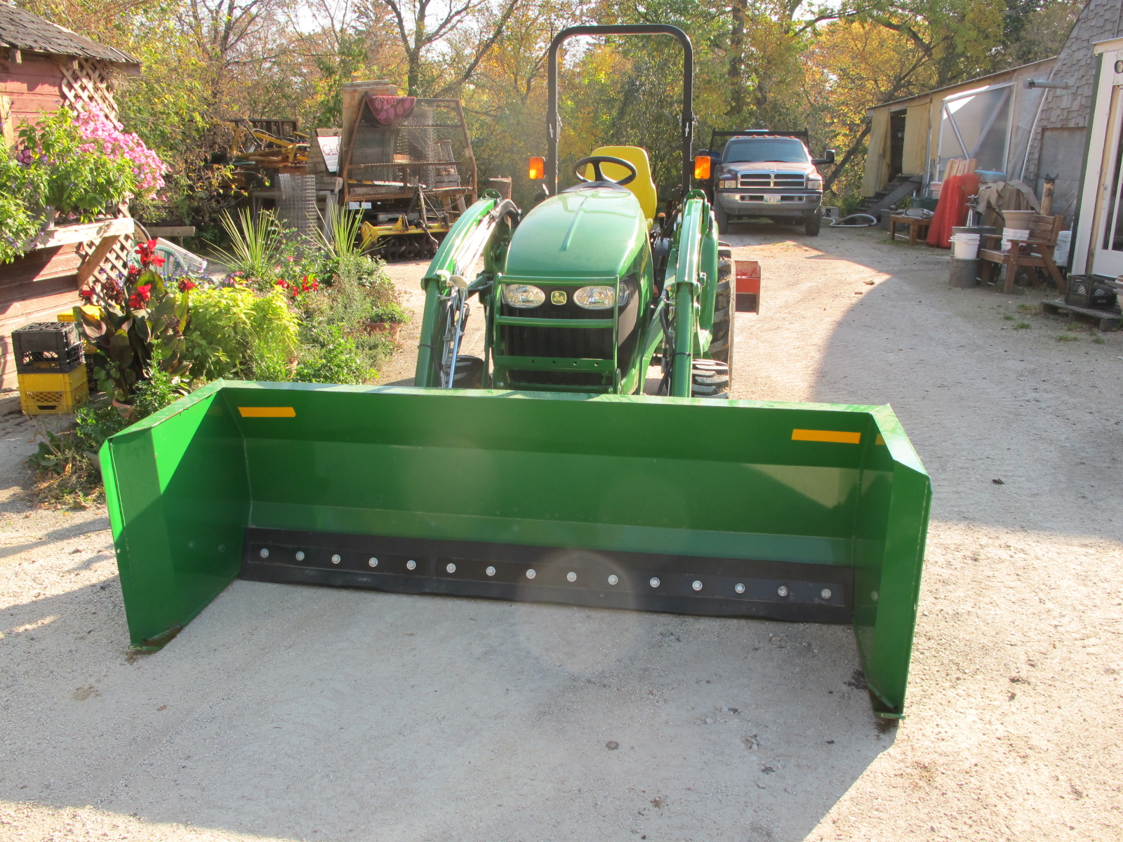

IMG_0612.JPG I borrowed this picture from "2014 John Deere 3320"
There are also snow blades available like this. This attachment would really let you push snow.

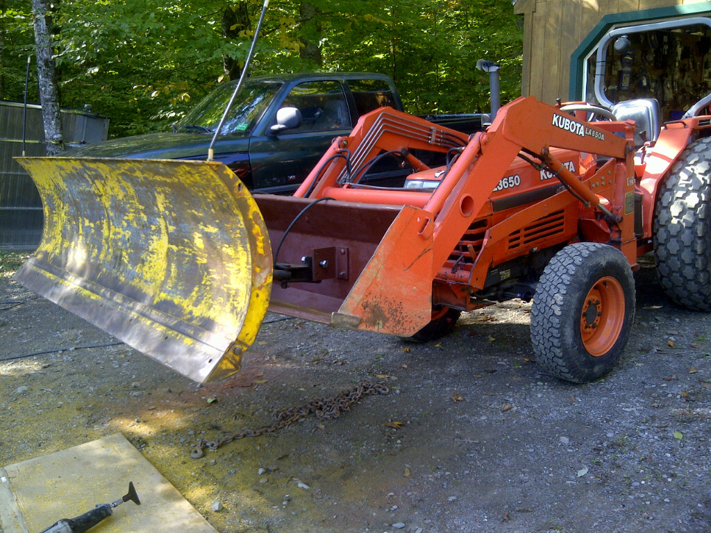

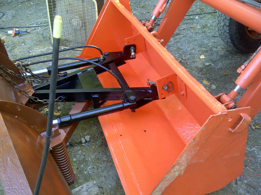

There are many ways of attaching a plow to "your" loader.
You can go the,, attach the plow frame inside your bucket route, just add a few supports
inside the bucket, easy to remove if you should need the bucket.
You could also go the QA route, you'd have to remove the bucket for this.
In your case, I'd go the "inside the bucket route'.

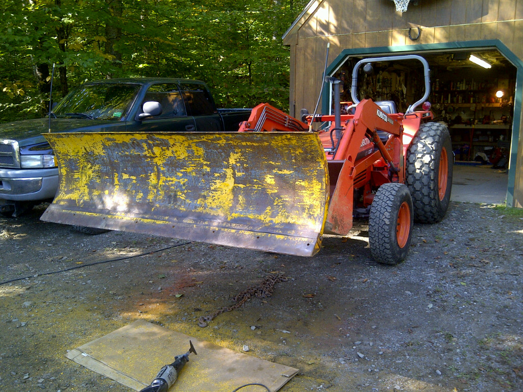

Heres mine Plow cost me $75.00 2 angle brackets $20.00 crossover valve and hoses and quick connects $150.00
and misc. paint its now yellow. about 300 bucksIMG-20140924-00205.jpgIMG-20140924-00206.jpgIMG-20140924-00204.jpgIMG-20140924-00203.jpgIMG-20140924-00202.jpg
