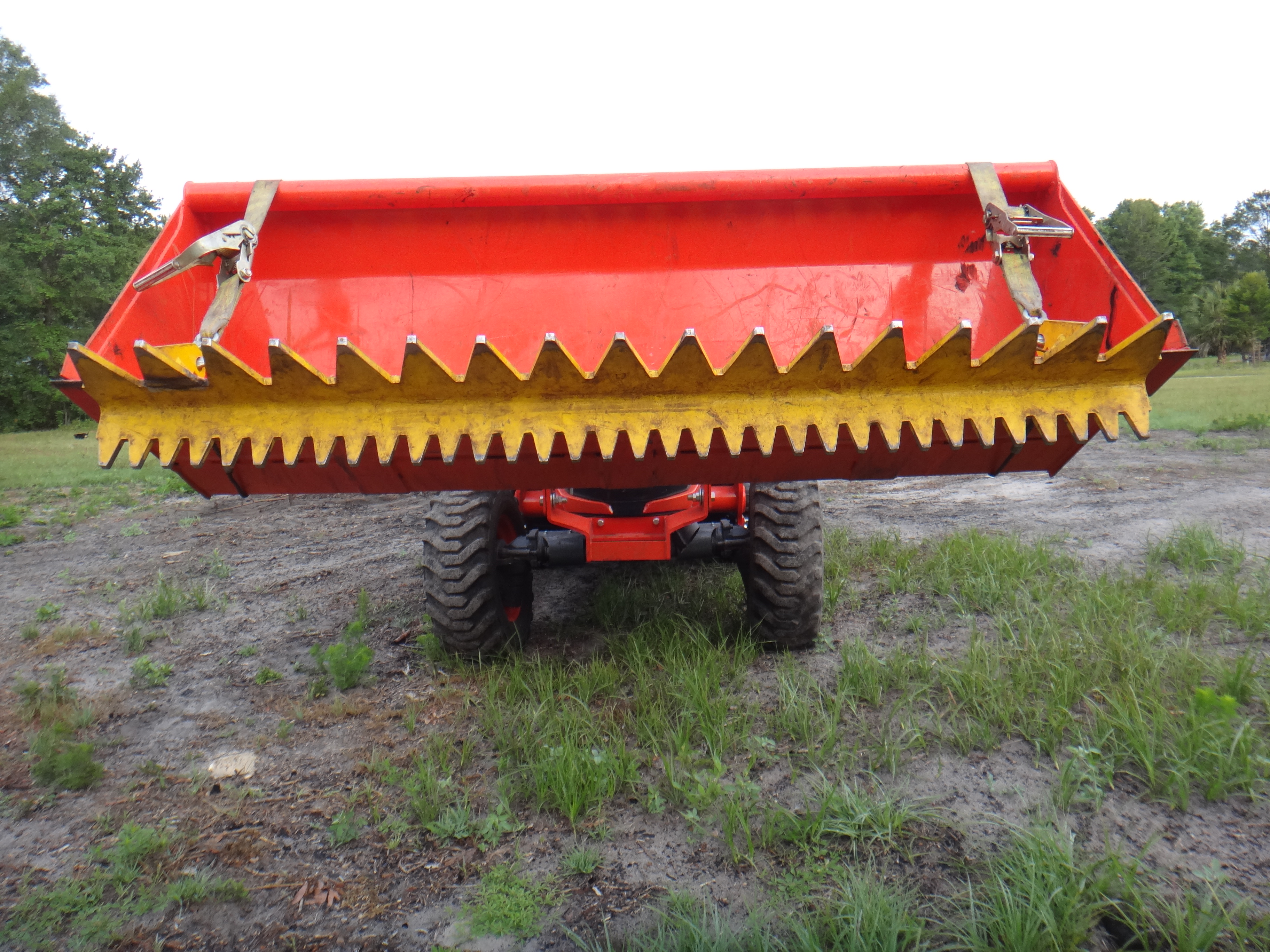

You have decided on a Finish Mower rather than a Rotary Cutter/Bush Hog. In that case, consider a Ratchet Rake attachment for your bucket, to deal with brush, Blackberries, loosening posts and garden prep, rather than beat up/dull your finish mower on brush. One of my favorite attachments. Ratchet Rakes are sold by the T-B-N store, among other sources, delivery by FedEx. Photo #2 will give an idea of its utility for standalone garden prep.

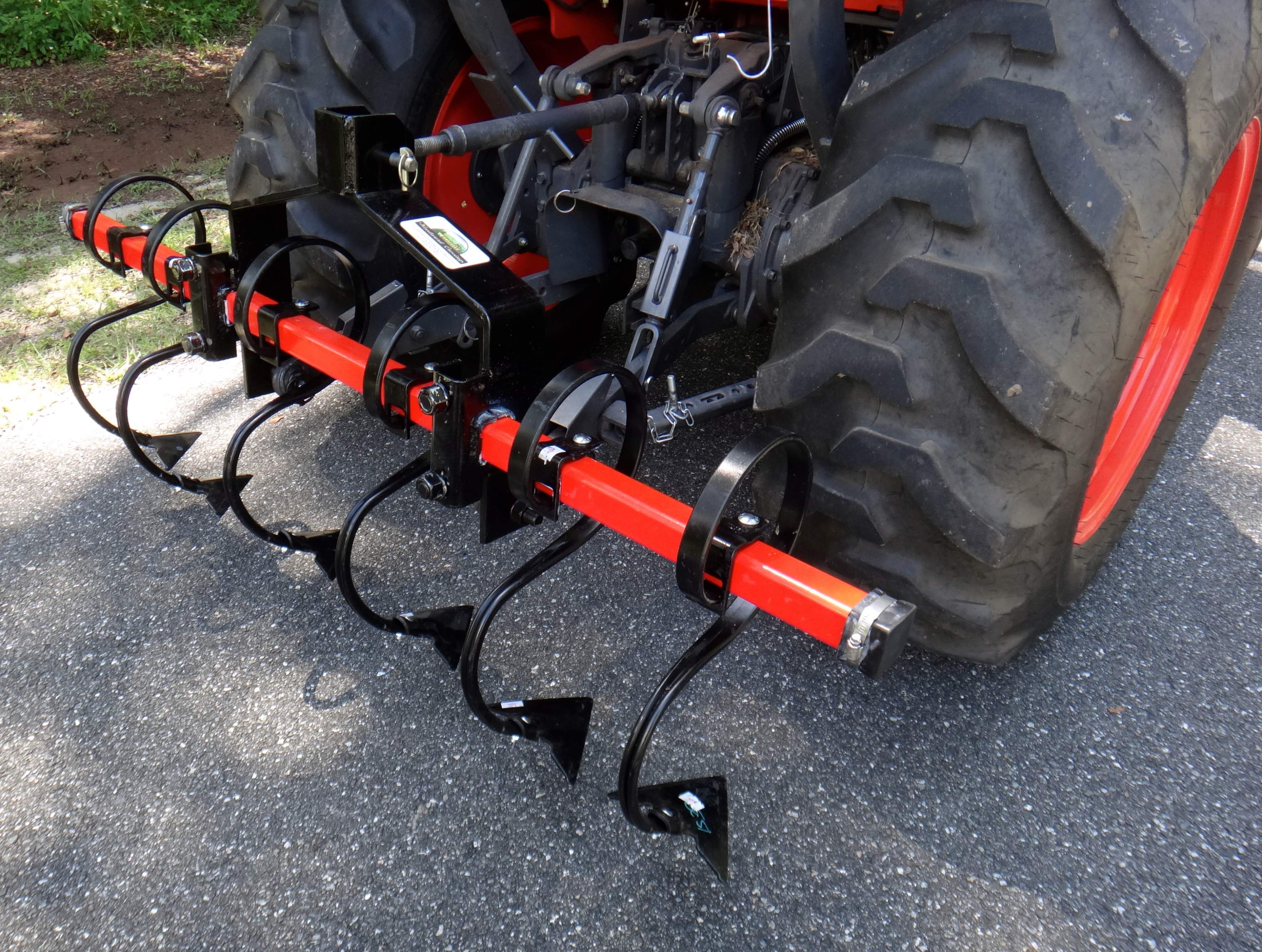

You may want a 'tween rows garden cultivator. There are many. I have a MODULAR tool bar Cultivator from Woodward Crossings in Pennsylvania. Nice people to deal with.
