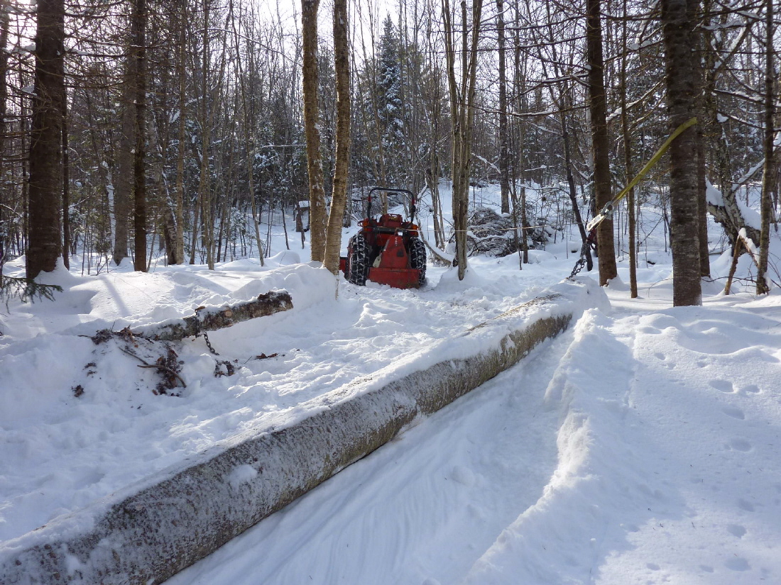

The block just changes the direction of pull. The tree was laying 90* to the road so I used the block to pull it straight out. Then I unhooked the block and got it around the corner. First the butt log then the second log. Then I hooked them both and pulled them to the tractor. Snatch blocks are really useful. Here is another one. Pulling a fir log up a bank. I put the block high to help lift it. My winch is rated at 6400 lbs and my tractor weighs 5000 lbs.
