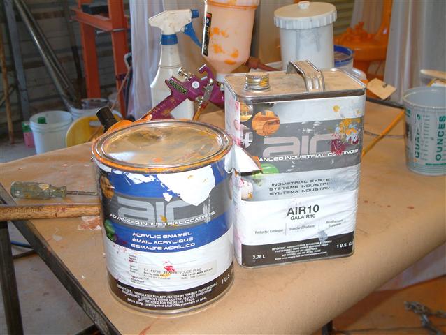

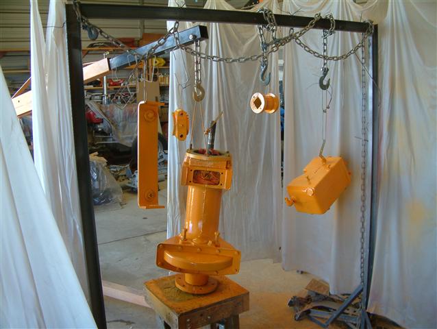

Here's what I did to paint my 1951 Minneapolis Moline BF tractor after taking it apart and cleaning the parts.
Bought the paint, primer and reducer from Equipment Color at
http://www.equipmentcolor.com/
Good luck
