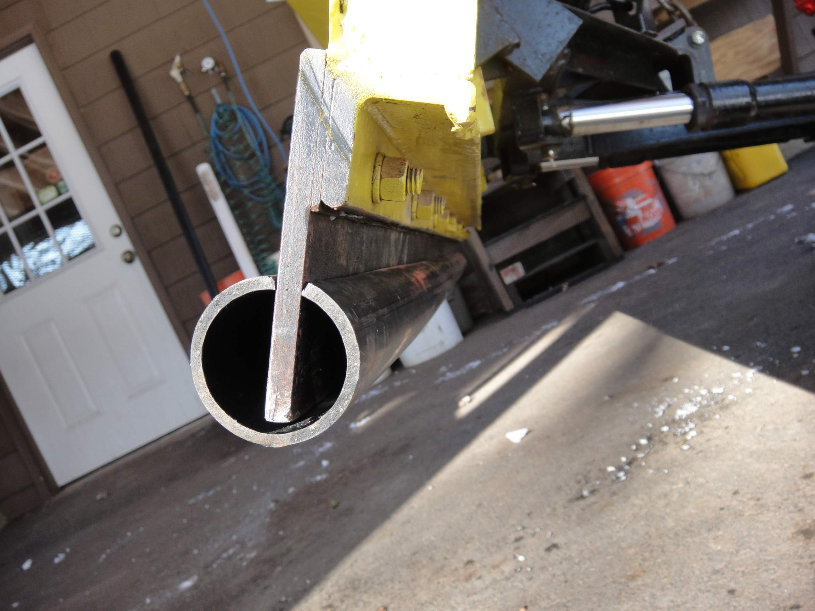

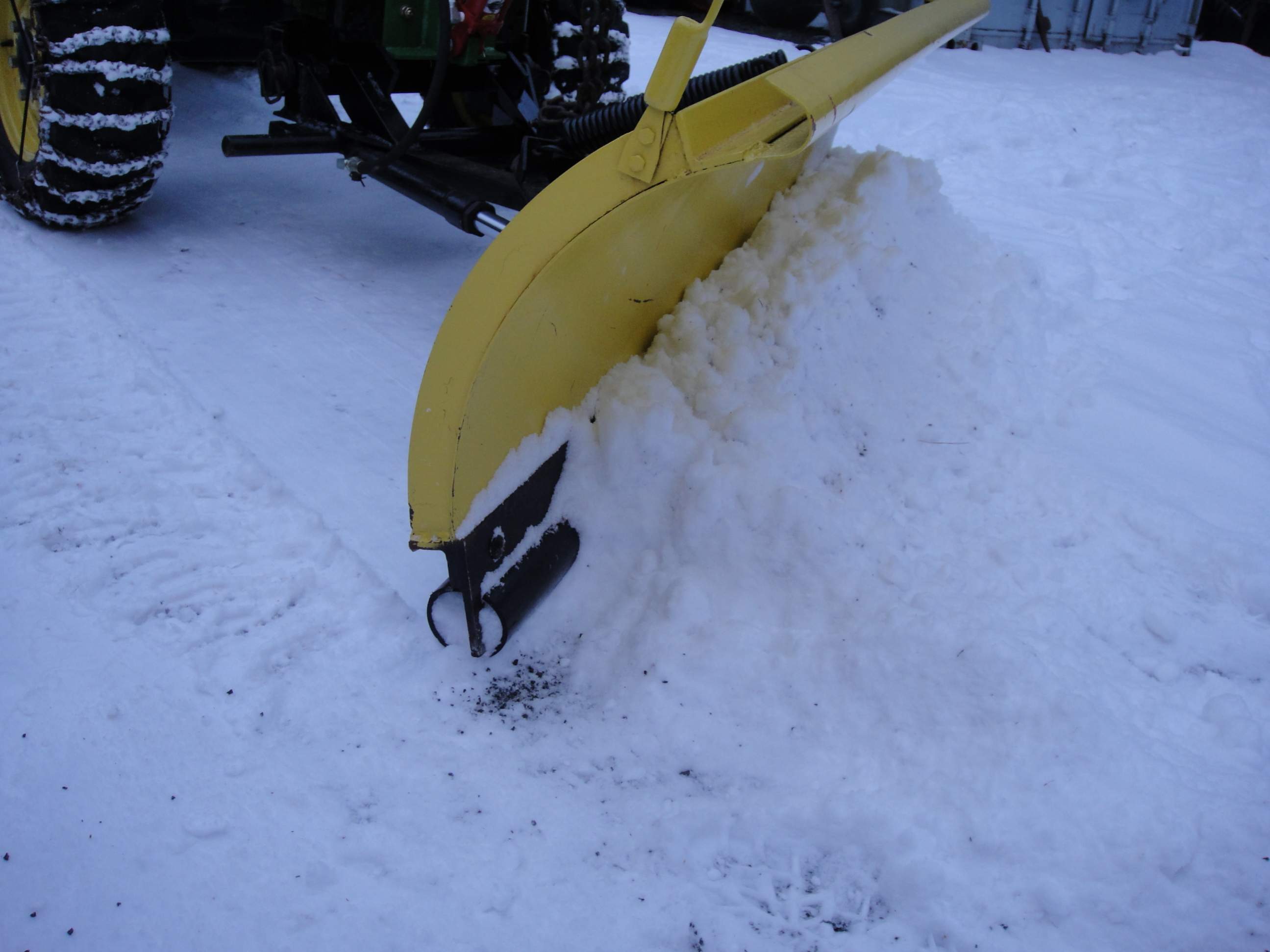

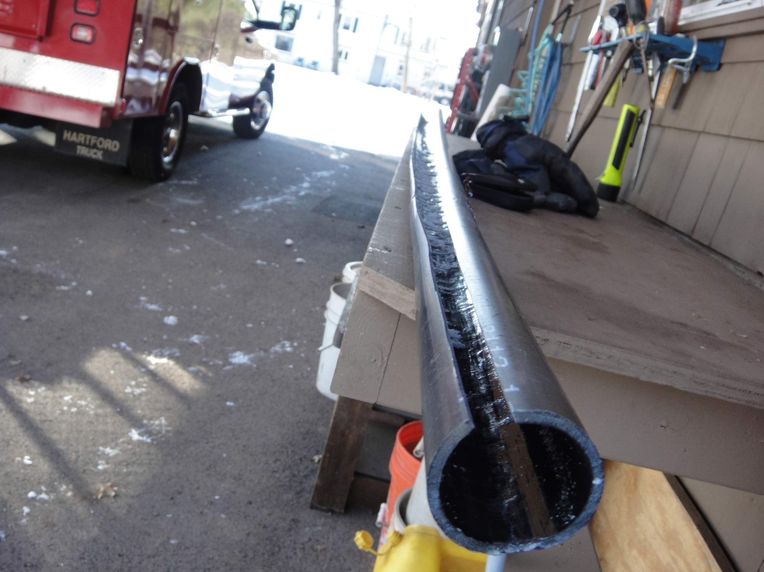

   / Another pipe-on-the-FEL for pushing snow #24
Yup same here, I reluctantly tried pipe on the cutting edge but was very surprised by how nice a job it did. Only problem was that as others have mentioned the plastic pipe would only last a brief time before it broke, opened up and fell off. Would have to be steel, not sure how to cut a 1/2" slot the full length of a steel pipe.
I tried 1.5, 2 and even 3 inch pipe, on 3 different blades, Now I have a 1/2 a garbage barrel of pipe pieces :(
JB.

   / Another pipe-on-the-FEL for pushing snow #25
A 4" angle grinder fitted with a Super Thin cutting wheel would be the easiest way . Two lines scribed on the pipe at the desired distance to follow and by making two cuts , a strip would be removed . A small chain welded at each end of the pipe and hooked to the top of the blade with turn buckles would keep it in place .
Make sure you cut away from yourself , never towards you as this will destroy the wheel in no time flat . Go steady , going too fast will result in brown dust and that is your wheel disintegrating .

I'm using my FEL to push snow and it's on asphalt, but I haven't had near the issues some have posted here...
I used 1" PVC conduit I had left over from a project. Used a 4" grinder to cut a 1/4" slot down the length and used a large rubber mallet to beat the pipe onto the cutting edge of the FEL. I've used the same piece of pipe all winter and we've had record snow around here. Now, I have had the ends of the pipe crack and some smaller pieces eventually break off, but it's nothing near shattering to pieces. It's worn quite well over my asphalt driveway.
   / Another pipe-on-the-FEL for pushing snow #28
Ive cut the legnthwise cuts fairly easily with a circular saw and metal cutting blade from wal mart.One blade cut me two 7 foot pieces.(Schedule 40)
