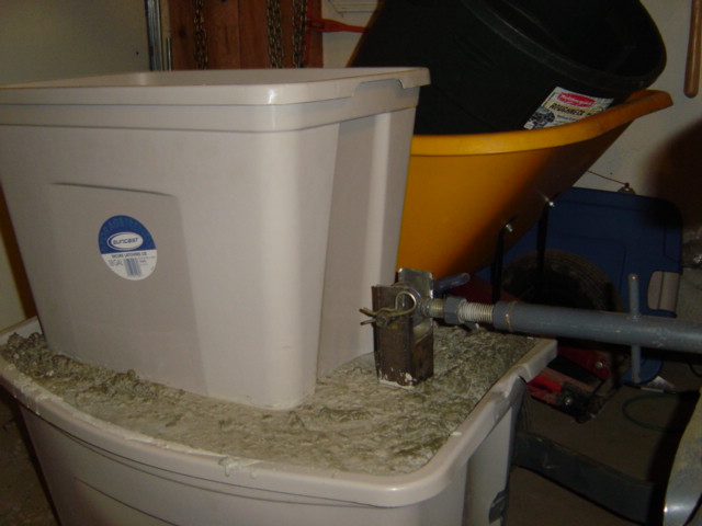

Here's the tub on tub construction

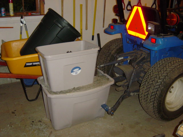

close up of front.
I haven't poured the top tub yet, but I did stack the remaining sacks of concrete on for a test lift. I remeber a couple people here not being able to lift their ballast box after they made it.
All told, It should weigh about 1,000 lbs if I can get all the concrete in it.

Nice looking job. I did a simlar one but I made a form and put a flat piece of steel out the back so I would have a draw bar point without having to take the counter weight off.
