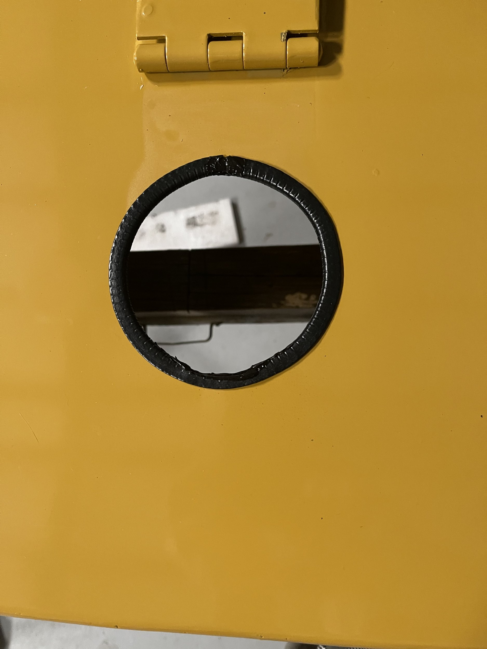

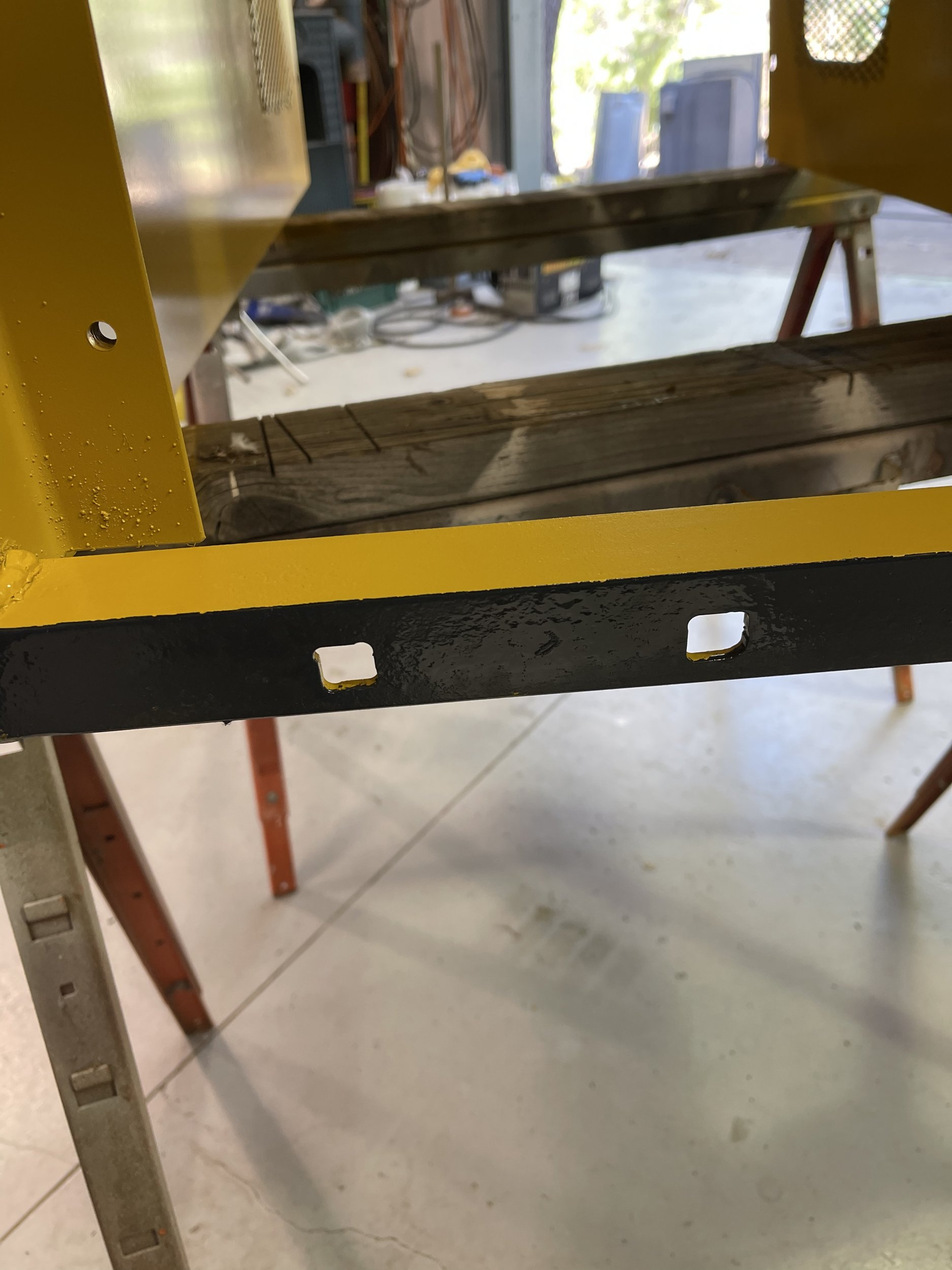

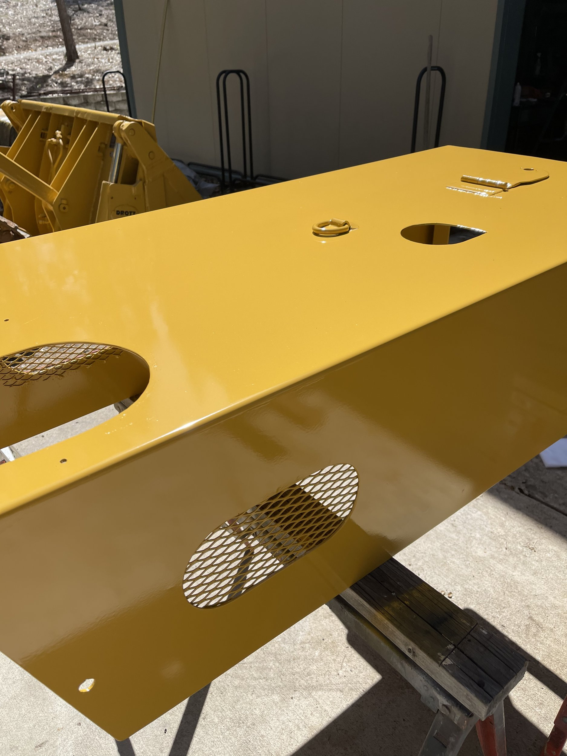

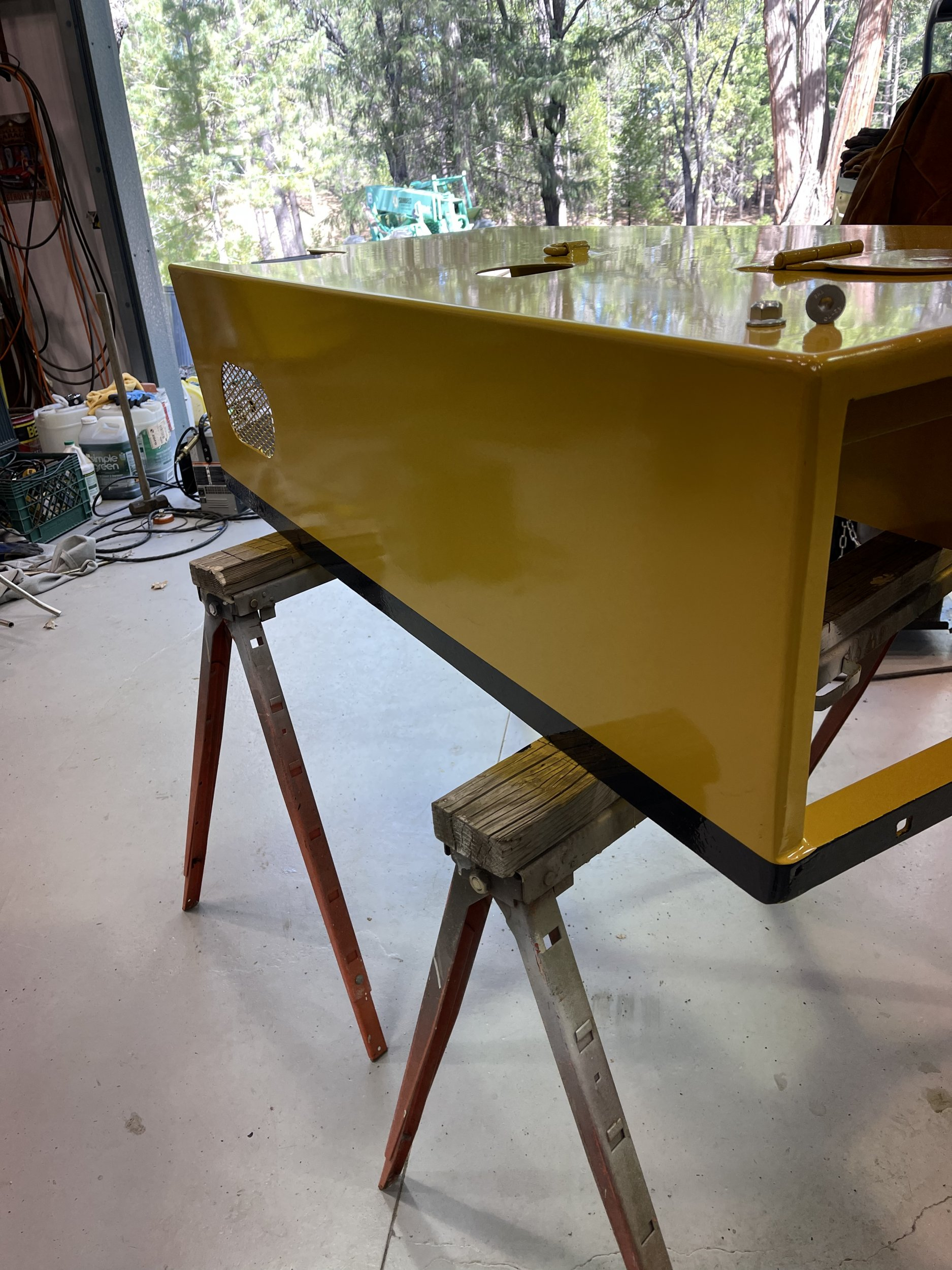

Here is a small update. I have been working on the firewood and burning the tree trimmings.
I finished the hood including the radiator access and primed and painted all the parts I made so far. Not a hand rubbed finish exactly but nice enough for the tractor. I made the hinge mounting holes square for adjustment and got some 12mm prevailing torque flanged nuts to use on there.

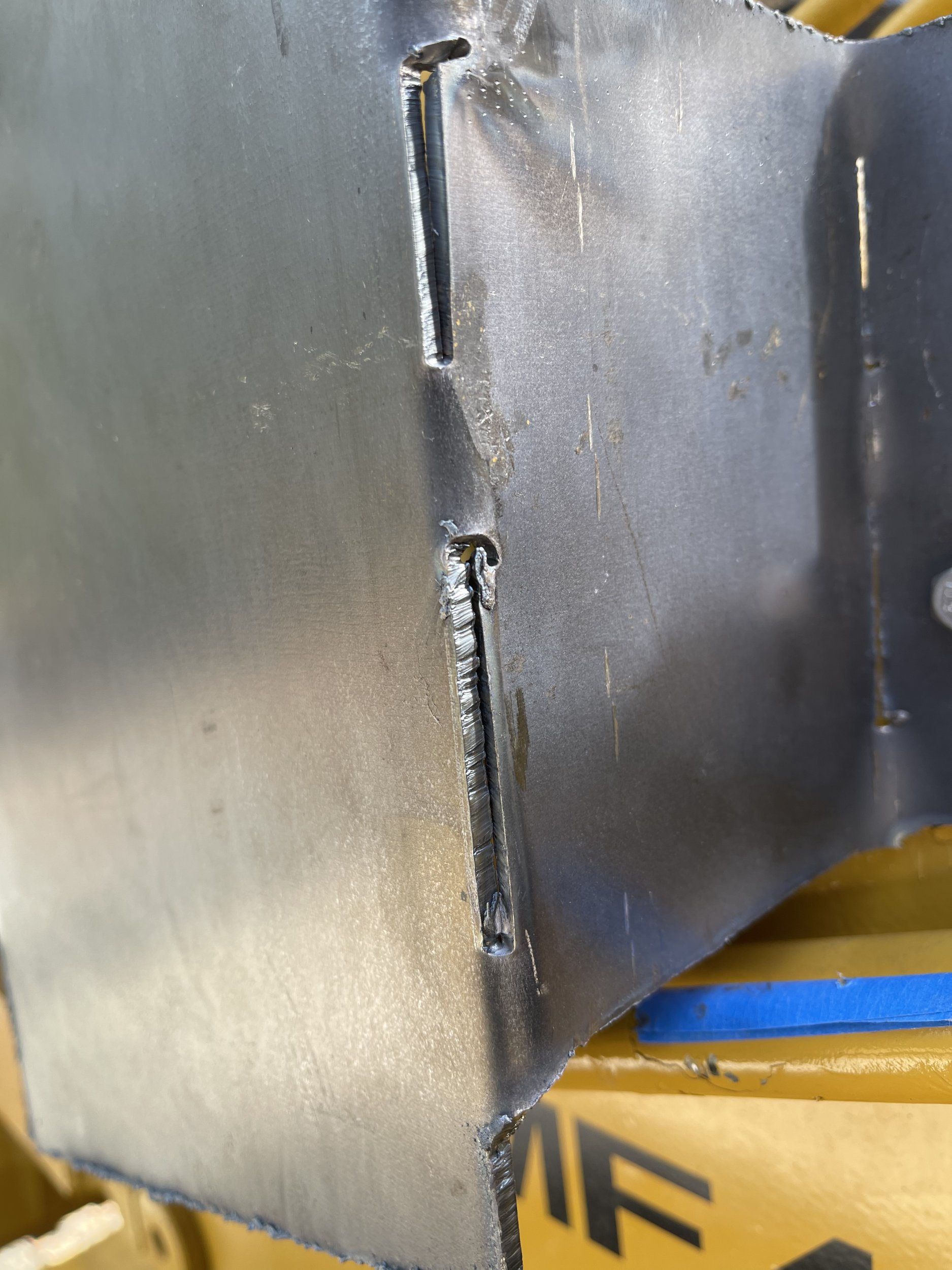

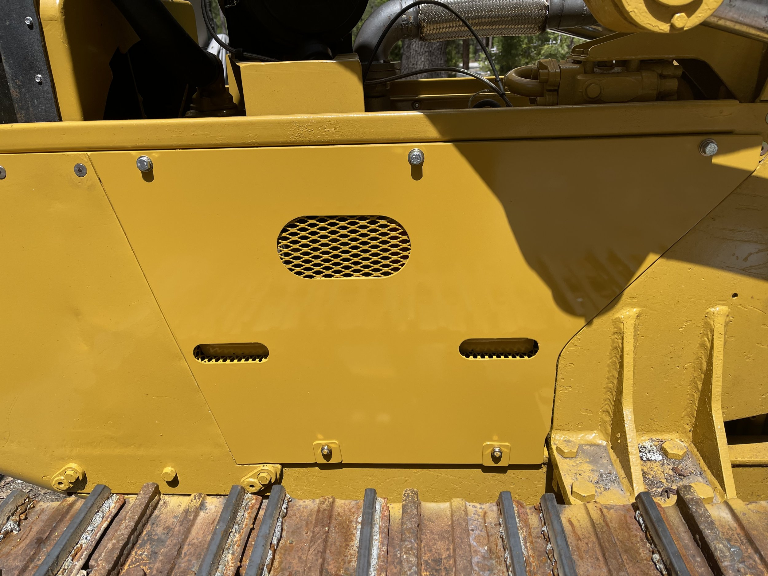

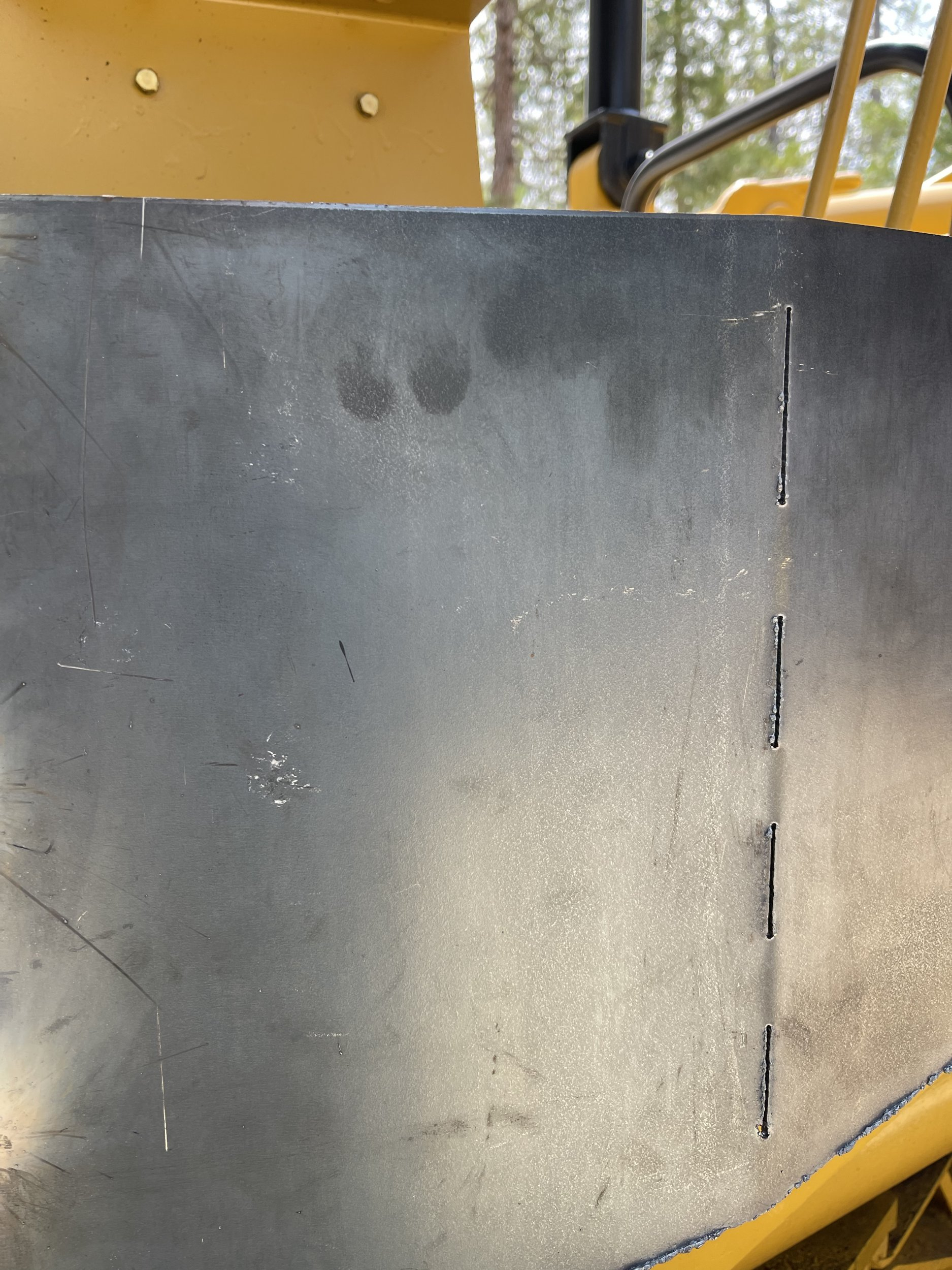

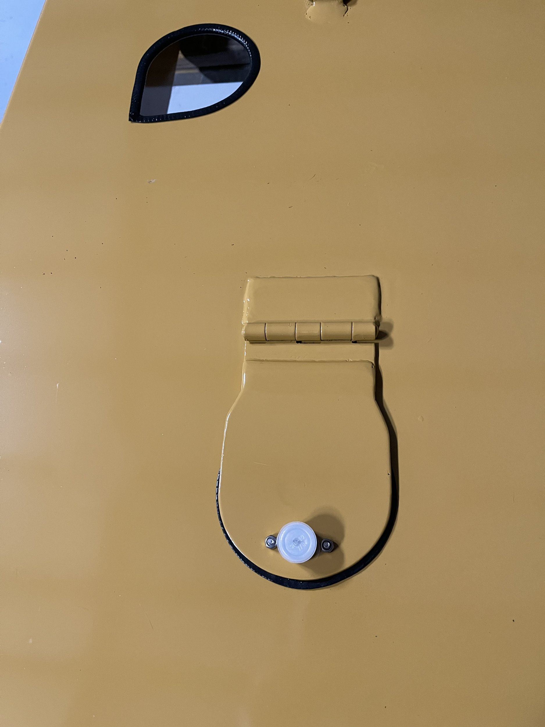

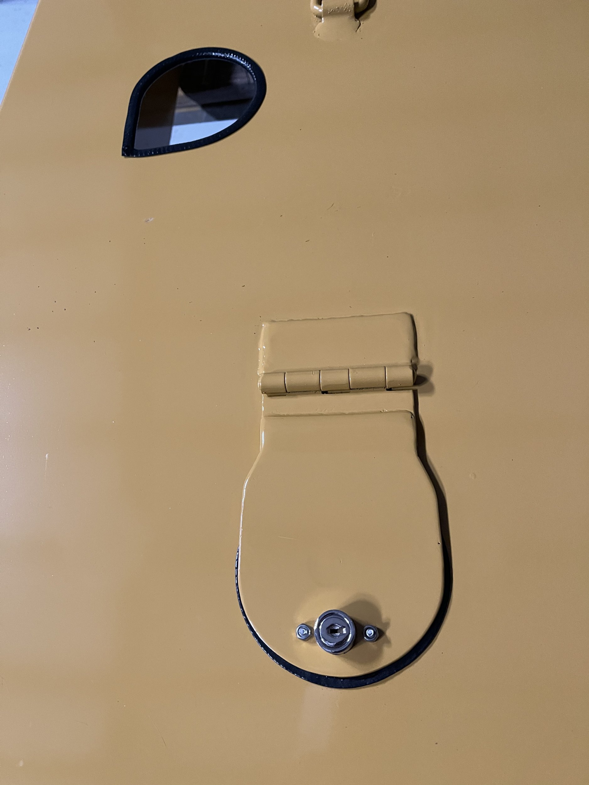

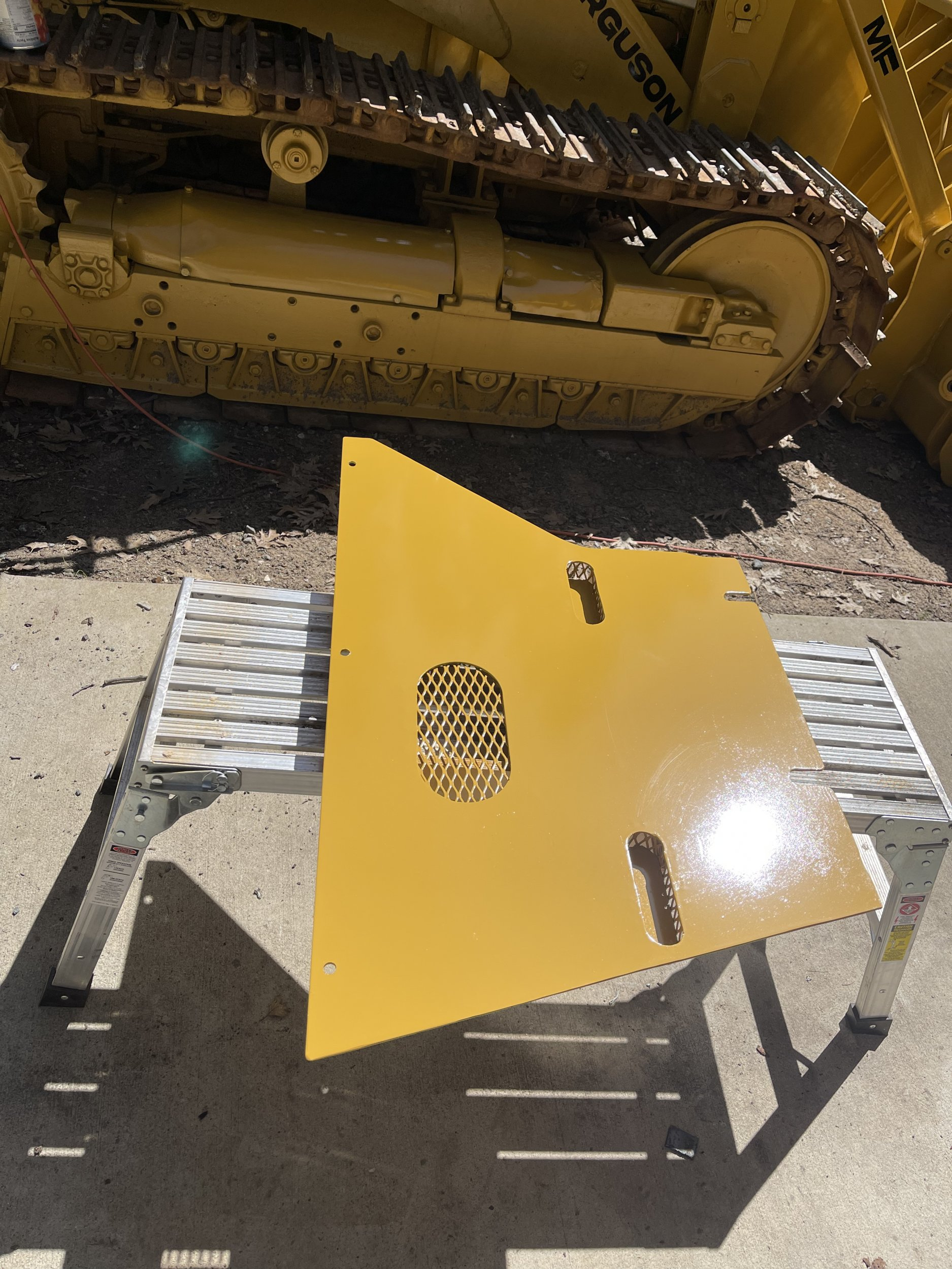

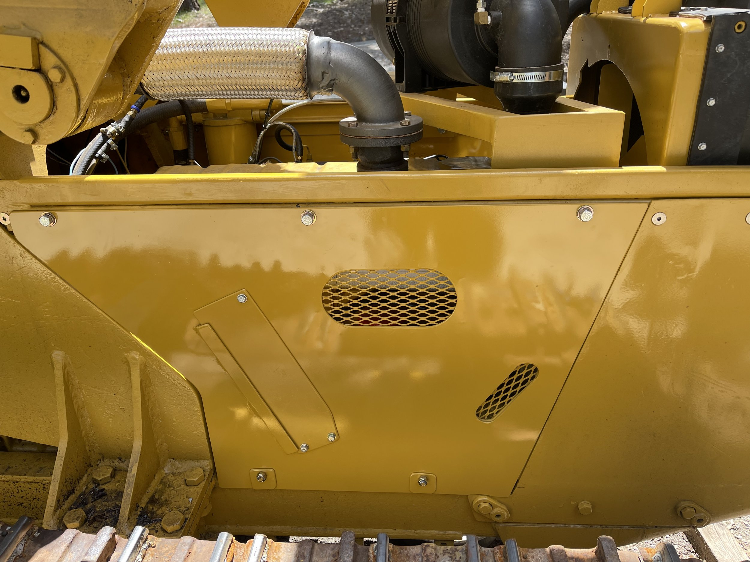

Here is my latest update, I put on the side covers after I fixed a fuel leak on the injection pump. I also did a second valve adjustment now that things are seated in a bit. I made a couple more missing covers and I included a couple pictures to show how I cheat on making bends in 10 gauge when the brake is not nearby. I finished the locking radiator cover too. Next is the floor plate, the last missing piece.
