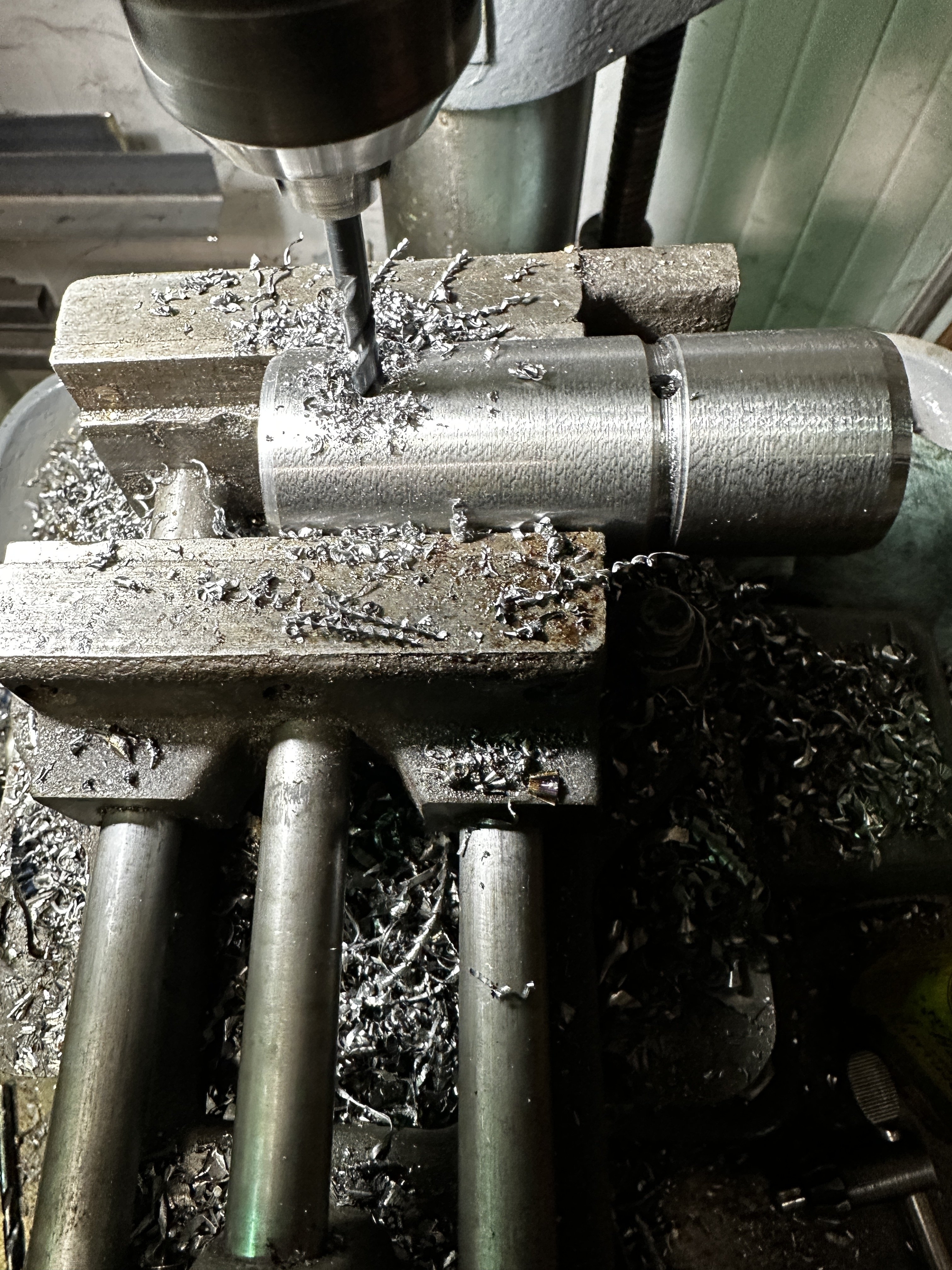

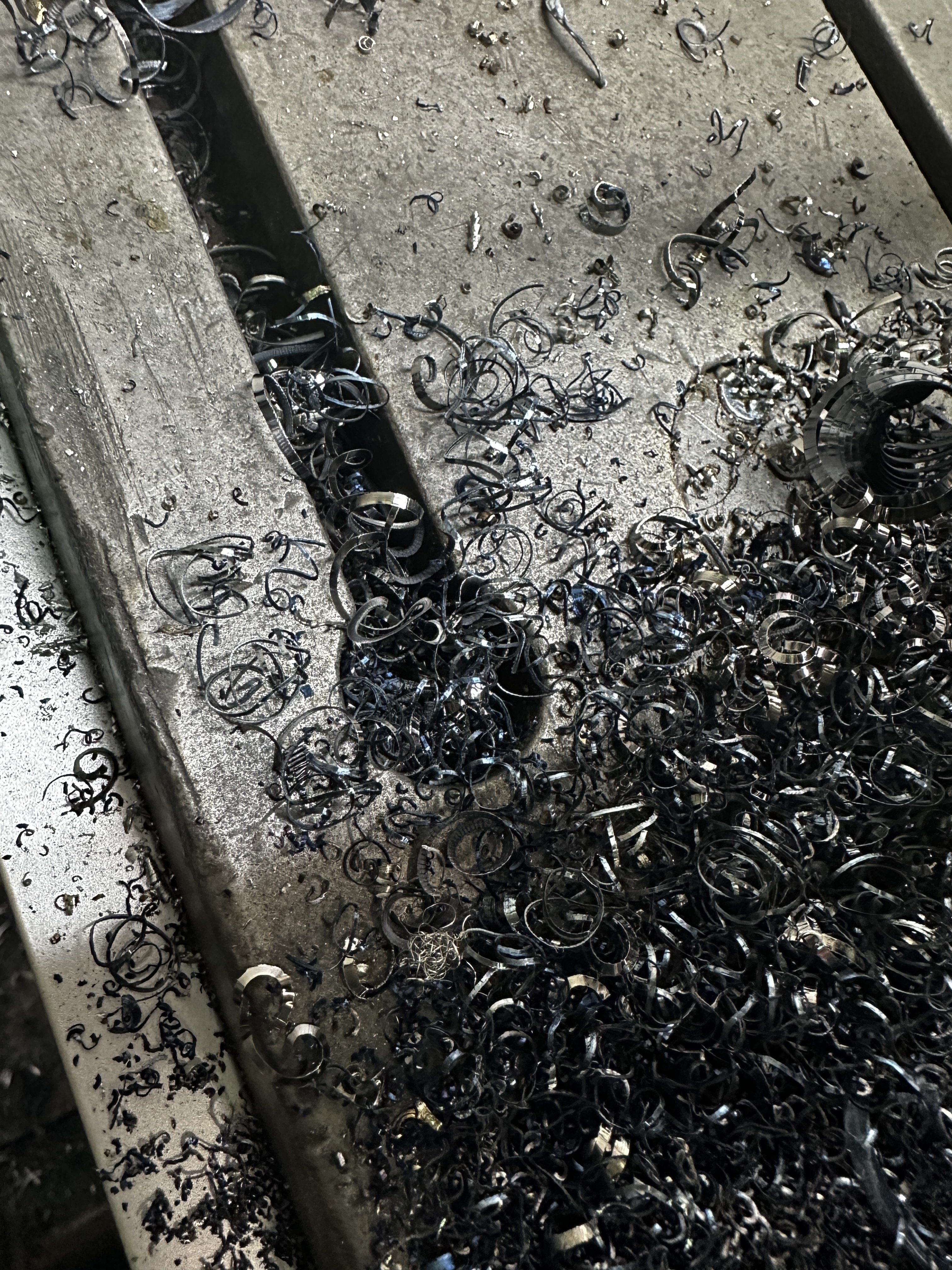

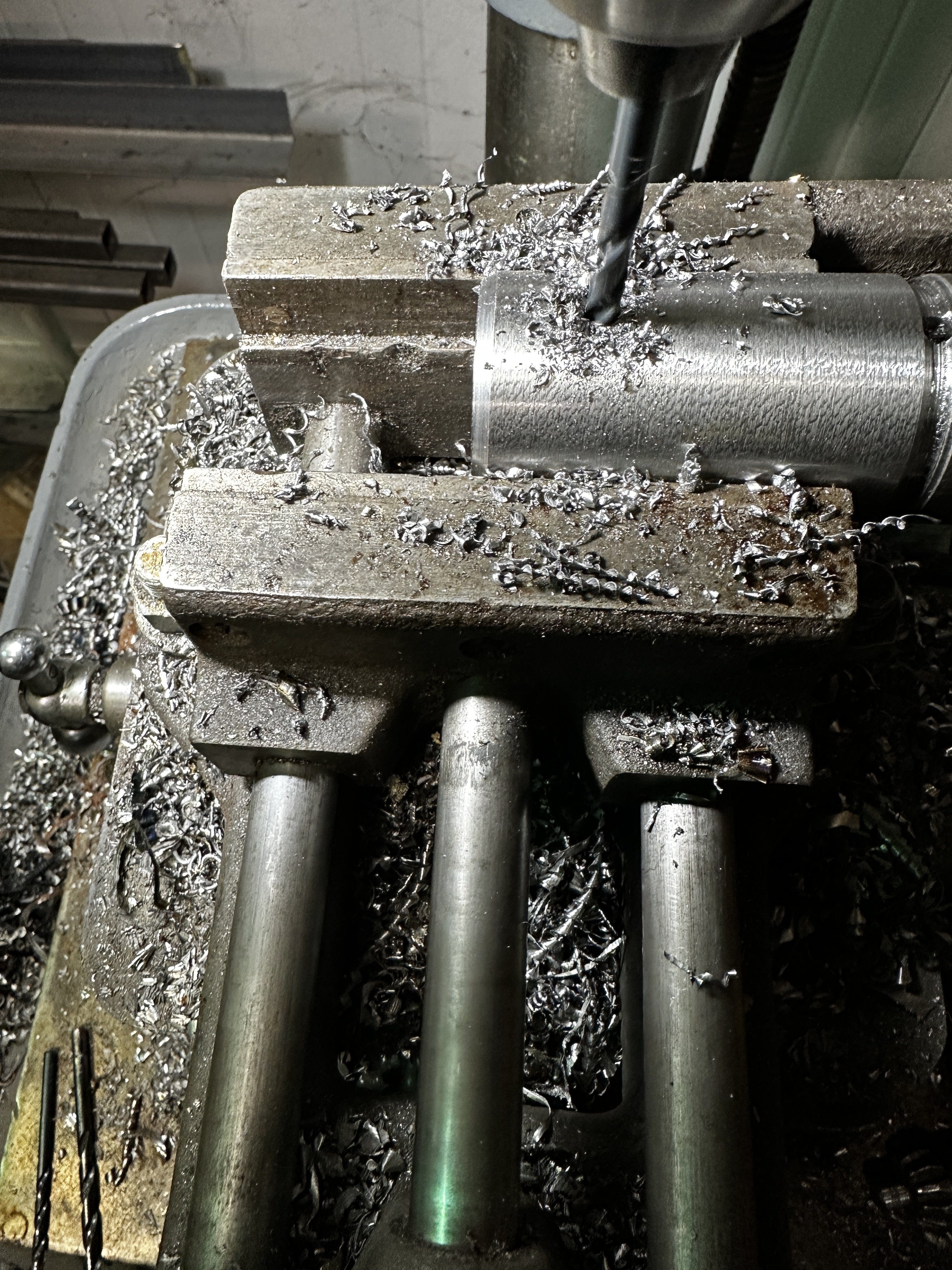

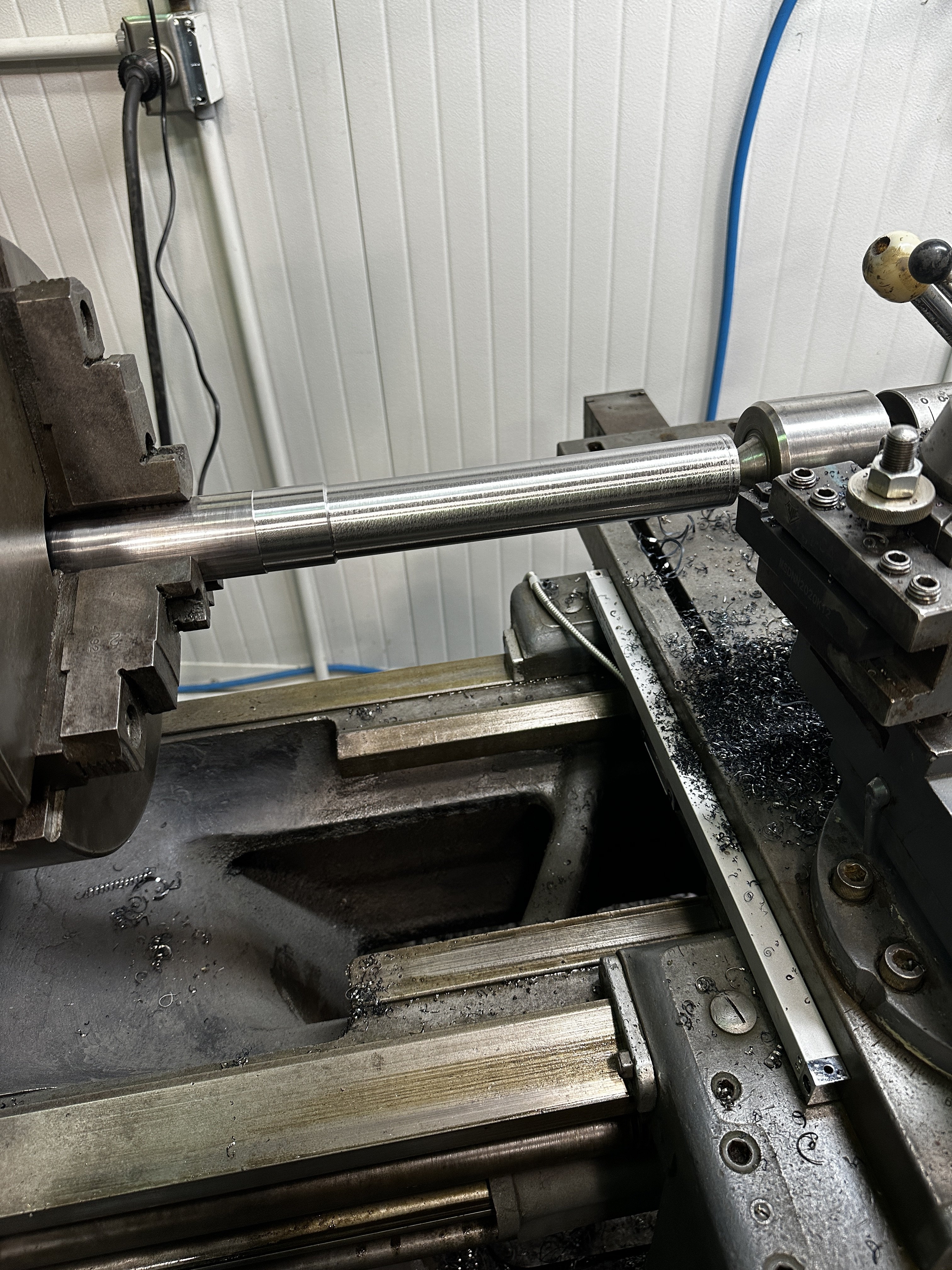

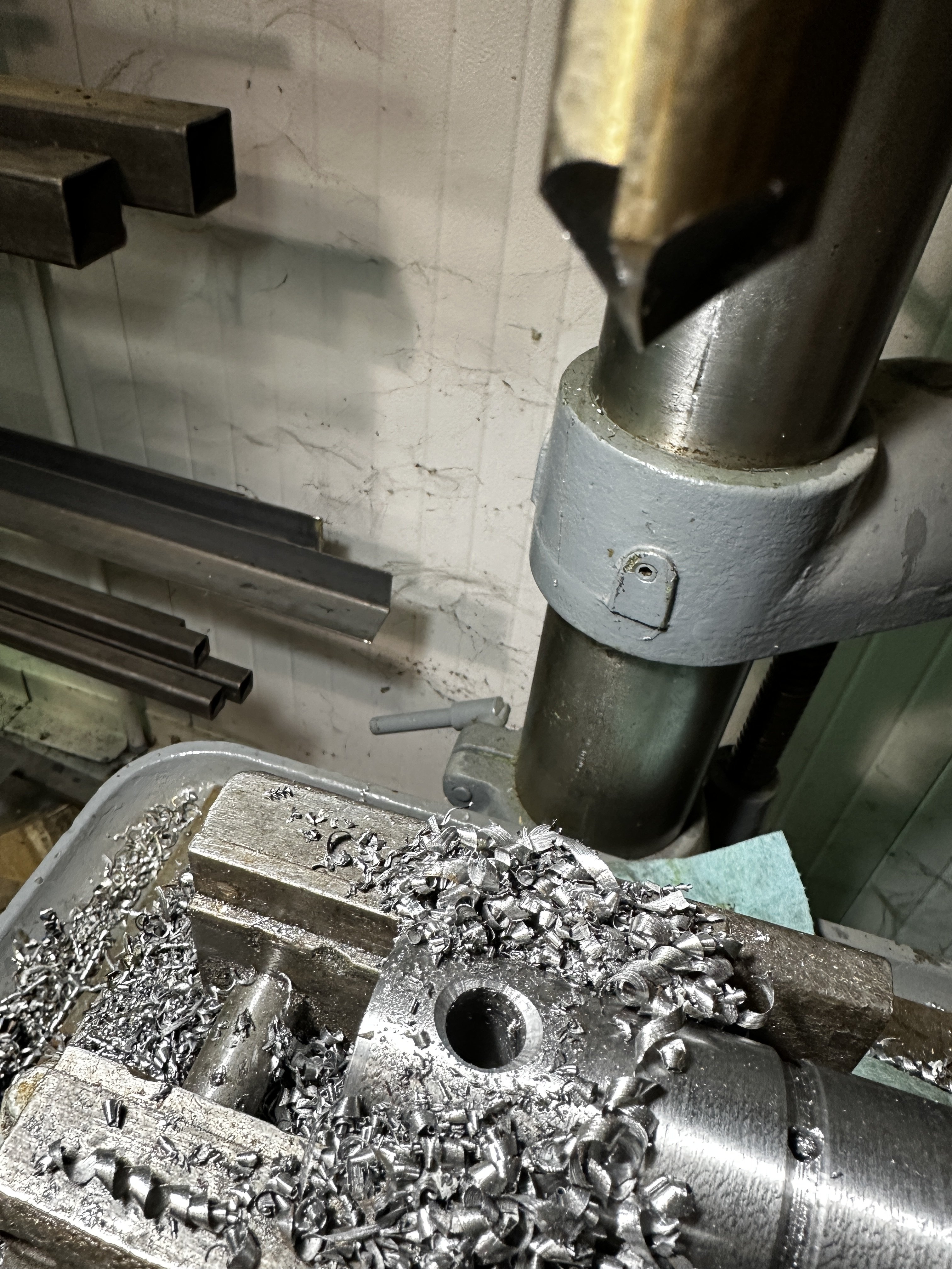

Well, I finished the VFD conversion on my lathe. So that allowed me to make the lower pins for the clam cylinders. I had reamed the worn cylinder base holes and the ears on the bucket as well. The pins are now ready made from 4160. Oversize to match the reaming and I drilled them and grooved them for grease fittings. Now to make the other stainless tube that supplies the clam cylinders.
