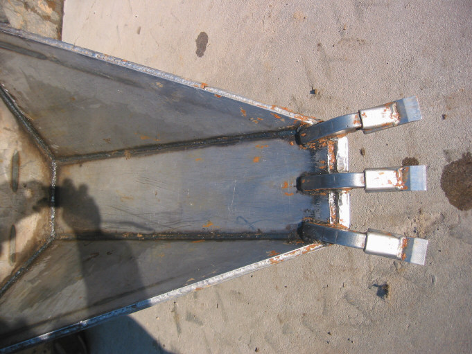

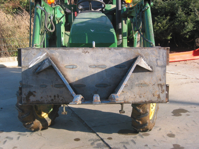

Here is a picture of the bucket I just finished building. Randy's earlier post under "Shrub Removal Bucket" got me motivated. I had a friend shear the metal out for me. My tractor is 28 hp and my fathers 1070 is 38 hp I believe so I stepped up the plate thickness to 5/16" except for the large backplate which is 1/4". The two 6" channels were already on hand. I decided to add some stiffeners to the bucket edges and make it heavy duty since I wasn't sure how this thing would end up working so I made it heavy duty. I added a hook and later realized it may help out as a visual centerline reference when positioning the bucket.

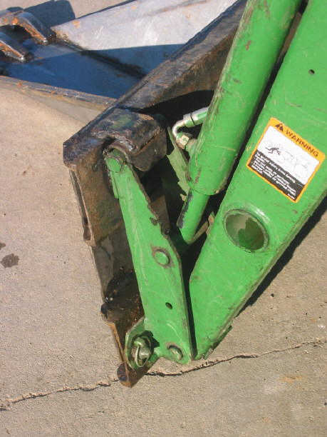

This shows the JD method of quick attach. I had talked earlier about my concern with welding the pin on because it is turned down to 3/4" and welded on one side only. This bucket was aggressively used in both curl and dump and no problems here.

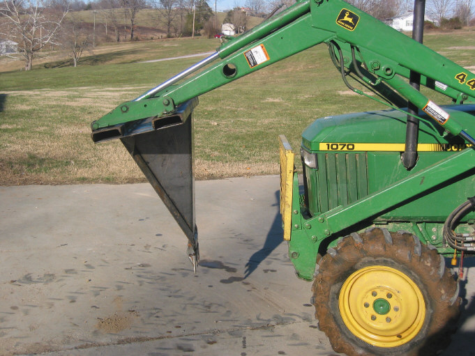

This is a direct side on shot showing that the bottom and the back are not at 90 degrees. I did not have any plans except for Randy's picture so I originally made it 90 degrees. I then became aware that the bucket wouldn't curl to level at ground level so I torched it down to about 75 degrees. This worked as we'll see in the next pictures.

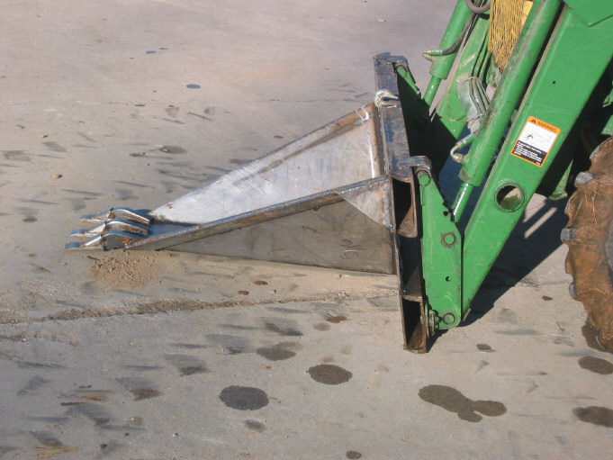

Here the bucket is sitting on the ground and at maximum curl the bucket is sitting perfectly level. This is more coincidence than anything but seems like a good target parameter in hindsight.

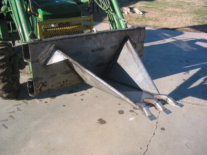

Here is maximum dump. Seems like 75 degrees works. One of the first projects was burying some roadkill and this dug a deep hole quickly. Covering up was done by switching buckets.
