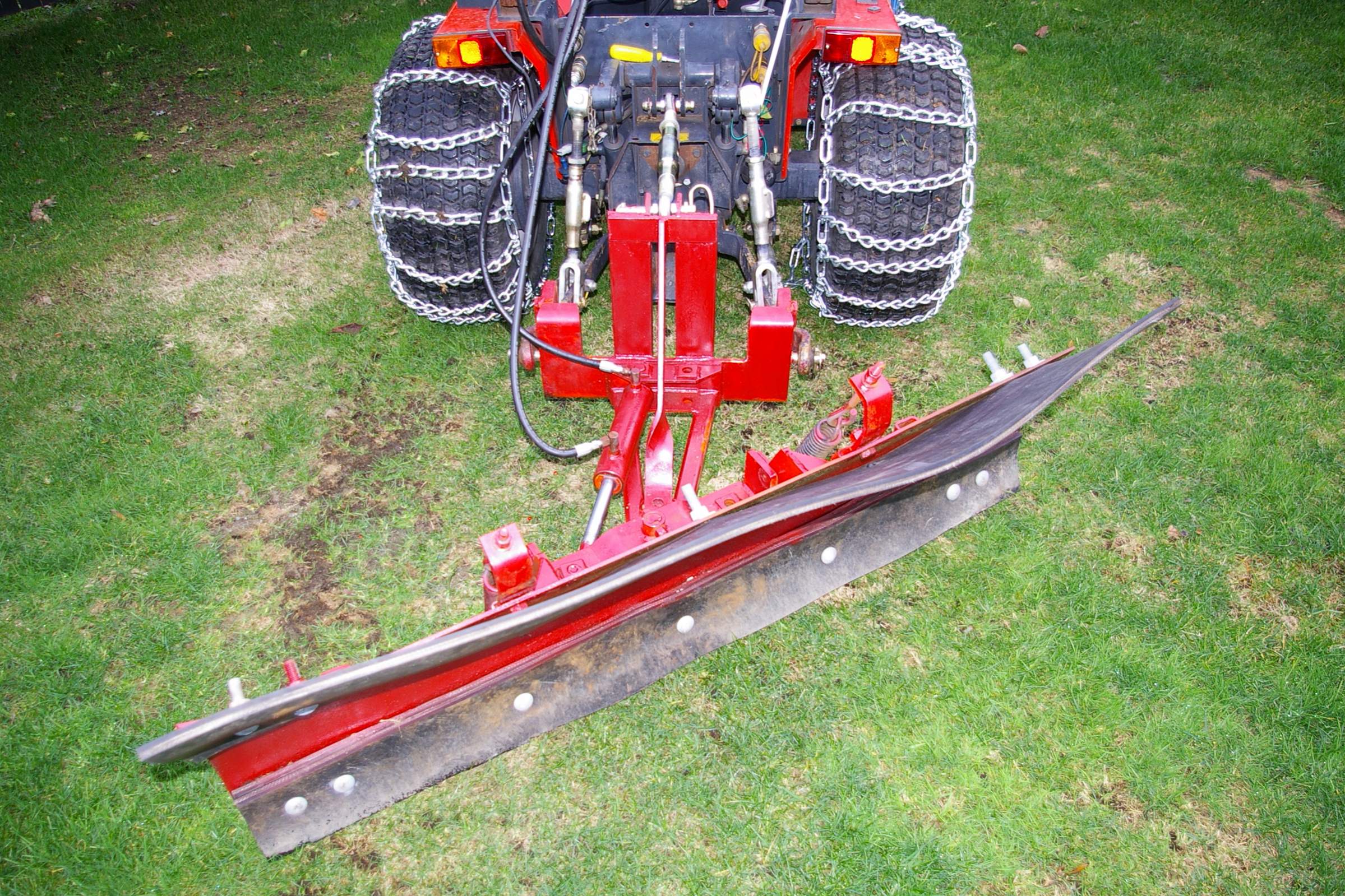

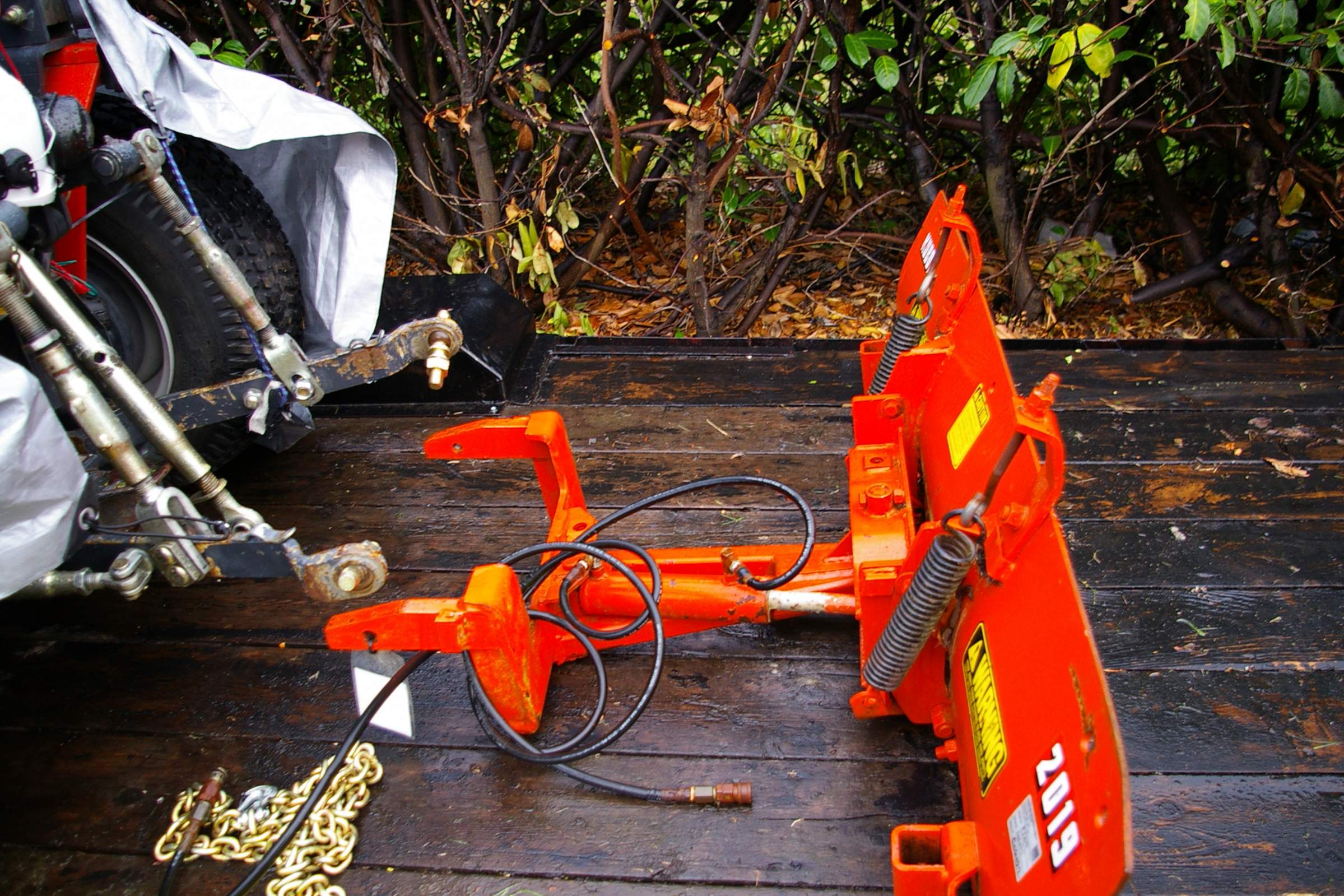

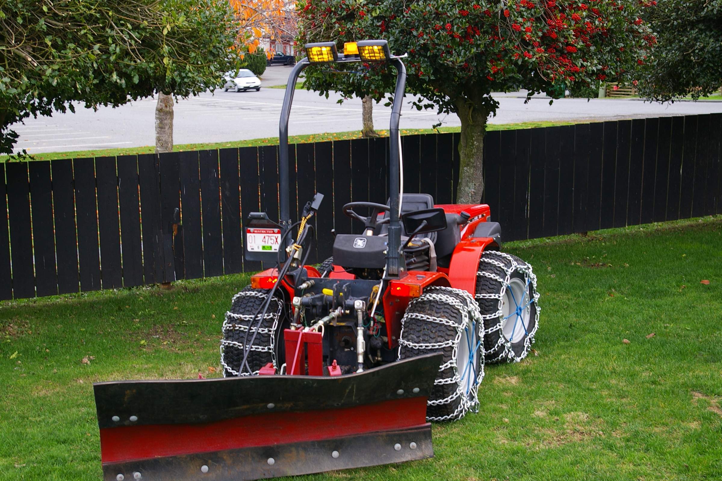

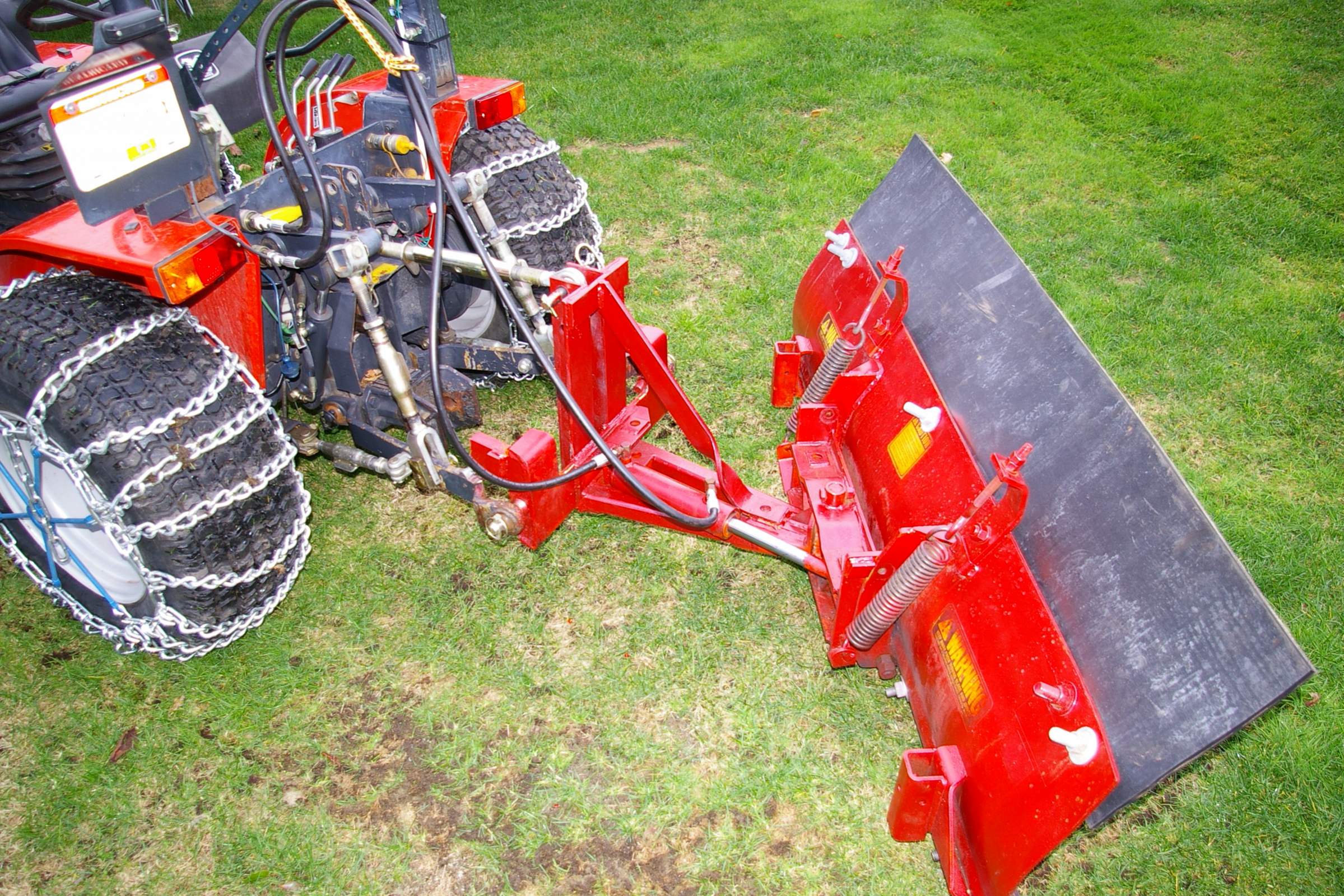

Just completed my plow conversion the other week. Really proud of it as it was some time in the thinking department. While I was thinking my farmer freind did the welding and did the job. Standard 3pt config. put some rubber top and bottom to make it easier on the fancy driveways. Just got the chains in the other day to give her some bling:D
