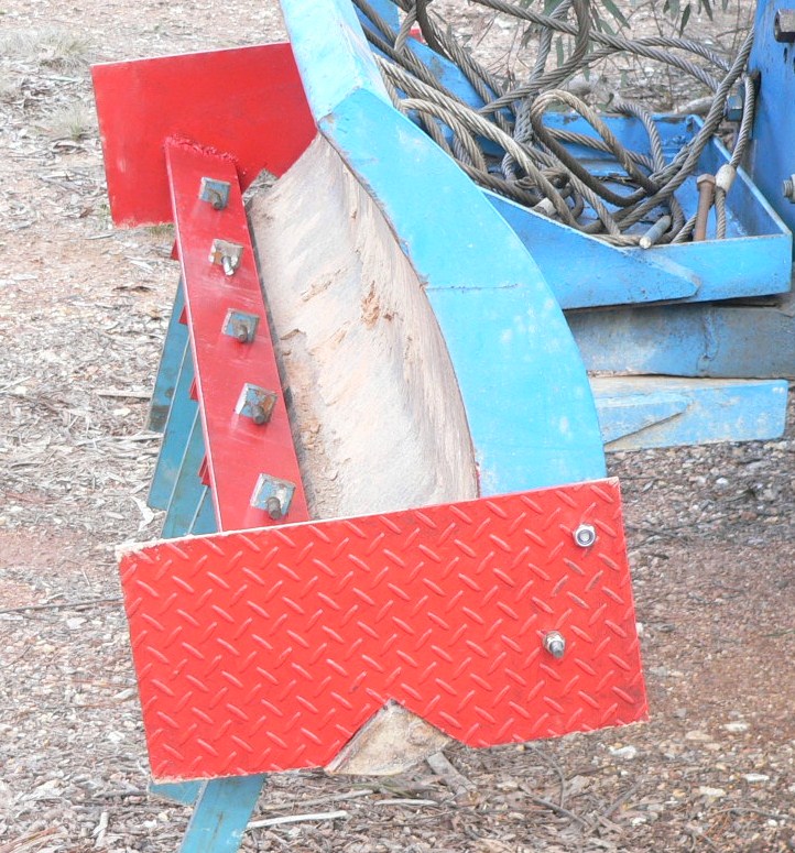

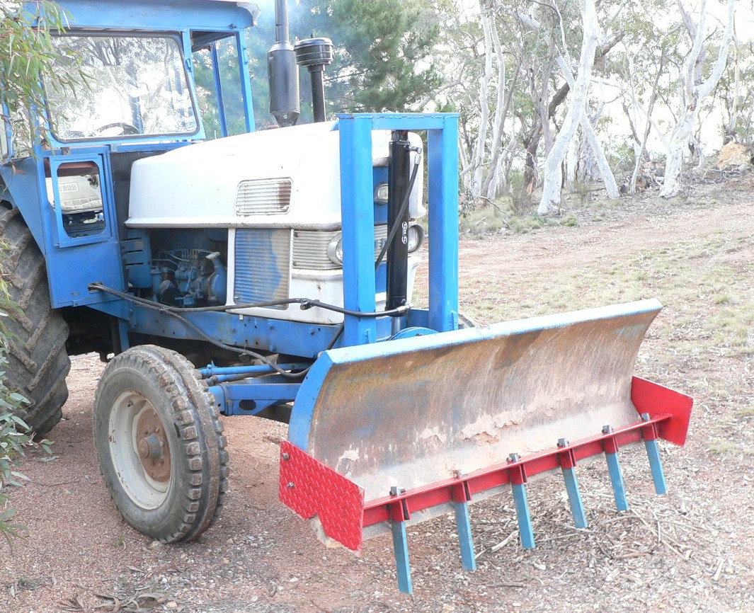

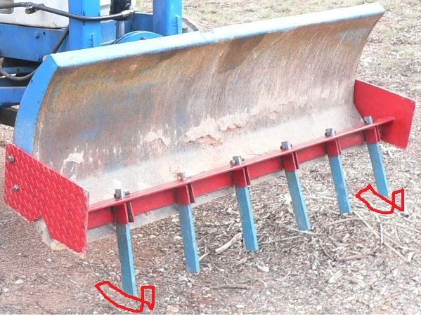

I needed a rake to stack tree rubbish after cutting out the useable firewood. The front dozer blade on my Ford 6000 of course pushes earth and even lifted slightly is not very good for pushing small stuff. The rear blade is impractical for this job too so adding a rake to the front blade seemed the best option

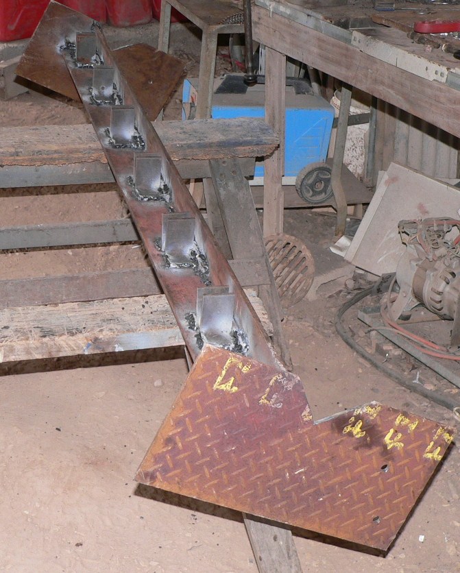

There were several builds posted on this forum but you go with what you have - in my case a FREE length of heavy angle, some 1/2" chequerplate and a couple of lengths of 2"X1/2" flat bar. The total cost was a few bolts, welding rods, power and paint
It all seems fine - the angle is hard up against the blade and sits on the slightly extended cutting edge of the blade so it can't go anywhere. If it needs more reinforcing, I'll just weld on some additional brackets.

I suspect it will fare better if the teeth are about half the length you have now. As long as you can keep the bucket above the ground to reduce the amount of dirt you would collect. Let us know how it works out.:thumbsup:
If it were me, I would consider using the side plates as skids to help control the whole thing as it slid across the ground. Similar to a land plane grader scraper skid that would help gauge the depth and eliminate gouging.

The ground here is very rough and that is why I left the teeth so long to provide a lot of clearance between the ground and the blade. They can certainly be shortened if necessary after some experimentation.
Any suggestions about the best way to turn the side plates into skids? I guess flat bars with the front end bent well up might do

G'day....
Great build.... Sometimes quick and easy builds are the most useful.....
When you have time, and with that size tractor, I presume you have a good sized back blade with angle capability....
You might want to invent and build a set of short brush teeth for the blade, and skids to limit the depth it would dig in the ground..
With a wider back blade you may have more reach and easier to move brush to piles etc...

The 6' back blade can be angled laterally so the idea of adding some brush teeth and skids could be useful.
The previous suggestion about adding skids to the new front stick rake side-plates does not look to be simple. While nothing is imposssible, these plates are well clear of the ground and it would be necessary to extend them down to skids at ground level and they would probably need to be adjustable for height. Also the entire weight of the blade will be on them

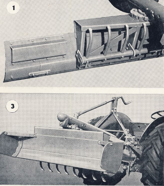

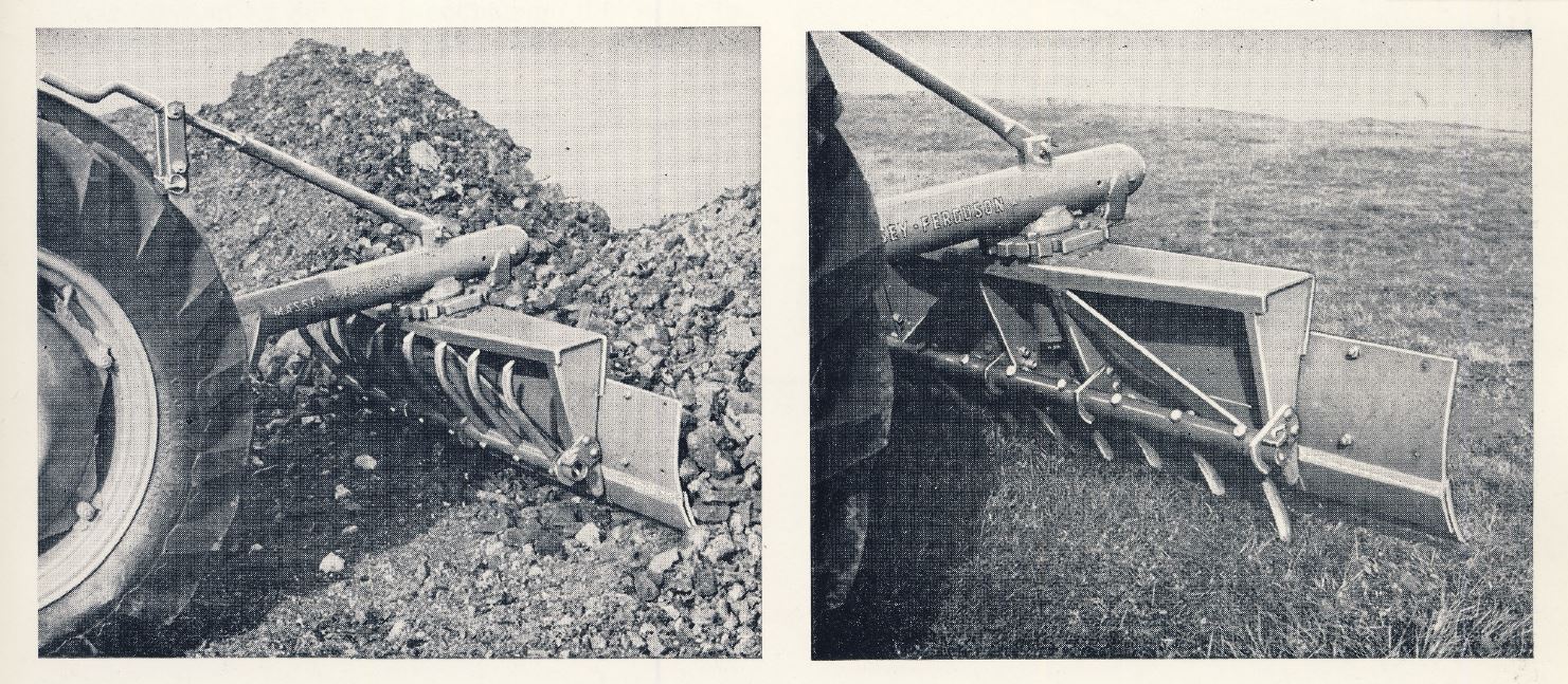

I have the same back blade here in the USA! It is a Massey 21, they came with rippers that mounted on the blades frame in the rear. To use them you swung the blade around and lowered the rippers.

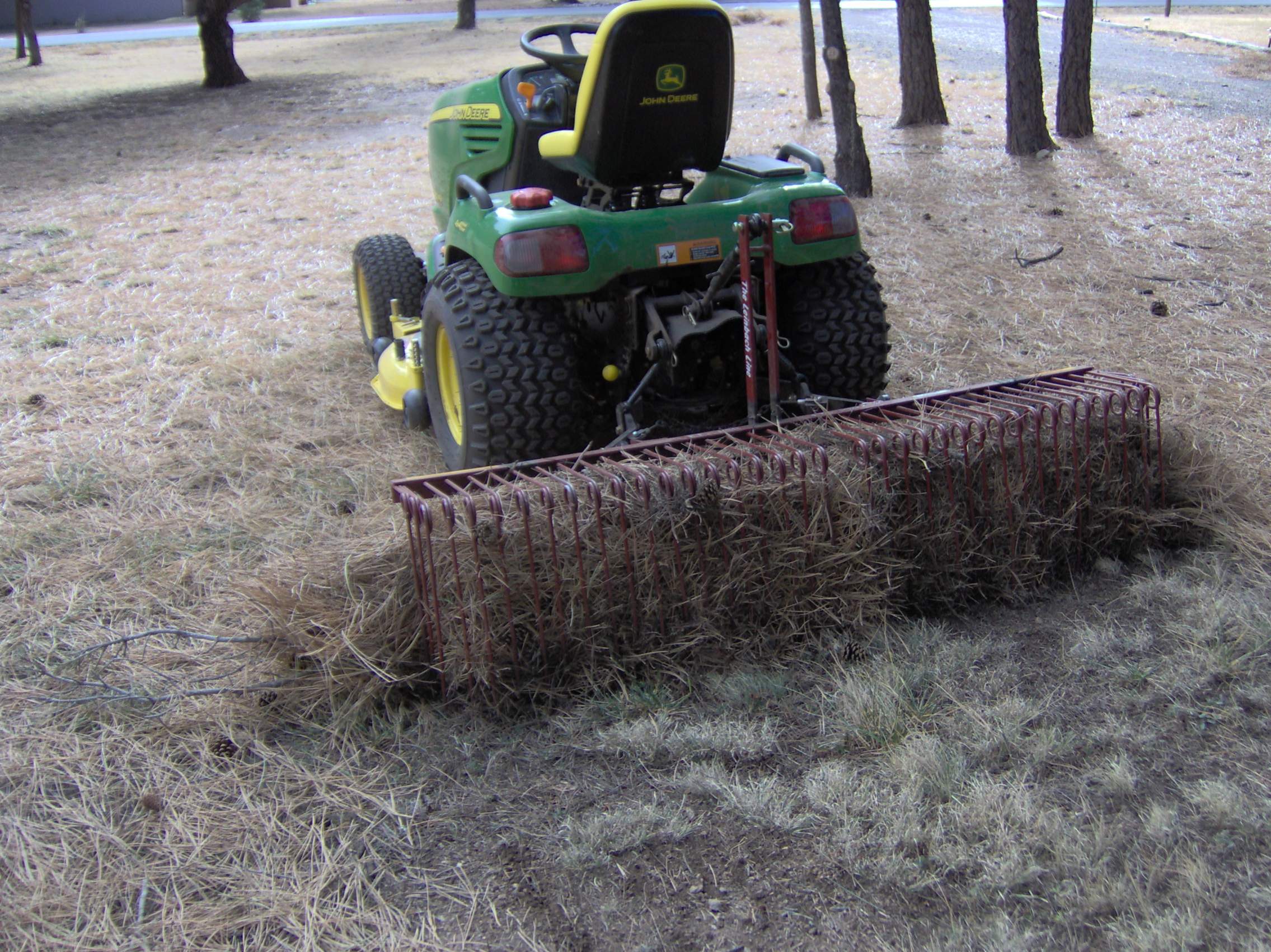

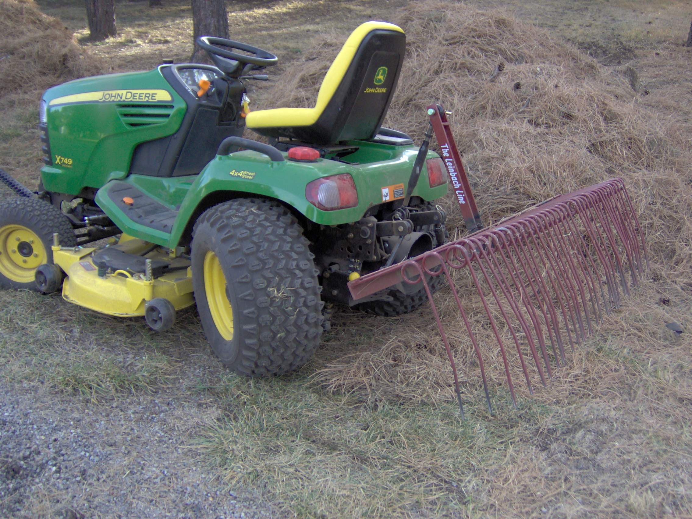

Gathering sticks in bottom land fields is something I have to deal with frequently. Spacing is important as it is very easy to get them too close together and gather dirt with clumps of sod. Round rod or flat bar on edge as you have is better for this than a landscape rake. Too much surface area and you wind up carrying dirt.
Small sticks, stuff that flows through your teeth can be gathered with a pine straw rake which has 2" spacings and smaller tines guessing 5/16" rod. That said I would really like something made with heavier tines maybe 1/2" but similar in design.
Here are pictures of the land plane and skid when I built it and a pictures of a pine straw rake for reference. This is an older Leinbach rake but I recommend the newer EverythingAttachments rake with replaceable tines.

Re skids, Jenkinsph pictures are excellent and 3' long seems about right, so does setting them just an inch or so below the teeth. I'll have to work out the best and strongest way of mounting them to do this and a "wrap around" plate welded to the existing side-plates with some internal reinforcing would probably do the trick. Making the skid height adjustable might also be feasible because adjusting the height of the teeth is not as simple as drilling extra holes in each one because each has a "step" cut into it below the angle iron mounting plate to prevent it from lifting. I think it will be better to work with the device for a while, then cut them down is it proves necessary
I think the skids should NOT be extended forward beyond the alignment of the teeth because that would inhibit pushing branches etc longer than the blade
Adding "brush teeth" to the rear blade like the Chinese ones doesn't look too hard to do. They would certainly help the cleaning up process without scraping earth so I'll probably make this addition. The idea of side plates (wings) is a great idea thanks. I do not need rippers on this assembly because I already have a separate single tine ripper for heavy work (though that means changing the entire rear assembly).
Potential damage is likely to occur only to the teeth themselves (the reason they are removeable). The main blade has been bashed about many times during its lifetime and apart from scars, shows no sign of real damage
Thanks again guys - will keep you posted on developments (might be a while though)

My blades does not have the rippers or extensions. I keep looking for the extensions but have yet to find any. I filled the rear of the blade with concrete to make it heavier so that I would actually cut.
Here is a snip PDF of the sales brochure for AU. I tried to upload the brochure but it was to large and the website I got it from is no longer functioning.MF21 ripper.JPG There are side plates that can also be bolted on to make the blade wider and end plates that can be bolted on to make it a box blade.
