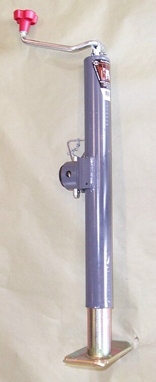

   / Another Tiller Question #4
Can we please see a photo of that parking stand? Mine is now sitting on its front side, rolled over as I pulled away last time, and a parking stand would be great.
thanks
   / Another Tiller Question #5
I bought a trailer type jack stand when I bought the tiller. I then welded the stand to the side of the tiller. I drilled and bolted a treated 2x4 about 2ft long to the foot of the stand so the tiller would not tilt in either directions. It sure makes it easier and safer to hitch up to the tractor. Once I am hooked up I just pull the pin out and remove the jack. I have attached a photo of the stand, and I will take a photo of the tiller next time I go out to the farm,
