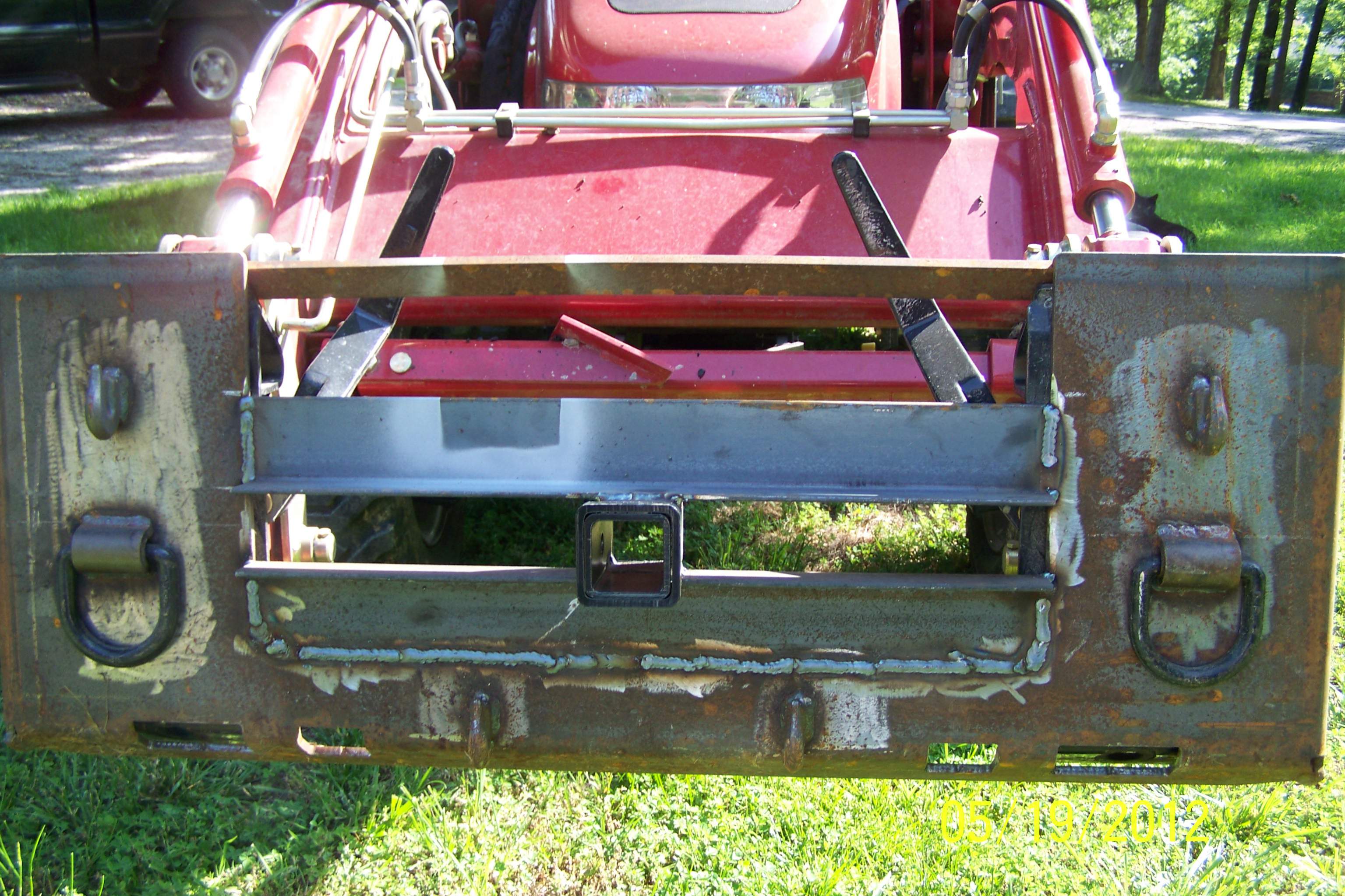

I bought a Construction Attachments tooth bar thru Everything Attachments. All I had to do was give them the inside dimensions of the bucket, eg. my 5 ft bucket was 59-13/16" inside measurement. They will make it to fit your bucket. I have used it and abused it. Best thing I have for cleaning ditches of fall debris.

Sem, I'm not quite sure what you mean. I made it so it would bolt to the side of the bucket. Rhino, I bought the beveled bar through a local machine shop, it is 1/2 by 4". The teeth came from here. Tooth Bars and Teeth | Skid Steer, Bobcat, Tractor Attachment | Quality Welding Service
I think he meant the front edge of the steel bar that sits inside the bucket. The one the teeth are welded to. I too see the front edge is beveled, and wondering how it was done.
I had to buy the bar already bevelled from a machine shop. I think it came from the mill that way.

Congratulations on the advancement of your welding skills since
you made the top plate attachments on your FEL! like night and day.
Empty holes and no plates or bolts to hold the Toothbar inplace.
It will fall off without side plates and bolts, but good luck with it.

So what's your point? Because I hadn't drilled the holes 10 mins after I built the bar I didn't make it? Look closely,there's plates on the side of the bar. I built the thing, if you have a problem with that, go to. I've made three more for friends of mine. BTW, I have welded quite a bit since the hooks were added to the bucket. Want some cheese to go with your whine? Apparently you have plenty of free time to complain about things you know absolutely nothing about.
