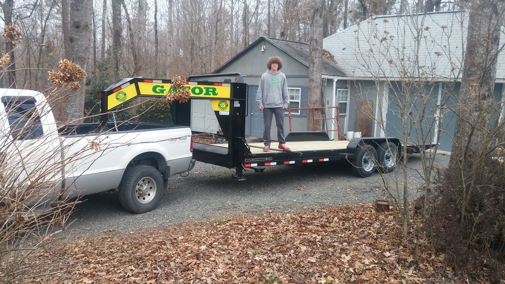

I am like you, I went with a 16K 20' + 4' tilt bed. The 4' stationary is big enough for my needs and I really like the low bed tilt. easy to load anthing including my wife's Can-Am - Spyder 3 wheel motorcycle.
The Gator has a much stronger gooseneck made out of 12" "I" beams and the frame is all 6" square tube.
It's a beast that's easy to handle.

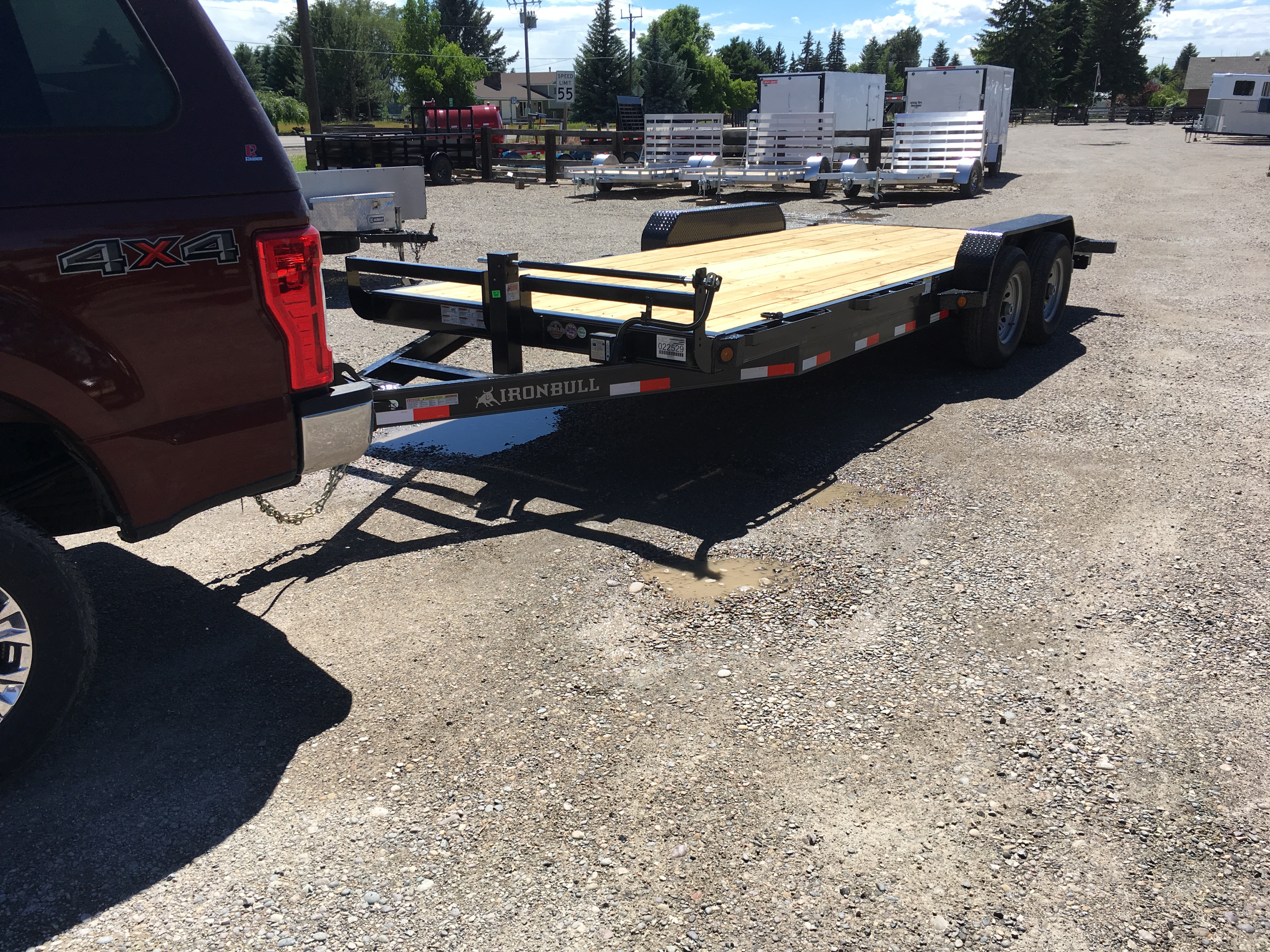

About 3 weeks ago I went and bought a new trailer. I have been pretty busy since so I didn't post anything about it but here is a quick picture I took of it at the dealers place.
I had heard of the Iron Bull Trailers but hadn't seen one before this one. Apparently they recently got into building the car/equipment hauler type trailers. The dealer had both PJ and Iron Bull trailers so I was able to directly compare the two. From my understanding, PJ trailers are one of the better trailers but after comparing it to the one I bought I feel the Iron Bull is a little better trailer.
It is a 14k 7'x20' with a dovetail. 4 bolts hold on the fenders so they are easy to remove if necessary. It includes stake pockets, rub rails, pipe spools and D-rings for tying down loads. The 10k jack is bolted to the front of the deck but can be moved towards the front of the tongue easily if I decide to install my winch at the front of the deck. Plus I chose to get the slide in ramps rather than the fold down ones for my purposes.
The dealer spent quite a bit of time showing me how the PJ and Iron Bull compare and made me a good price so I pulled the trigger. Maybe this weekend I will get a chance to load the tractor on it.

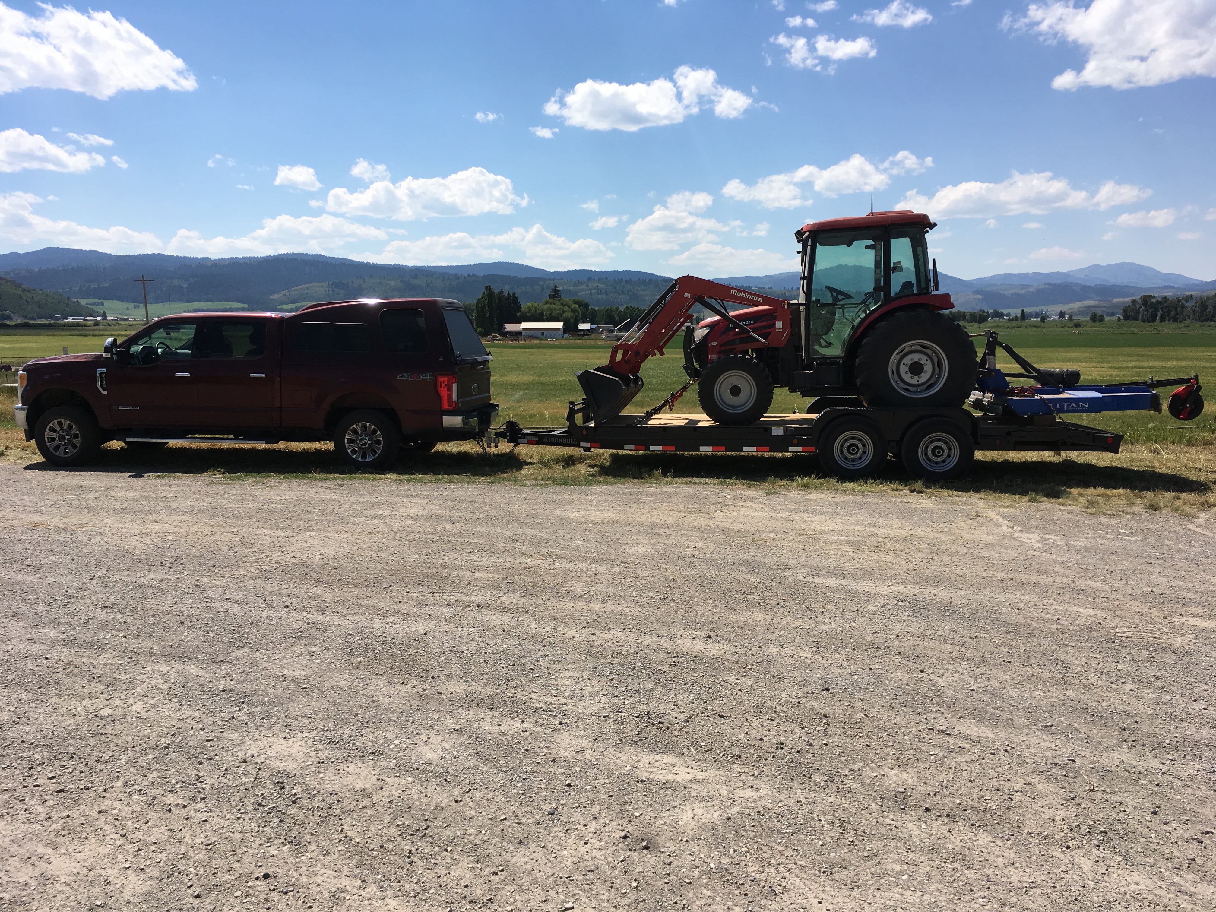

I finally had a chance to use the trailer. We needed the weeds mowed around the shop so I brought in the tractor with mower to get it done.
It hauled like a dream on that length trailer. It would be easy to forget the trailer and load was even back there.
