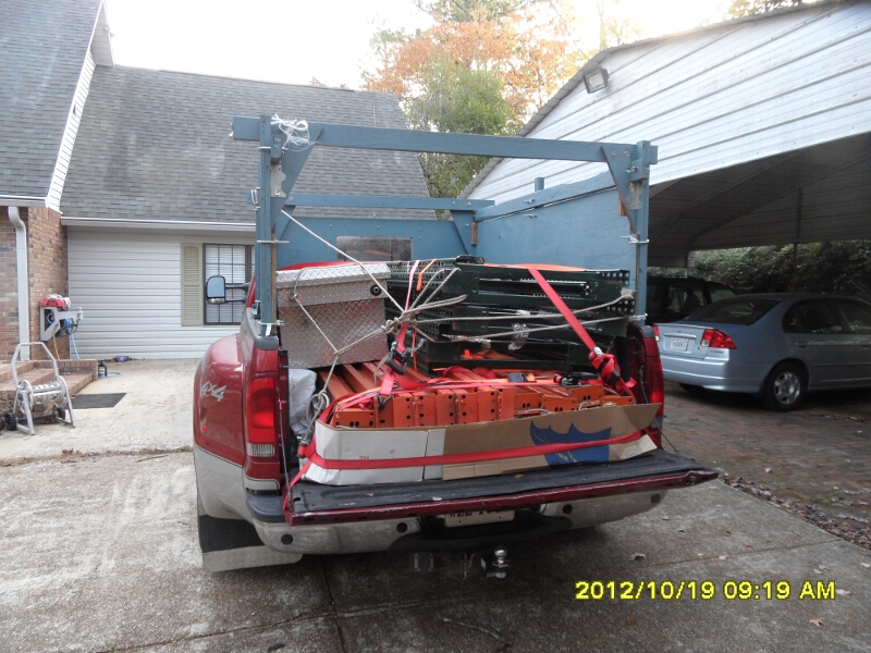

As soon as I heard the noise I knew something was wrong and pulled to the side. My F350 was partially loaded
with about 1800 lbs of pallet rack and I didn't notice any "pull" on my dually until I got the tow dolly off the pavement and the axle stub started "plowing", even then it was only a slight pull. I first thought a chain or something had broke and was dragging, not the entire dolly. I left a groove in the asphalt about 50 to 100 yards long.
