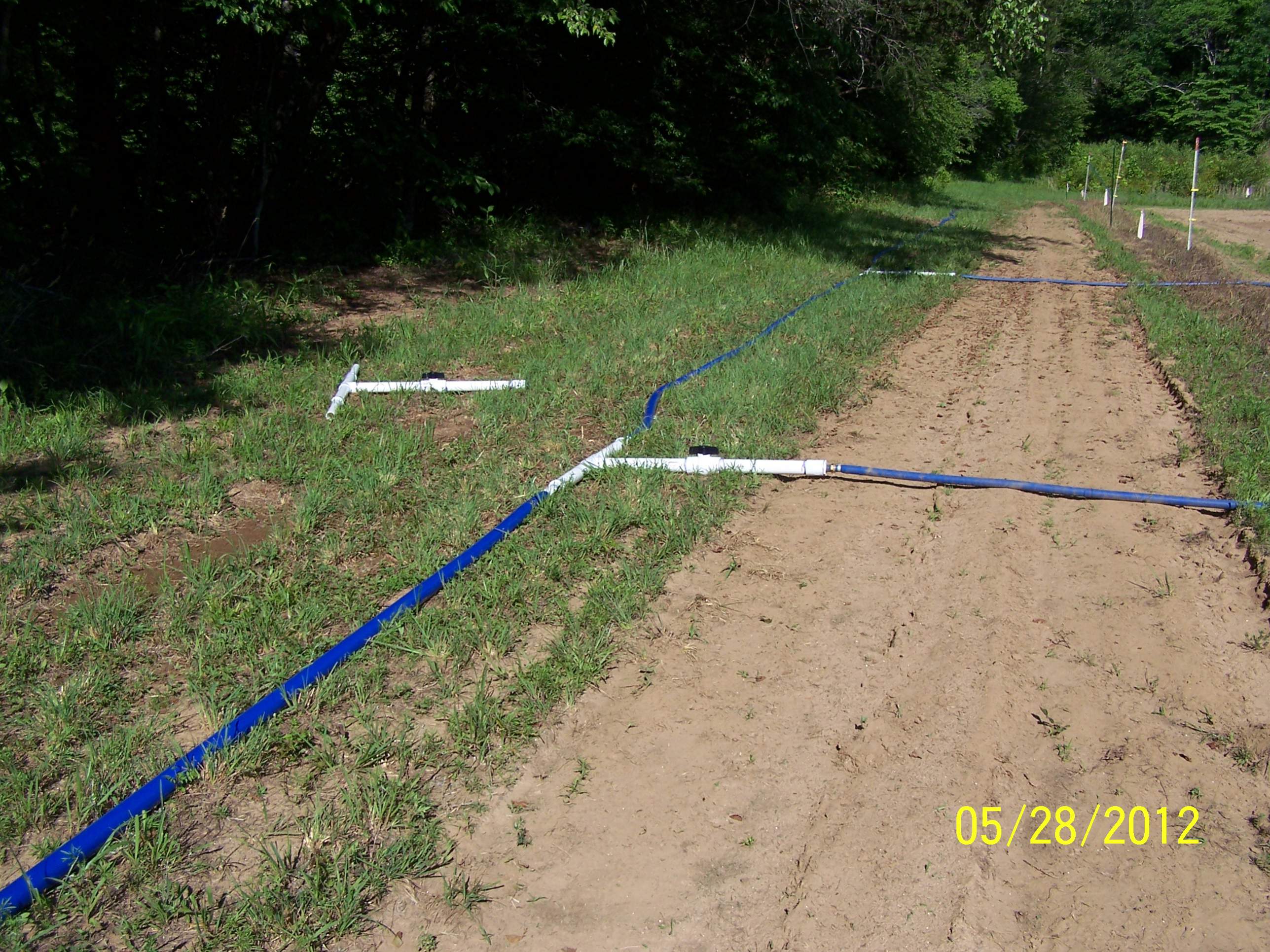

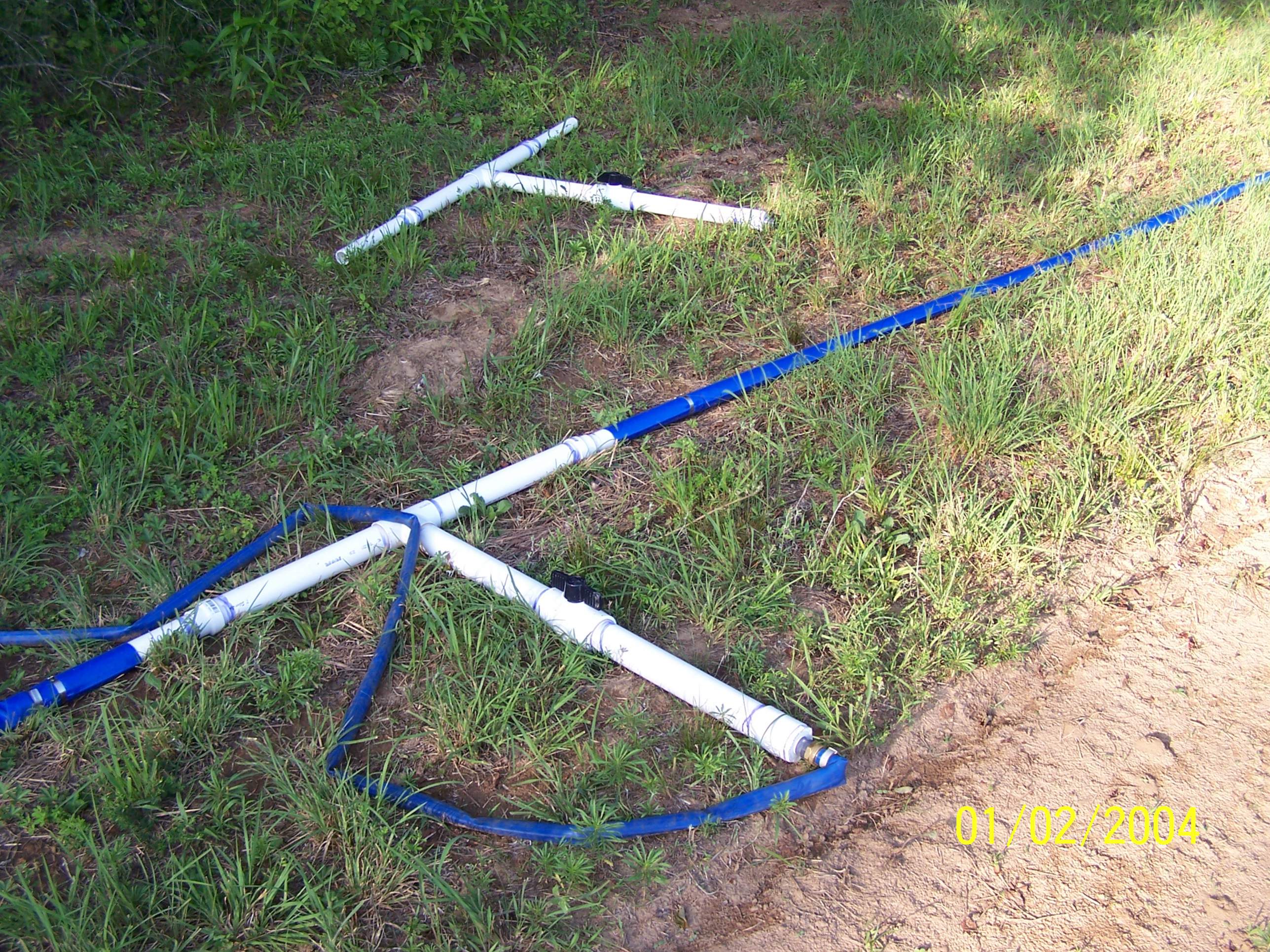

My pump has 350 feet to pump/push the water before it gets to my irrigation lines. From this point my sprinkler heads are 75' to 125' away from my main 2" line. I run 5-6 sprinkler heads at 3/4 throttle with a 5hp pump.
Here is a couple of pictures of how I T-ed of the main line.
