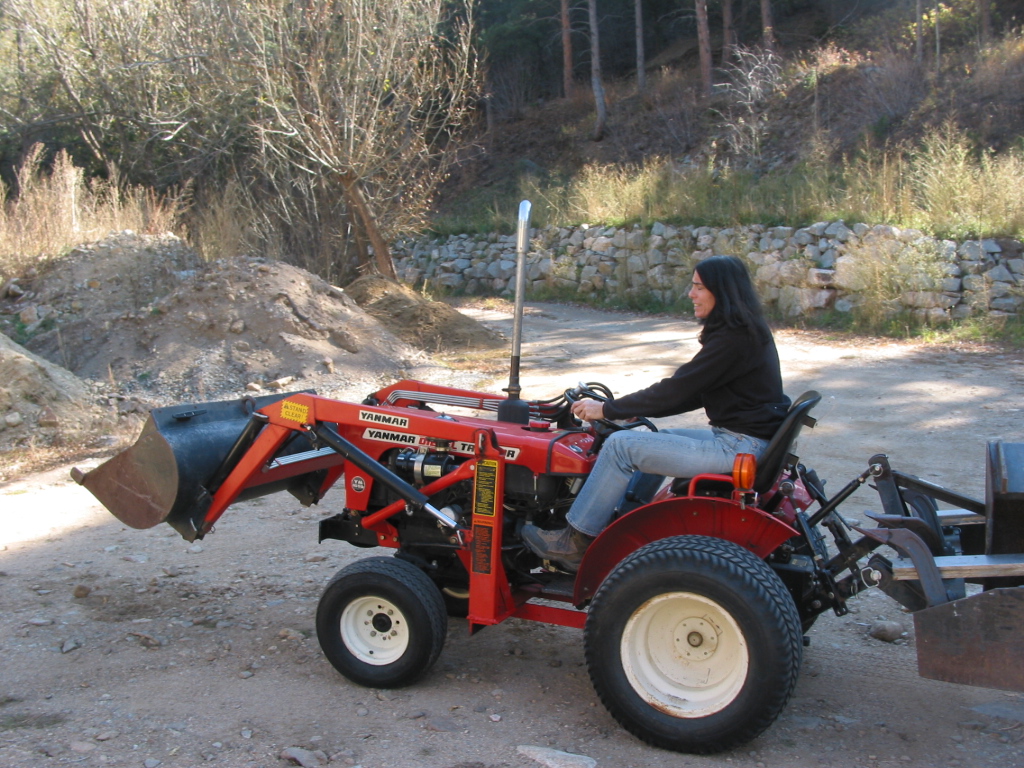

Yeah, that's funny. I wonder what most wives would make of someone saying that they are the reason to go with HST. Wow....such a statement.
My 125 lb. wife would be a seriously dangerous critter to be around if I suggested that she couldn't work a clutch as well as any guy.
In fact, she specified standard shift when she bought her own new F250 PU. Plus diesel & 4wd of course.
Yes, she did go along to buy the tractor....& even test drove several. But that was clearly my idea; not hers & not her interest.
She was a low to medium good sport about tagging along looking at tractors, but she clearly felt that choosing which tractor to buy was my job.
However, she loves that tractor now - and she particularly likes the backhoe with thumb. Says that the backhoe with the thumb is just about the best thing we ever bought. And a necessity with our aging backs..
Not that she drives it, but I've heard her talk to her friends about what a good thing it is to have.
Bottom line is she likes for me to run it. I've rarely been able to get her in the seat to to work it - just enough to know how.
I guess tractoring is my job.
But her feeling for the tractor doesn't have anything to do with gear shift vs HST. Or the controls or anything like that.
She doesn't seem to care what kind of a transmission they have. It takes her all of about 1 minute to get comfortable with either, and she doesn't intend to be on it all that much anyway.
