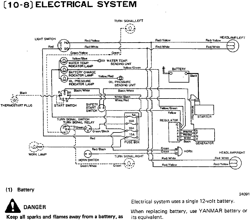

It wasn't a used Starter was it and not just new to you.A New or Remanufactured that would be replaced.The solenoid would be a good reason why. I have had them bad right out of the box before for cars. My guess Ignition switch or starter leaning more towards the Starter. Make sure all of the battery cables the ground to the tractor and starter connections are clean. Just had this out come to think about it may come in handy if you don't have it already.
Carey
