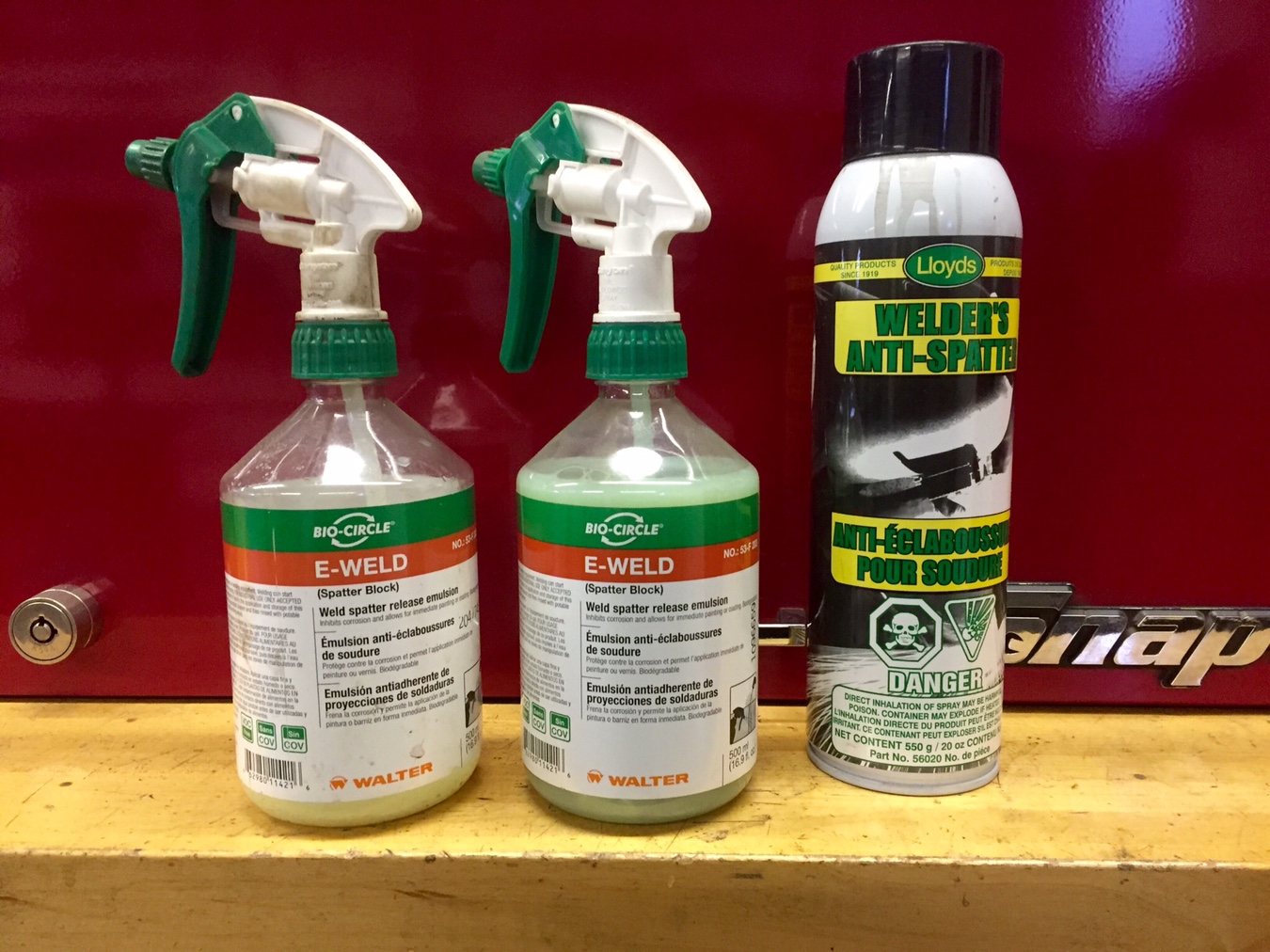

I like the Bio Circle product on the left which I get from my LWS. It’s nice that it is NON aerosol and at the time it was the same price as a can of PAM from Costco.
