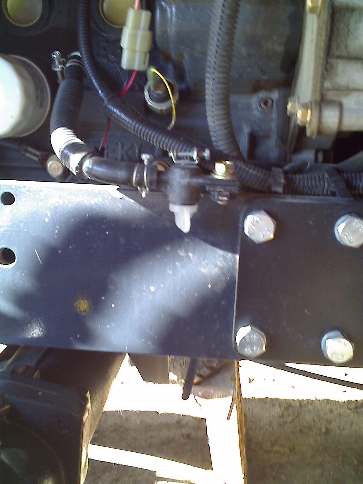

I picked up my antifreeze and I am ready to change it.:thumbsup: Problem is I do not know the easiest way.:confused2: Took a quick look under the Massey and did not see a drain plug.:confused: Is there one or what is the easiet way to drain the old fluid.:confused2:

There should be a drain cock below the rad. I know there is on the 1600 series, on the right side, below the injector pump.

Yes, there is a drain on the radiator.
I just pull the lower hose off, makes draining/flushing faster.

Mine has a drain that you can see if you look on the left side (sitting on the tractor) It is mounted on the frame rail, look for a white thumb screw you will see one hose going to the block and one to the radiator.

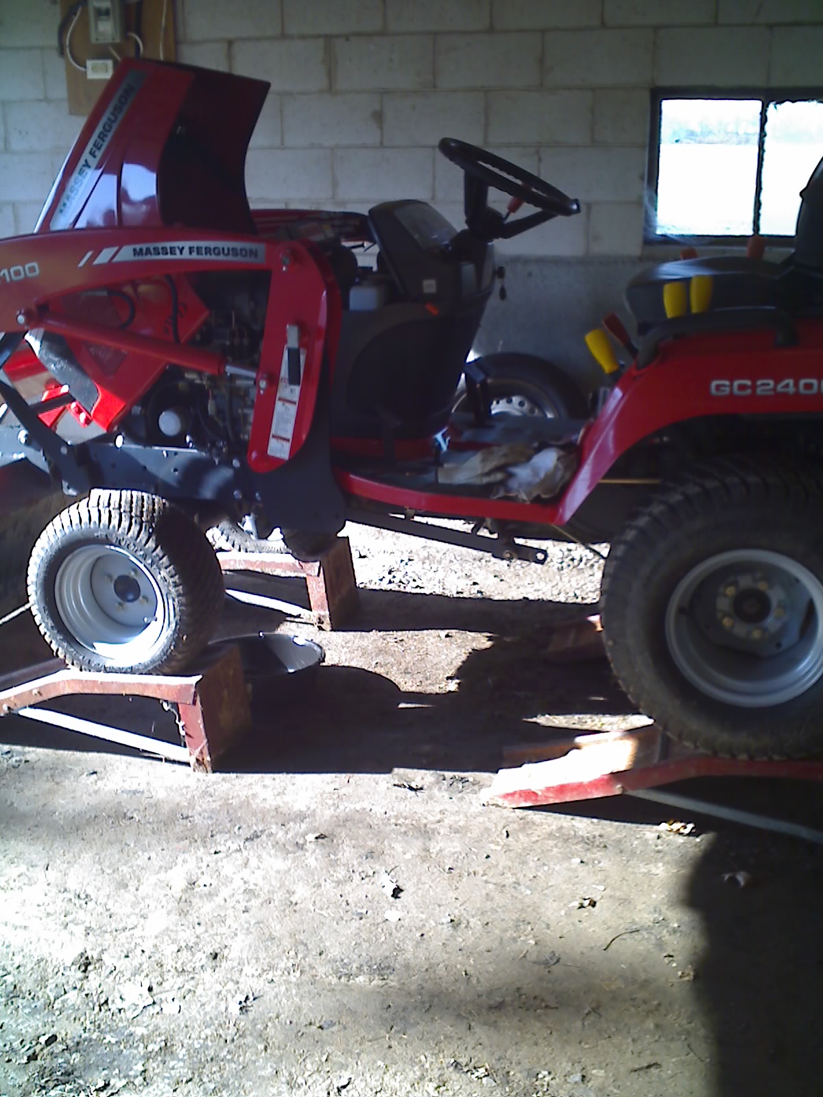

Finnally got around to changing my antifreeze.:eek: Put the tractor up on ramps just to make it easier to work with. Found the drain plug on the left side off the engine, when I looked before and didn't see it, it was because I was looking underneath the tractor.:confused2::eek:. Use Prestone for Diesel engine that I got on sale at TSC here in Canada.:cool:

Yup, that is the drain!!:thumbsup: Good job, easy wasn't it?
