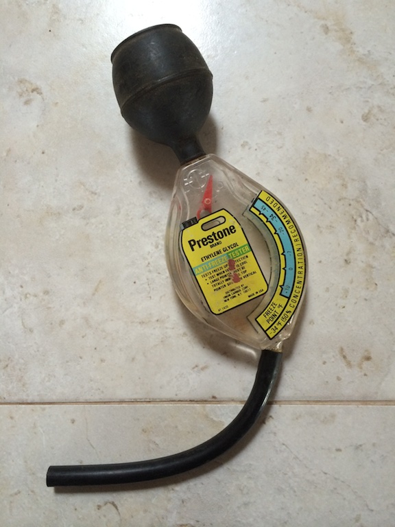

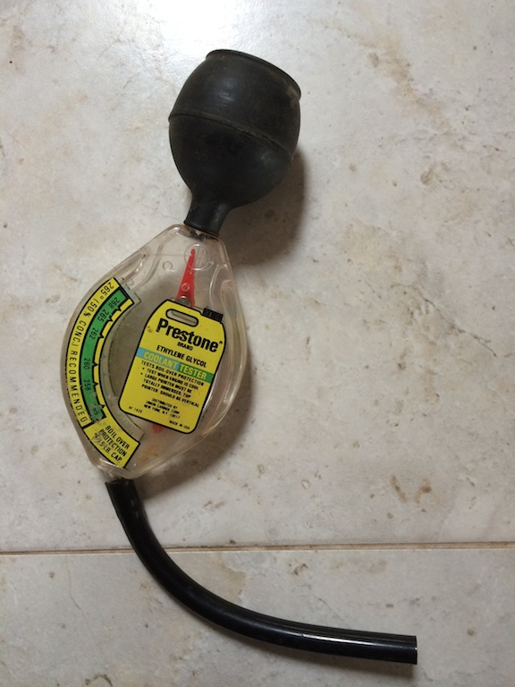

I use this handy little tool. Don't know how great it is but it tests both boil over and freeze protection. I think just the level of concentrate and it probably can't tell if it has lost its life though. But it helps me know if when I am alternating topping off with water or antifreeze, just where my ratio is.
The gizmo you have tests specific gravity I think, which is related to boiling and freezing point. They're not very accurate, probably better to measure the mixture accurately initially. I poked around online and found these, I think this is what my dealer uses because he said they were test strips.

right. well, unless you've been adding substantial amounts of water to the coolant and winter is coming ;-) however, there are tests for nitrite (corrosion protection) and pH (acidic buildup). these are generally test strips.
in vehicles and equipment that do not see extreme duty, manufacturers' recommended change intervals should be plenty sufficient. regardless of well a coolant tests, i change it at the scheduled intervals to clear sludge, scale and corrosion.
