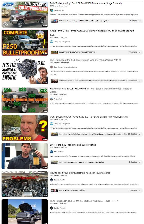

My 2005 6.0 power stroke has 205K miles, when should I get it bullet proofed?
   / Antifreeze #24
Sounds like you are keeping it i good shape (frequent oil & filter changes). If you can pull off a valve cover, check for sludge buildup by the oil returns. Look up 'bullet-proofing' the Ford 6.0 on the Web. There are 4 or 5 levels of changes that are suggested. My neighbor did it to his work truck after it died a sudden death (hydro-lock) out on the hiway. He did it himself: pulled off the cab, headbolts, and EGR cover plate, no more converter, straight pipe, special synthetic and runs water as a coolant. Lots of YouTubes about this. Tom spent $5k ON PARTS.
