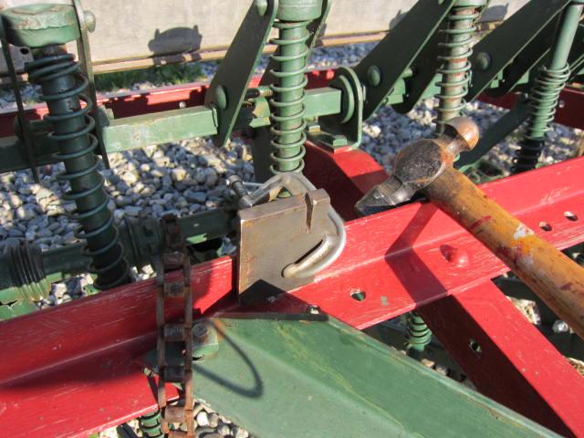

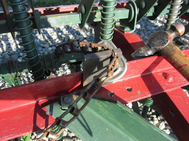

I took a 3"x3"x 1/4" thick piece of steel weld stock and cut a narrow 1.25" long slot using my 4-1/4" angle grinder with a cutting blade. C-clamp this little tool to the frame of the grain drill with the slot vertical, slip on of the links into the slot. Angle the adjacent link at 45-deg so the sides of that link line up with the gap in the end of the link in the slot (C in the figure above) and hit that angled link with a ball-peen hammer a few whacks. No problem--the links separate slick as hog poop.

need pictures......need input :laughing: :laughing:
Here they are
As I said, there's not much too it.
Hope this helps.
Good luck.
