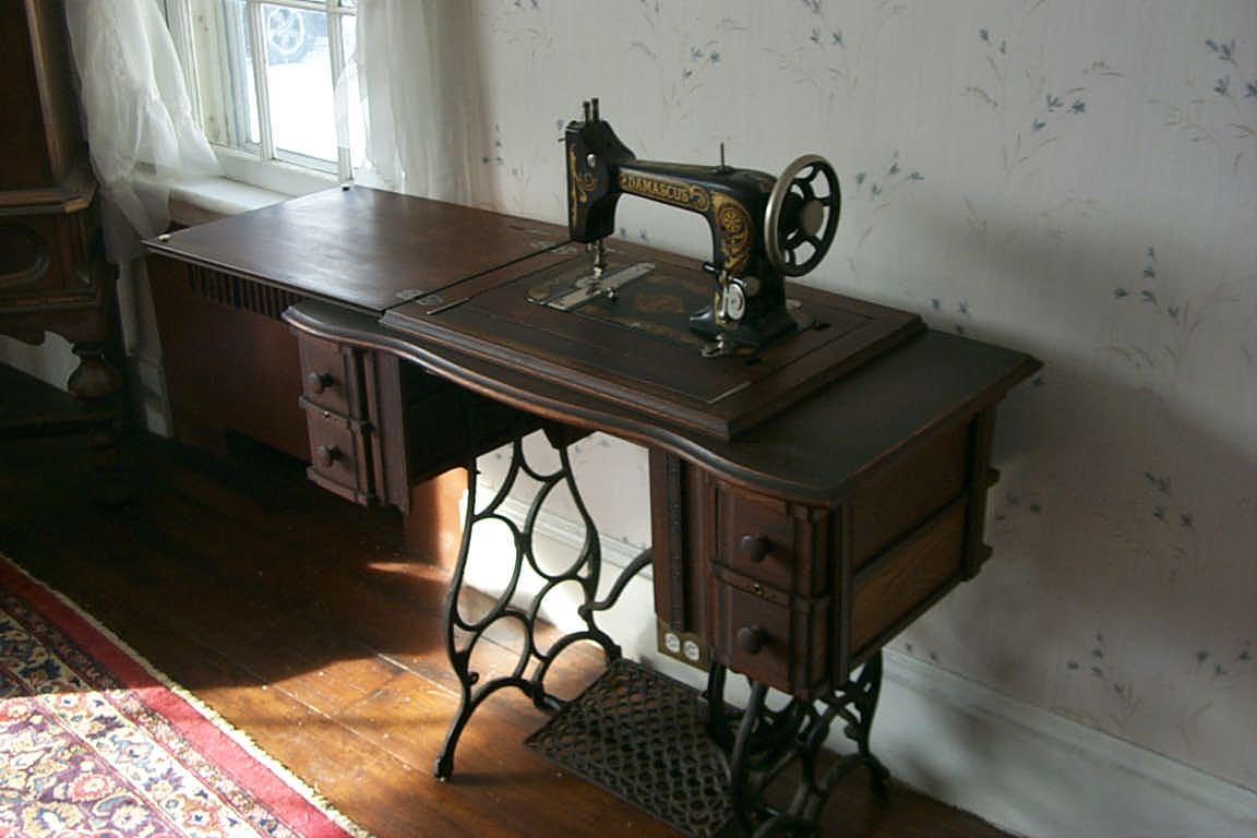

DAP -- My CEO restored a treadle 1903 Singer in much the same shape as yours. She used Ivory soap on a damp (not wet) cloth. Don't use one of those sponges with the scrub pad on one side! It took her a LONG time, but the machine looks great now -- complete with intact decals and that gorgeous black patina finish -- and it actually works!

As an antique dealer, I might get in big trouble for giving out this big trade secret, but here it is! /forums/images/graemlins/wink.gif If you want to get it real clean use hand cleaner! can't remember the name but its the white creamy one. Works on both wood and metal for removing oil and dirt! can just be wiped on and off with a rag. Then just give it a wax job and oil it up and your wife is ready to sew! /forums/images/graemlins/grin.gif

My wife owns a perfume company, and gets display boards back from stores and refurbishes them. They have all kinds of oil-based stains caked all over them.
The ONE product that seems to work above all others is "Citrisolve", or one of the other citrus-based cleaners. Will even take black magic marker off a light tan carpet.

Would that hand cleaning product be "GOOP"? It is definetly good for things other than cleaning hands.

Pete ... I tried some Dawn liquid on this thing to begin with. After a minute or 2 I started to get a lil shine. Later, after letting some parts soak in solvent, I accidently dropped a drop, literally a drop, of ammonia on the part I had just done. Wiped it off and said "Chief, you're gonna need a bigger boat" kinda expletive. Basically, the Dawn just cleaned up the upper most layer of CRUD! This thing is DEEEEURTY.
I picked up some Turtle Wax Tar, Bug and Sap remover and this did get some of the scum off the decals without dispensing with em, but could not disolve whatever the heII is on the enamel.
Next challenge is to find a drive chord for it. I'm guessing the originals were rubber? Have to check with that place in Hebron Ohio that sells this kinda stuff. Name escapes me.
Lastly I got the treadle freed up and spinning like a top. The iron work is filthy also and I'm praying to god it isn't black enamel also. After about 20 hours on this puppy now, I can say this emphatically, AMMONIA has proved it's mettle, but it eats the decals for breakfast.
Perhaps I'm grossly underestimating the amount of cleaning passes this thing needs. 2 COMPLETE rolls of paper towels and I'm still at what appears to be square one, except for about 30% of where I did the ammonia thing (un-decaled sections). Anyway, it looks a LOT better than when I started ...

After a lot of cleaning both the machine and the wood and iron .... just need some old bobbins and a treadle belt.
