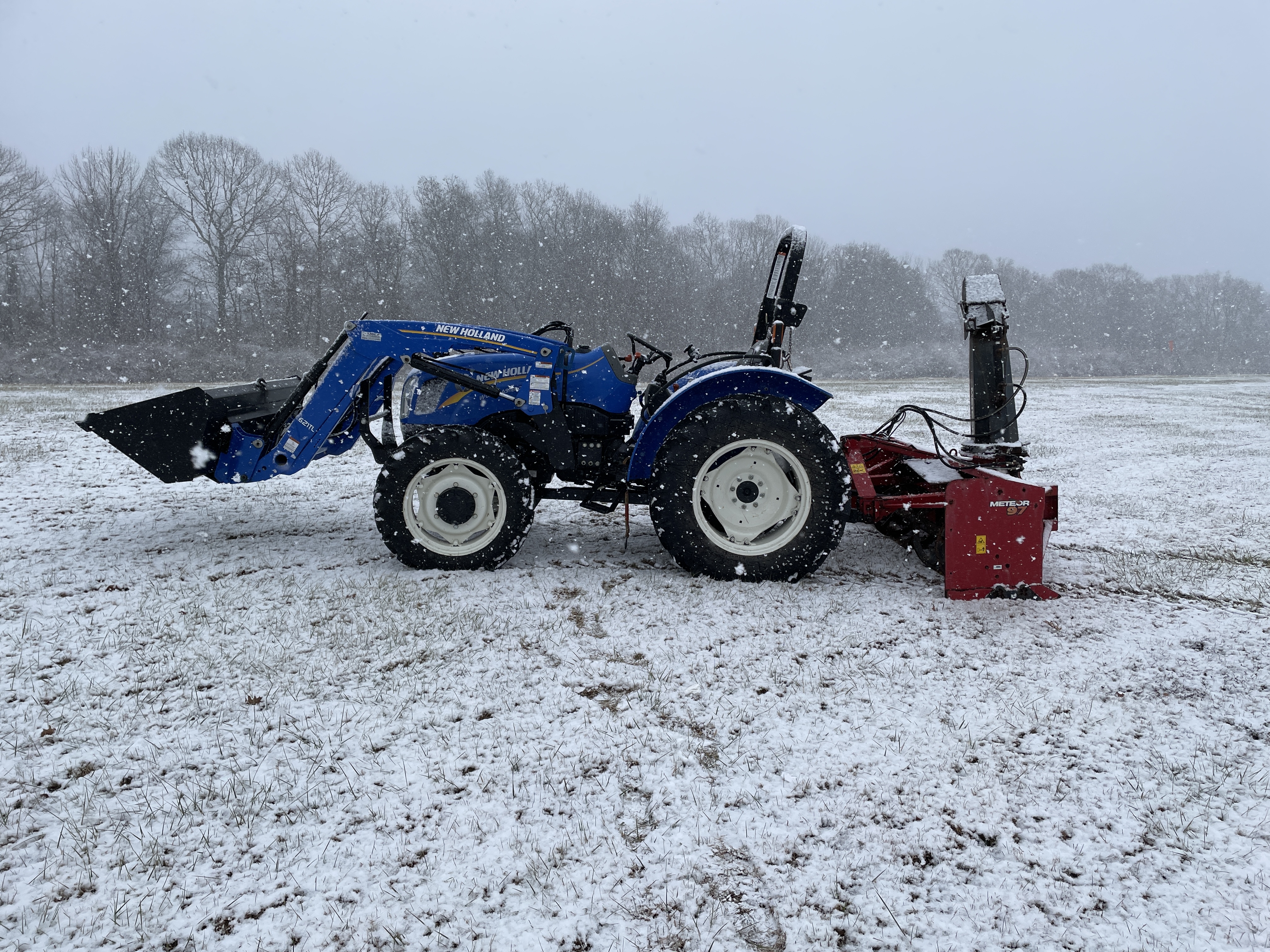

Mark thanks for the reply. Probably take me half an hour to take off my loader, but I’ve never done it.
Don’t know if I could give up my loader’s 3500# at max height or the versatility of running a blower and a bucket or mower and a grapple.

Don’t know if I could give up my loader’s 3500# at max height or the versatility of running a blower and a bucket or mower and a grapple.View attachment 2410313
So how are you liking your pull type snow blower ? I never even knew they existed until reading about them on this forum.
