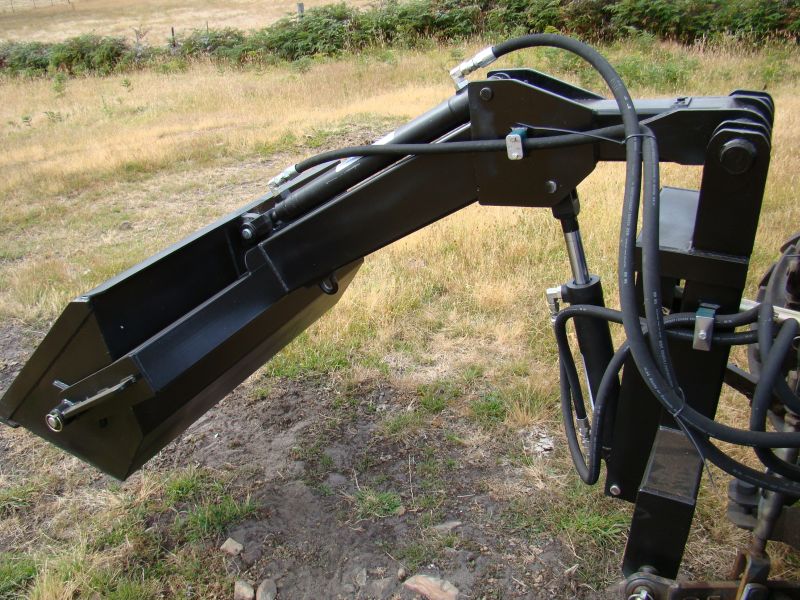

My AC Tigretrac has done over 3000 hrs. Only problem I've had was stripped gears on the front drive (caused by a lousy mechanic doing a clutch replacement).
It's absolutely unbeatable for hillside work. I love the reversible control set up. I've fitted it with a rear loader (Cadloader made by my neighbour who's a pro welder).
