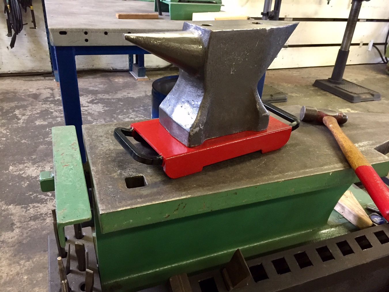

Friends who own one of our local scrap yards no longer allow sales partially due to liability issues. However a few years back they presented me with this little 66 pound anvil they came across.
It has a nice ring and excellent (90%) rebound.
IMO you would ideally have at least a 125 pound anvil for knife making. And a propane forge would be a good way to go. Won’t even need to use your big tanks. The 20 pounders will do just fine.
