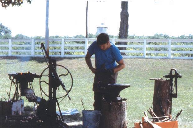

There is always a way to get the tools together if you work at it. A brake drum forge is straight forward to make. (on you tube. The hole in the center has 3 bars welded across to let the air in and keep the coal in the forge. You can use black pipe for the air inlet on fold and weld on your own design. I used cement to taper the edges to make a nice firepot bowl. Legs weld on to the firepot and an old cookie sheet or sheet metal is a good way to extend the sides to hold more coal.
The blower is the tricky part, but a hair dryer to an old squirrel cage blower from some old appliance/ventilation ducting works well. 3" is a good size to shoot for. - Makes an excellent forge.

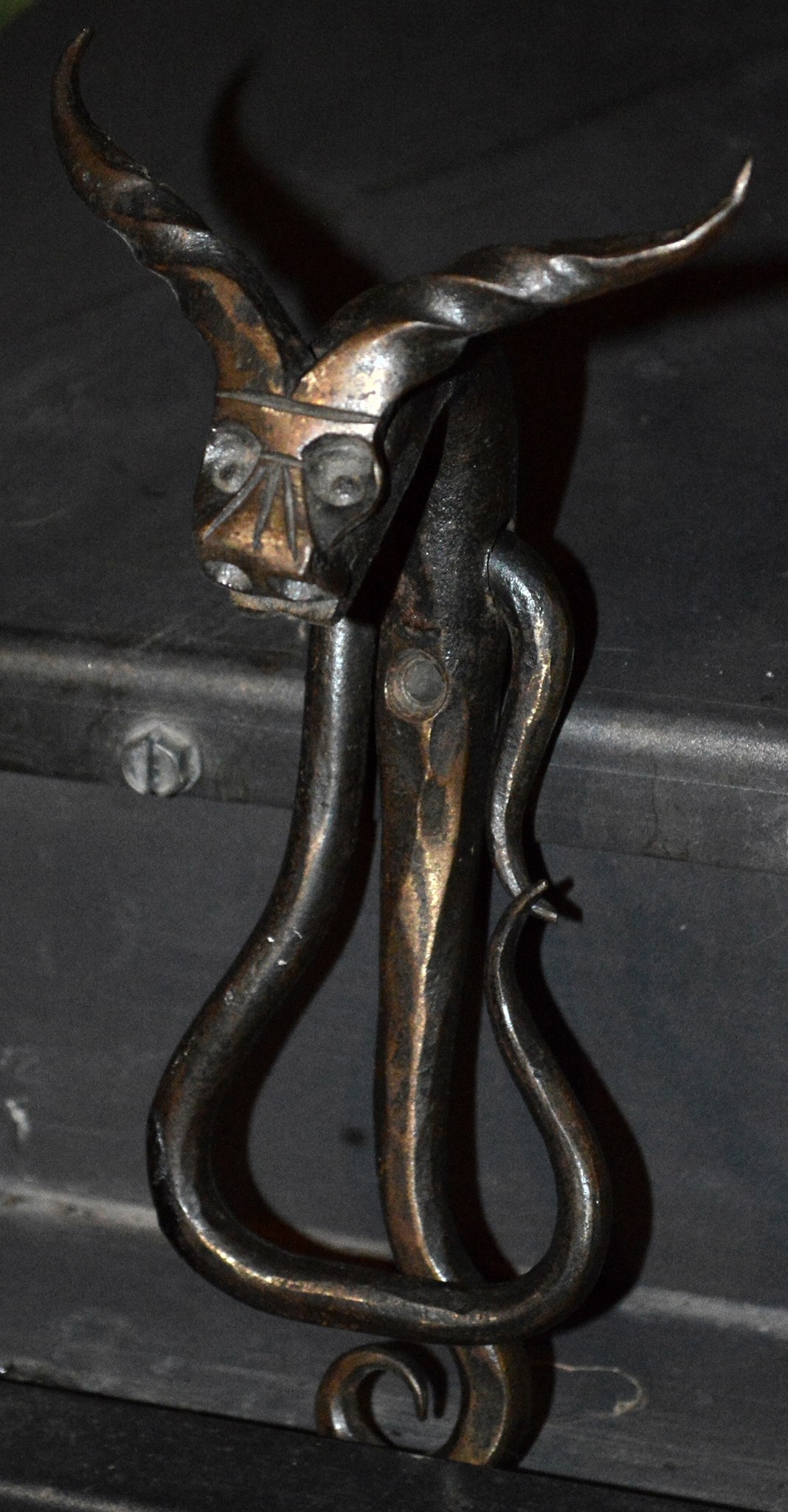

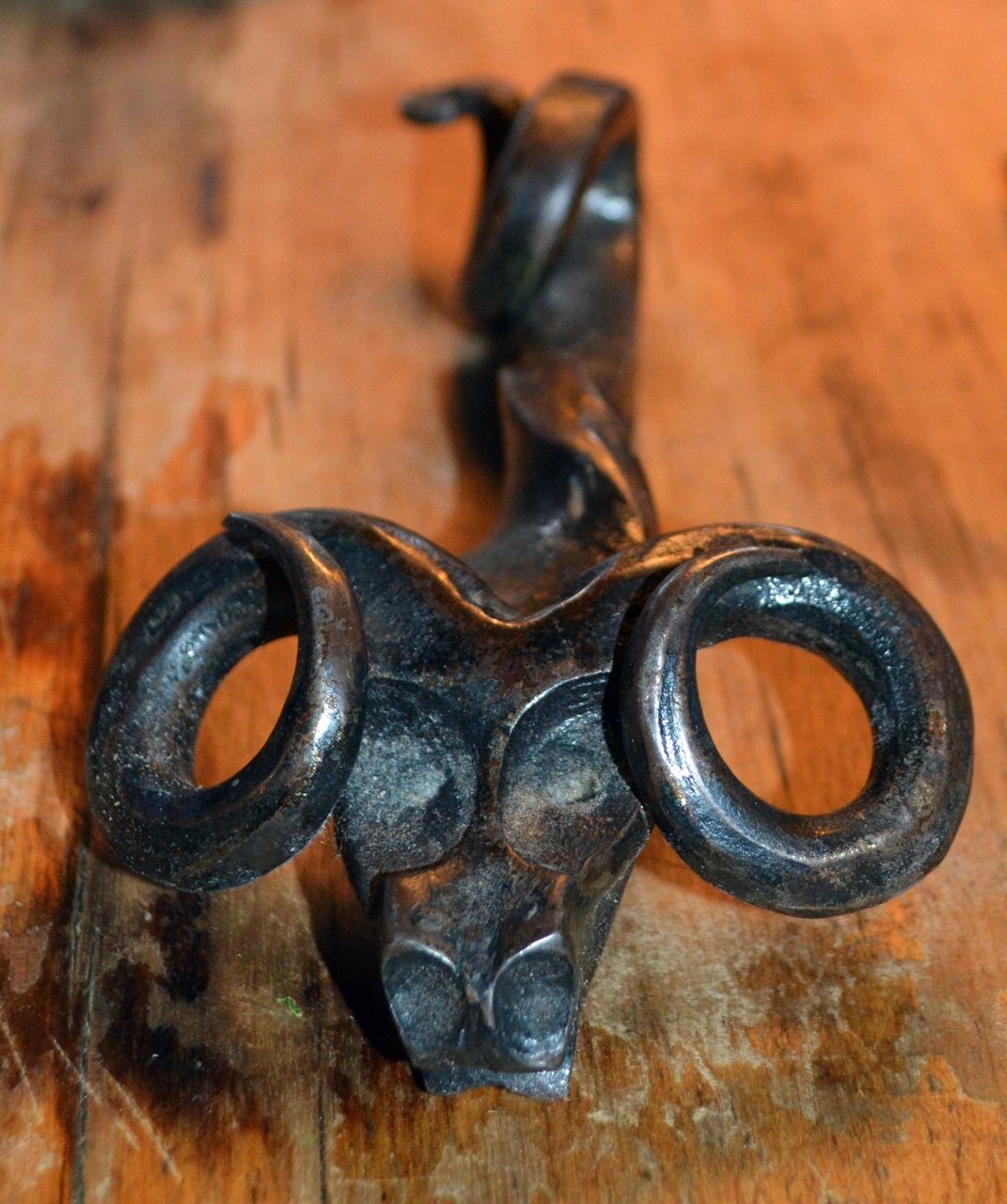

For a time I did demos and craft shows back in the 1980's. Here is my traveling setup - Everything was a 100lb or less so I could lit it into my pickup! - That is a brakedrum forge.

tcreeley: I really like that door knocker
