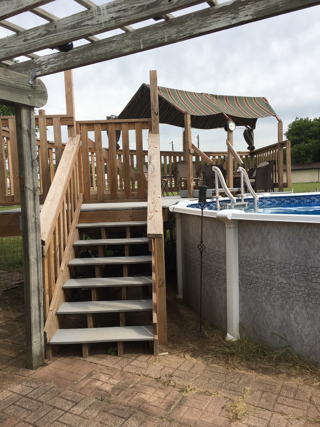

Wow, I really like that! Very nice. I was envisioning nearly an identical setup; especially the covered portion. The only difference in my imagined design is a metal roof with a single slope. This is hurricane country; a canvas roof might last a year if you're lucky.
Are your upright poles set into the ground or sitting on blocks? I'm thinking I'll auger holes and set my poles in the ground with cement. Just a bit of insurance against blowing away.
But you should be no stranger to wind, right? Don't you guys get tornadoes? I lived in The Colony for a few years as a kid and I remember the monthly tests of the tornado alarms. It sent me running home each time, even though I knew it was a drill. I had/have a phobia of tornadoes.
   / Any apocalyptic way to kill nutgrass? #42
For the posts I dug down 30” and put 4-6” of concrete at the bottom and let it cure and then placed the posts and filled in with dirt.
The canopy cover so far has survived two storms with gusts up to 60 mph. I take the canvas down post season.
My concern with a single slope cover is the wind lift load (don’t skimp on ur fasteners securing the metal panels to the frame). An “A” frame cover reduces wind lift.

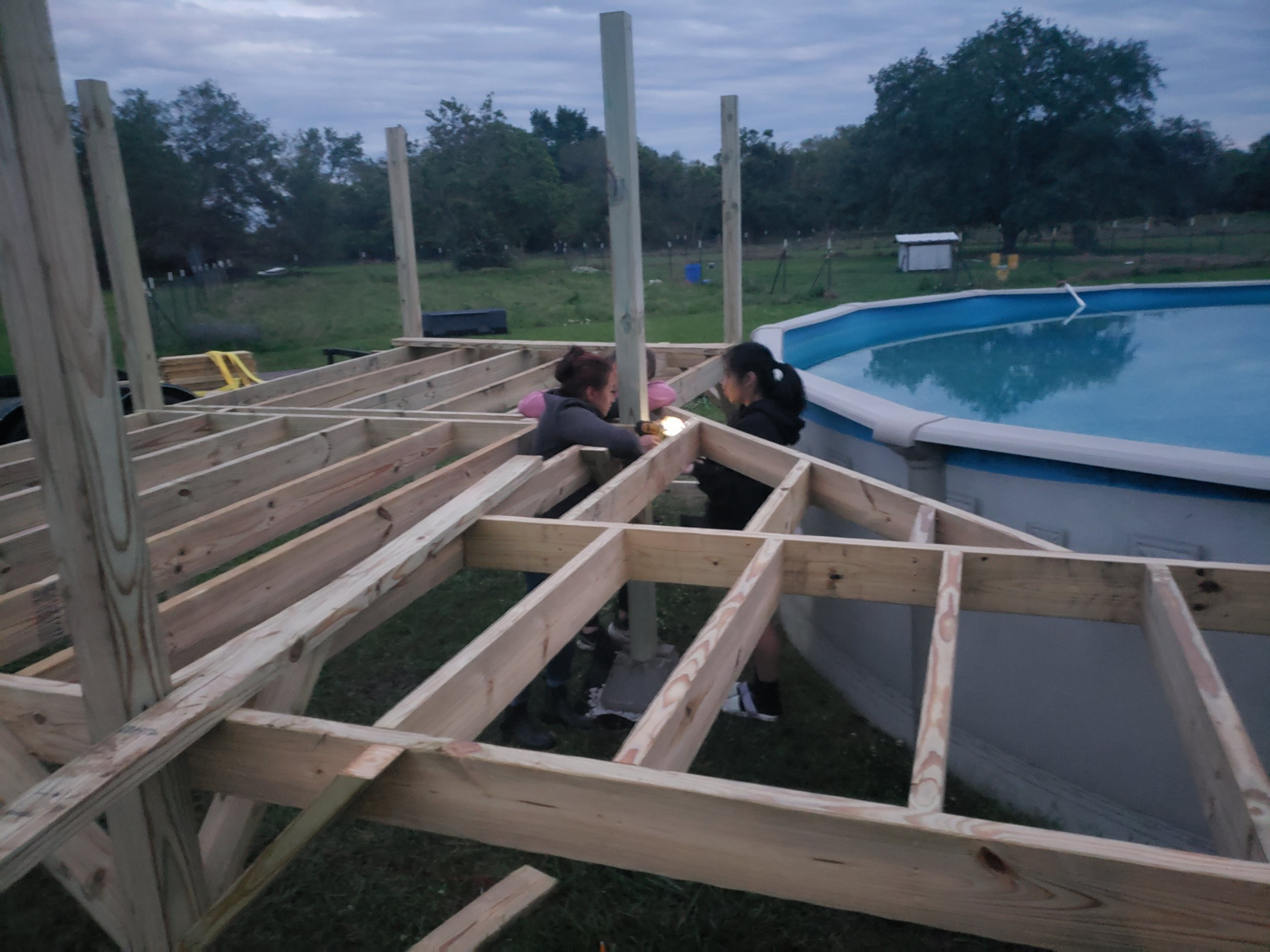

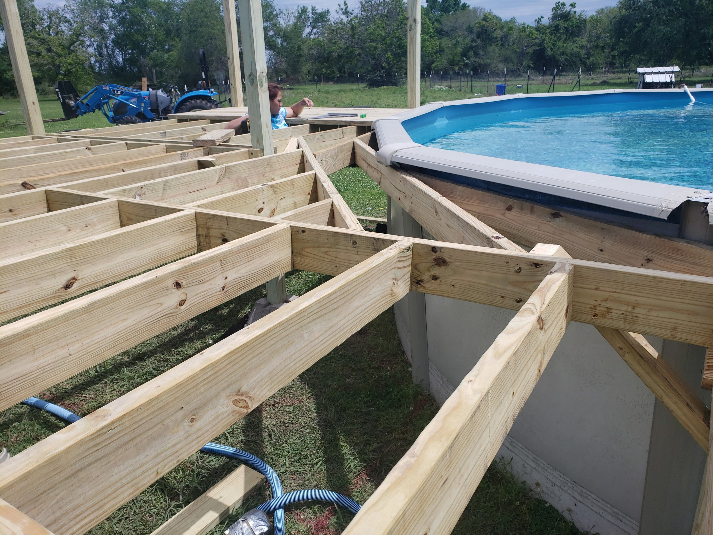

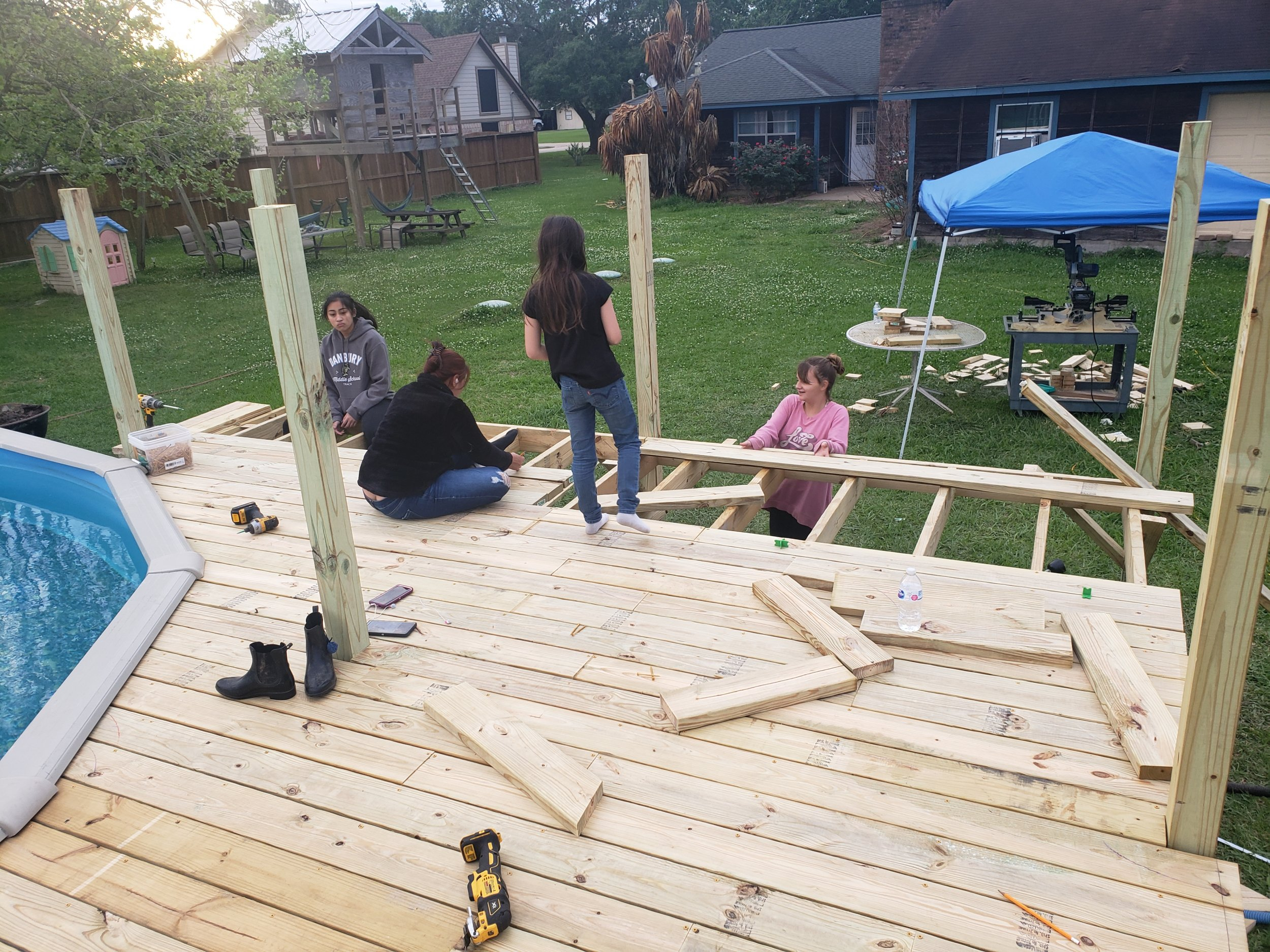

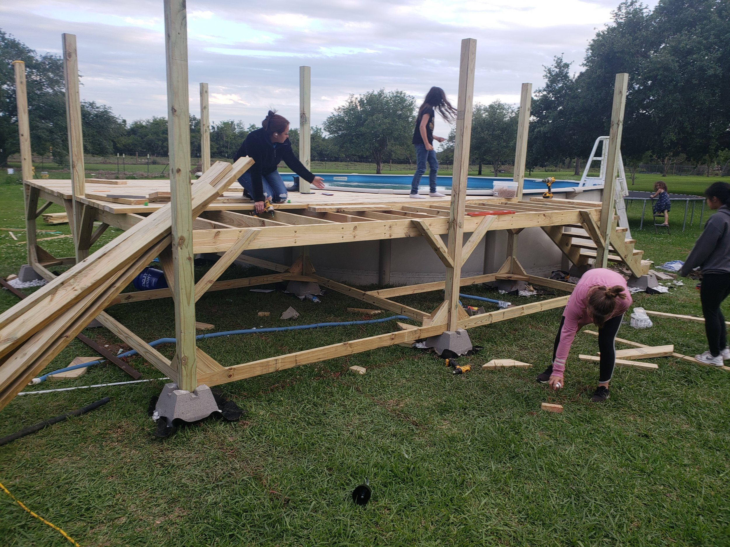

Well I waited 2 years for price of wood to go through the roof and it finally did, so I built a wooden deck. Well, not built, but in progress.
My daughter wants to have a pool party for her birthday at the end of the month and I said no problem. Then she said it's hard to have a pool party without a deck. I said there's not enough time and wood is too expensive. So my wife said she would build the deck. She has been building a few projects lately and doing a fine job at it, but this was biting off more than she could chew and I couldn't not take it over. So with my all female crew this is what we accomplished this weekend.

Looks great! Years of enjoyment lie ahead!
   / Any apocalyptic way to kill nutgrass? #47
Wow, that's a lot of work, and the price of lumber is high... Glad you got it mostly done.
