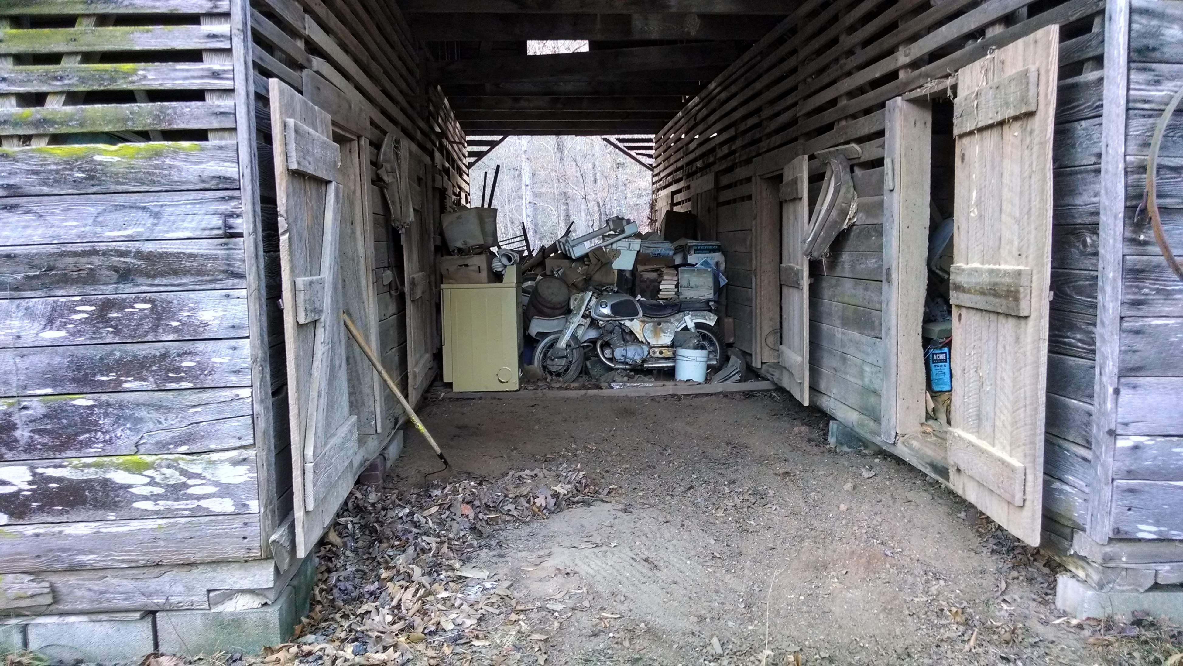

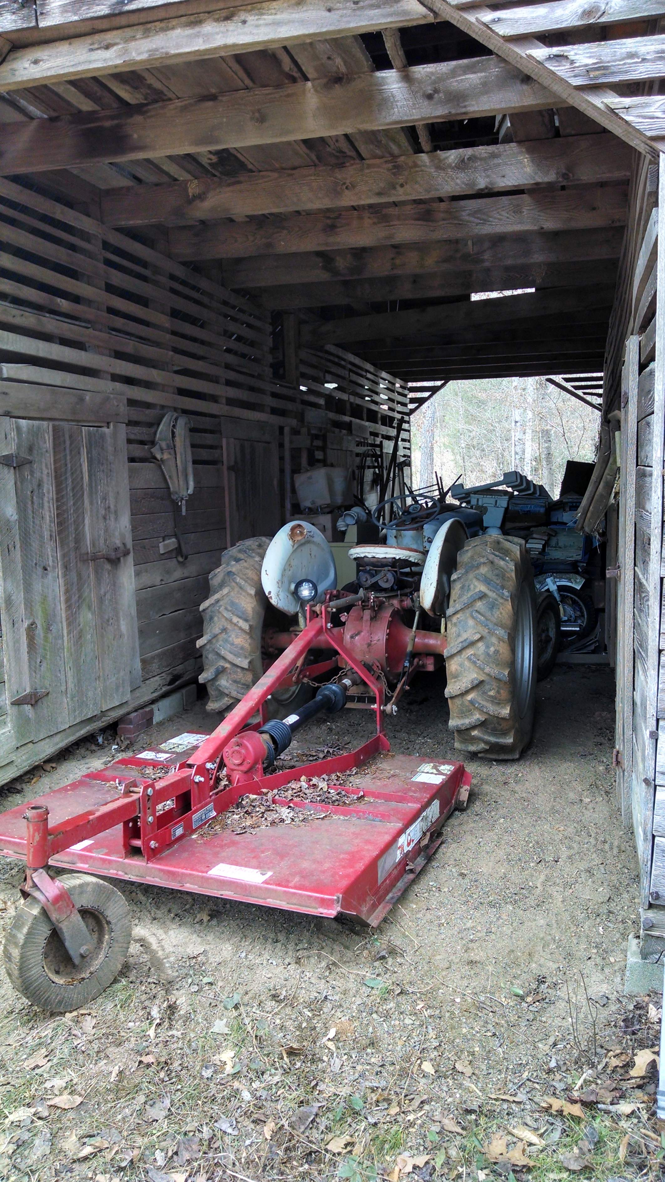

Thought I would throw out the idea, once again, of considering the old barn as a conversion to a workshop? I know that with my schedule and the realistic cost of a metal pole barn, I would be investing roughly $40K into a shop that would do the job of what most of us like.
In saying that, has anyone here done a 'corn crib to shop' conversion? I'm not looking to cut corners or do it as cheap as possible, but I would love to incorporate this already built structure into an insulated, conditioned, and lighted workspace. I'm thinking of jacking it up, slab poured, add horizontal slats where it's open, remove the (8) stall dividers, insulate with sheet foam, and run shop lights. I've included a couple more pics of how the stalls are set up, and of the open run down the middle. Am I looking at more than what a new pole barn would be?? OB Phone pics 160.jpgThanks for the help, and I'm also interested in where the strength of this barn relies upon.

The uprights on the sides are locked into the bottom sill. The sill guarantees their spacing. The uprights work like stick framing does, but with beefier ones every 8 or 10 feet. The sills lock together on the corners. The uprights lock in to them. You have in effect, two rectangular boxes with the alley way down between them where the tractor is. Those boxes and the uprights hold up the second floor. The cross ties keep the second floor together, and the roof from sagging and spreading the walls.
Every piece in that barn is doing a job. If you take a section out- you need to replace it with something doing the same job. Be careful of the sill and keep the uprights anchored into it. The sheathing and corn crib walls provide lateral stability and also lock it together. Interesting project. I'd be tempted to reinforce what you have, and just build an insulated room inside it for a shop.

Thank You! The upstairs is unbelievably spacious, but kind of hard to get the tractor and jeep projects up there!
Funny you mention about using just the one stall as a shop, as that seems to be the easiest, and the first idea I had. But tough to section off one area without it affecting the other. I thought about enclosing the hall, but then that sections off the stalls. I need to find a way to properly 'gut' the bottom portion of the barn, but keep it stable like you said. Would a typical GC know how to tackle this, or is a structural engineer more appropriate? My vision is to be able to have near the same capabilities as a 30x40 modern pole building.
