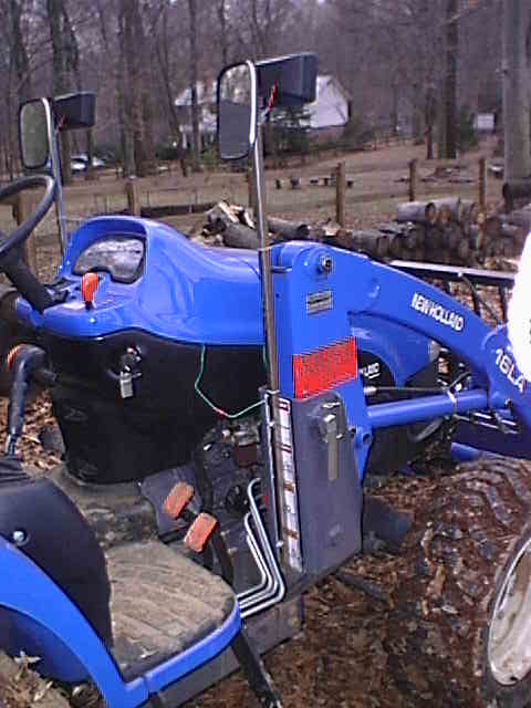

I don't play computer games but I've seen pics of the handpiece on controllers. The NH Class III Deluxe sure feels like the computer game controllers look. I agree with MarkinNH and Pineridge - this is what you are looking for.....
Mark
I've attached a picture - the joystick is mounted to the right fender and has an orange face-plate. The center of the joystick has two thumb buttons for a high/low speed selection.

The one PineRidge Ranch has On his NH is what i am looking for.
I looked on Kubotas website, but there was no mention of it. Anyone know where I can get a pic of the Kubota one?
thanks for your help.

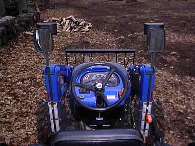

Alright Mark, where's you get those cool mirrors/lights? /forums/images/graemlins/smile.gif

Made 'em. 1" box steel about 3' high. There are already holes under the stickers on your loader uprights - bolted there. Drilled and bolted on mirrors - trailer mirrors from Autozone. Bolted on floods and ran hot wire down the center of the "stalks" (which serve as grounds.)
Only complaint - they are not spaced wide enough to see clearly around the back. I will be attaching the swing-away stalks that came with the heads to widen my view.
