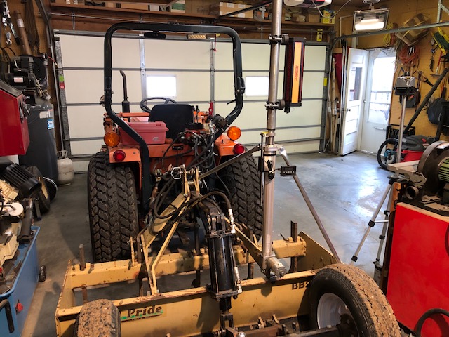

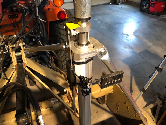

Thinking about the linear actuator got me going again. :) I have a linear actuator mounted on the box blade as shown in the pics with up, down, speed control and remote readout on the tractor. The idea is to take grid readings of the elevation of a work site prior to grading. This is to calculate cut and fill and finished grade elevation and it would be a manual process by moving the rig to the next location on the grid, raising or lowering the receiver to take a laser "hit" and then recording the reading on the remote readout at that location. Then rinse and repeat.
With an automated setup for grading the same electronics that control the blade height could be switched to and used to automate the surveying process mentioned above. The process would be driving to each grid location with the linear actuator energized by the auto control so it would elevate to follow the laser beam. The blade height would be clearing the ground by several inches and the cylinder wouldn't move during this process, only the actuator which is DC motor driven.
The digital readout I have mounted on the linear actuator would give the continually changing elevations to the operator's remote while driving and could be recorded statically at each grid point. The GPS coordinates could also be recorded at that point but that's another story.
