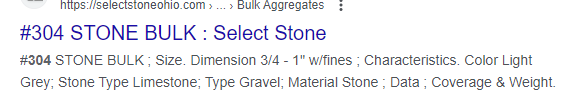

I'm not sure what you are trying to learn from the guy. Aren't most specs based on some quality that needs to exist in the final product? Looking at the 304 spec online today, it's interesting that the size, shape, crush, fines or not, and even the water resistance in the 304 specs varies with what what substrate is used to make the 304 out of. So for that material I get the impression that it is designed to be an intermediate compaction layer material rather than a topping.
For the top dressing layer - even on a parking lot - I'd be a bit more picky about the material and probably go down to the yard and pick it out instead of going by some commercial spec.

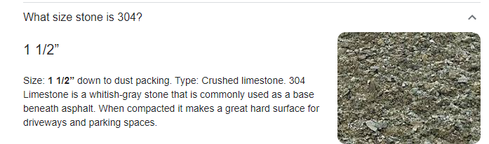

   / Any Excavation Professionals Feel Like Giving Advice? #86
ho yes just google it, super clear, its standardized across the industry...

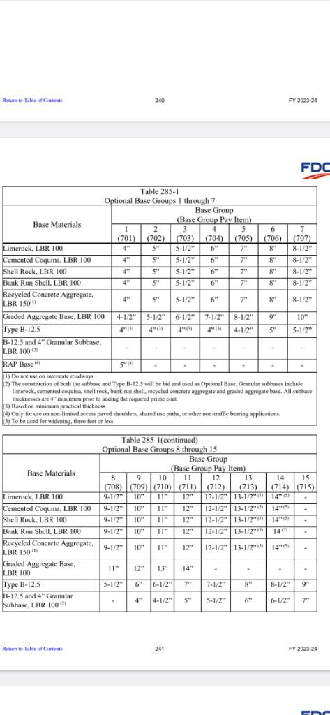

I attached screen shots showing the approved FDOT optional base groups, and sub standard base groups. Notice there isn't #57, #8, #83, ect.
And maybe back to the OPs question; the reason it's called OBG, Optional Base Group, is typically, plans will call for say, OBG 9, and it's the Contractors choice of which material to use, as long as it meets FDOT Spec and thickness is defined by the chart above. So contractor A might use 10" of Limerock LBR100 and contractor B will use 6" Asphalt B-12.5; but the materials are considered Equal, and the state would pay the same for either.
Keep in mind, the way this generally works; the requirements are basically specced out, but you would Never dictate Means/Methods.

304 is a mixed stone specification so there is no size to call out
Every crushed gravel has a stone specification with size to call out. Every one.
