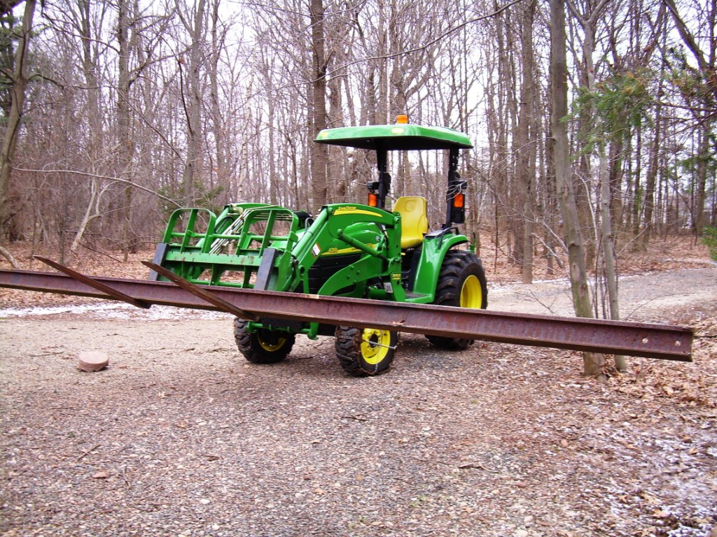

Forks come in handy for large bulky things like logs, poles/pipes (rails)

Just thought I'd post an update about these eBay forks after getting some heavy use out of them this past weekend.
They are simply GREAT! I was able to move around 900+lb attachments and 12" diameter X 10' logs effortlessly for the Kubota with the 762FEL. The model I bought has the forks that "slide" side to side on a heavy 1.5" solid rod that's suspended by two supports (see pic). I like this setup because I have 4 pressure points working on the bucket vs. just 1 or 2 like the Paynes forks and you don't need an additional expensive "crossbar" over the tines to get in the way. Plus there are extra reinforcing angle iron near the bucket-end of the tines to prevent bending. Attach/detach is a breeze and no sliding or "wandering" on the forks either since the cross-bar is bolted to the attachment points and the tines have holes through them that hold snug against the cross bar as well!
I also built a "backstop" for them about 18" high that fits down in the holes, but I need to drill some 1" holes through one of the center 2X4" backstop boards so I can spot my loads through them better. Most of what I'm going to do with them won't even need the backstop, but it's nice for things that might slide off otherwise such as logs or anything that might otherwise swing back into the grill of the tractor.
In short, for $420 delivered to my door, these things work and my hats off to Greg at GroundWorks. He did Michigan proud on these. I'm no salesman either. I'm just pointing out a good "quick attach" alternative out there that's reasonably priced. :D
