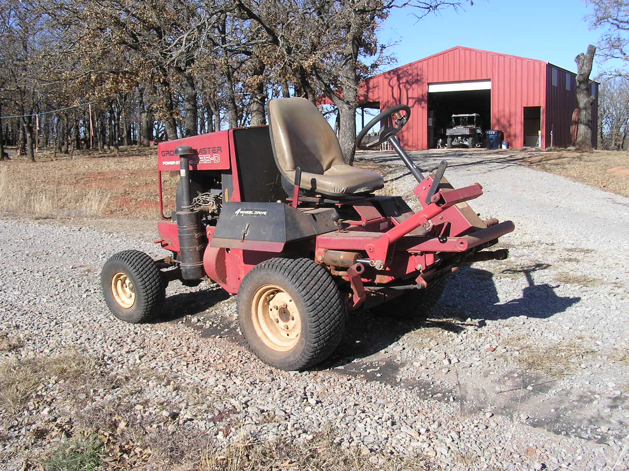

I am looking for a used spring suspension seat base for my TORO 325D, like this one on the 328D.
That appears to be a Toro Uni-Pro seat.
K & M Uni Pro Replacement Bucket Seat — Gray, Model# 6803 | Construction Agriculture Seats| Northern Tool + Equipment
https://www.turfseats.com/p-1752-toro-129-uni-pro.aspx
You could add a Grammer suspension to it.
https://www.turfseats.com/p-1893-km-msg83-mechanical-suspension.aspx
There is an air seat version as well.
