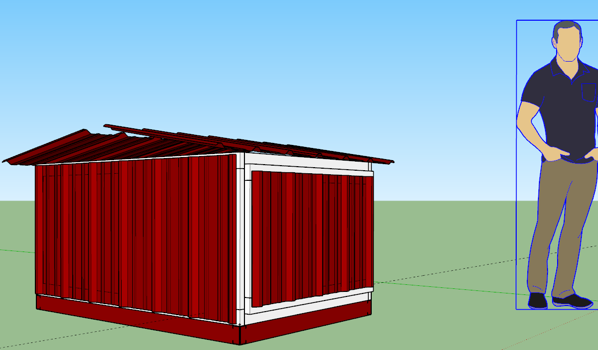

Thank you everyone for your input. I have followed up on the suggestions and come up with a design. I like certain aspects of the chicken tractor idea, but some other aspects I don't. My plan is a chicken tractor (ish) coop combined with free ranging.
Things I like about chicken tractor:
1. no floor, no bottom to clean out.
2. continuous/daily movement to cover property with natural fertilizer and pest control
Things I don't:
1. cheap construction; Most chicken tractors look shoddy (this is really my wife's thing. She's the one with standards and wants it to be aesthetically pleasing) and structurally weak.
2. light weight, would blow away in my area (Texas gulf coast, hurricane country)
3. chickens seem cramped in there; would like to see them roaming around, being chickens
4. takes an adult to move it
5. The bottom part is almost always wood, which rots in contact with earth.
So here's what I've come up with; please provide constructive criticism. If any changes are needed then I would rather do them now, before I get too far along.
(roof ridge cap not shown, nor wheels)
It's a simple structure designed mostly around the dimensions of the scrap R-Panel I have on hand. some details:
1. It has no floor
2. The narrower end walls are hinged. With both doors open, it would be like an open corridor. One door will be open for the birds to come in/out. The other end will be the back side of the nesting boxes, so it can be opened to easily retrieve the eggs.
3. It is a wooden structure constructed of treated 2x4s skinned in R-panel, but sits on a metal frame which will contact the ground. In my experience metal takes a lot longer to decompose in contact with earth.
4. It has wheels centered on the coop, which are mounted on offset arms. The wheels can be easily rotated up, so that the coops sits on the ground, or down, lifting the coop up, to be moved.
5. It is longer and wider than it is tall, and is stout, relatively heavy, presents a low center of gravity and low wind profile, to keep it from blowing away. Despite being heavy, the wheel lift arms have a very high leverage factor and with the weight centered on the wheels it should be easy for my 7y/o daughter to lift it and move it to a new location (this will be her chore).

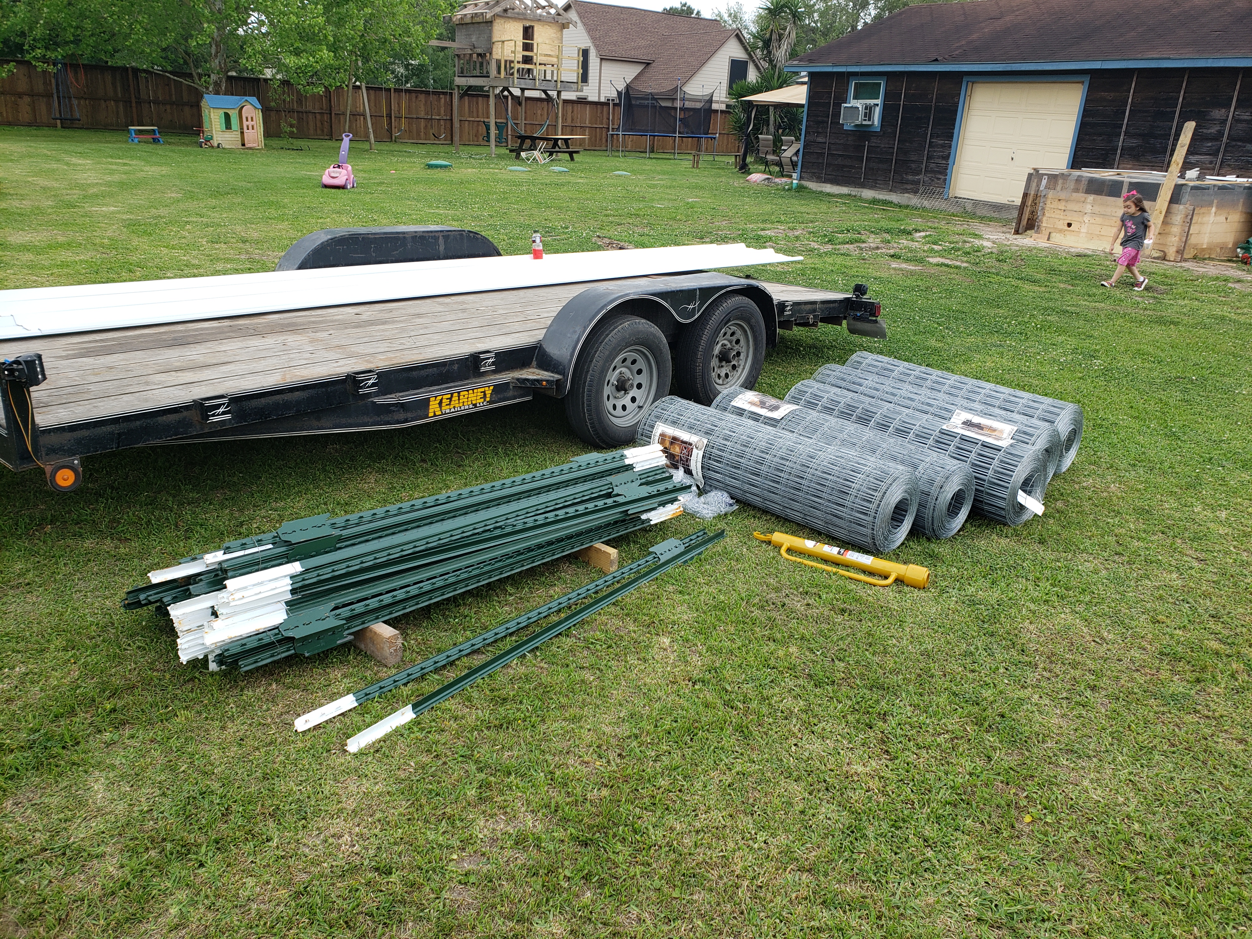

I have purchased 500ft of welded wire fence and 70 t-posts from which to construct temporary/semi-permanent paddocks. The plan is to cordon off about 1/4 acre of property at a time and move the coop around inside there daily. I have 5 birds currently and I plan to get 5 more. If I can leave them in the same 1/4 acre all year without them depleting it, then I will shift the paddock around each year, planting my garden (about the same 1/4 acre) in the place they were the year before.

You have a 46 hp tractor, presumably with a FEL? Make a HD chicken coop and move it with the tractor like I did:
I then put it in the middle of my dog run in the middle of my Poplar grove (think: shade from the sun).
That was my first thought and I went back and forth a lot on it before I decided to give it it's own wheels. Would have been much simpler. I decided against it because I don't want to have to be the one to move it all the time. Starting/warming up the tractor each day, moving the coop, putting the tractor away, a 5 minute chore turns into 30 minutes. And we get a LOT of rain here and my property doesn't drain well. I would have a muddy rut lot before long. I only drive the tractor on the lawn when it's dry unless forced to do otherwise. With the coop having it's own wheels and being easily movable, I can send the kids out to do it, and it can be moved even when the ground is wet.
All that being said, I really like your coop. Very slick, looks very robust.

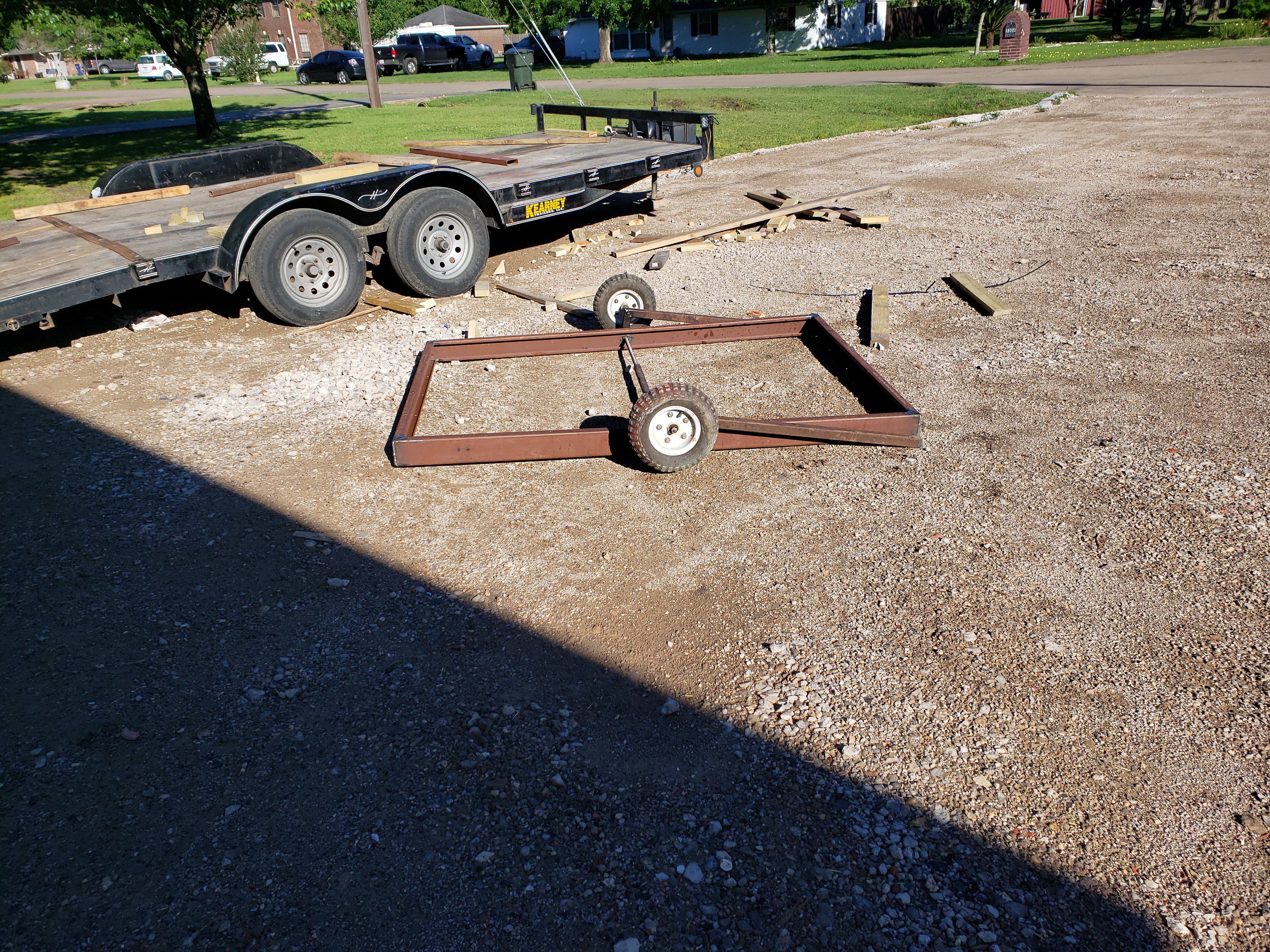

Made lots of progress today. Almost done. Just need to go get some hinges for the other door and some hardware cloth to seal it up. Also I need to put some sort of handles on the wheel lift arms and some way to lock them in the down position. I'll figure it out tomorrow.
20190420_153802.jpg 20190420_172030.jpg 20190420_140425.jpg 20190420_185922.jpg 20190420_195720.jpg

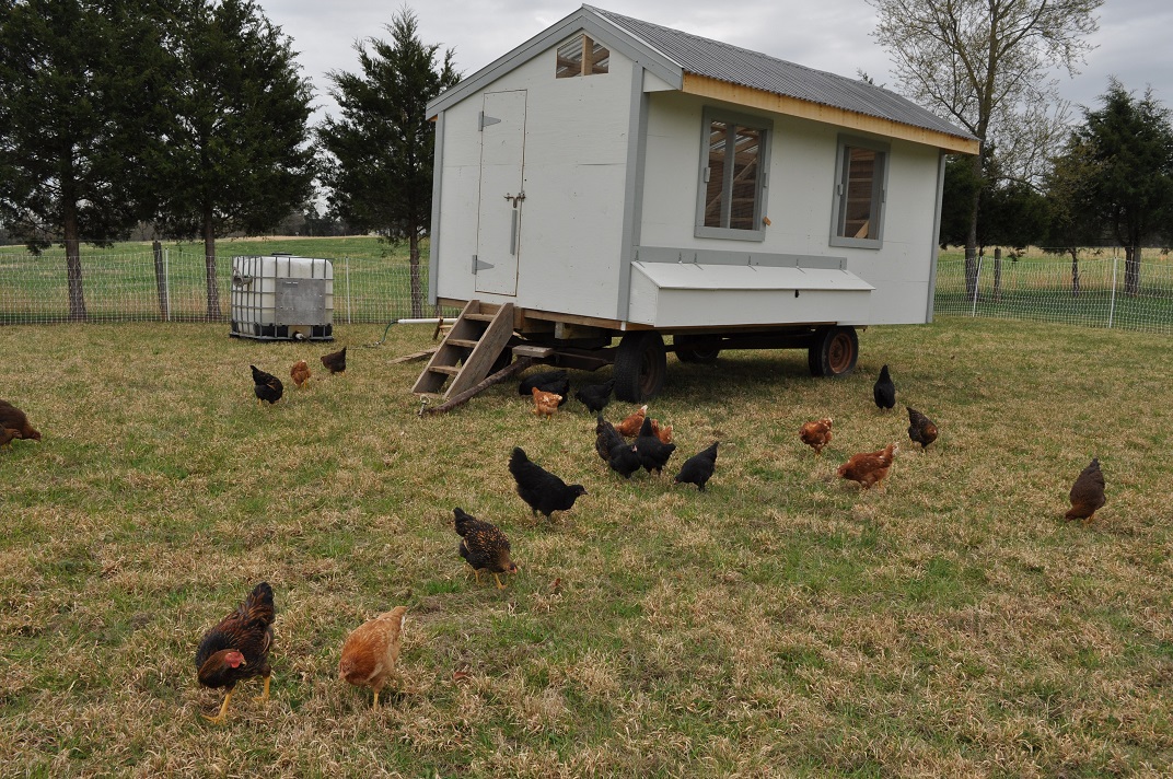

I built my coop on an old hay wagon. I can move it around the fields so there is always new bugs and grass for them to eat The roost is at the back of the wagon and has 1x2 welded wire under it so the poop falls to the ground. The remainder of the floor is 2x2s with 1 1/2" gap between them so half of any poop falls to the ground but it is strong enough to walk on. The windows cut outs can be put back in during the winter to reduce wind inside. The roof is polycarbonate panels to let light in. I use electric netting fence to keep the chickens in and predators out.
/ Any good online reference for chicken coop design?
#16
Wow! That's impressive. I considered buying an old boat trailer to put it on. I found one under $200 but needed new wheels. Ultimately just used what I had laying around.

/ Any good online reference for chicken coop design? #19
That is a great coop. I need to try that some day.
My bad: I missed the part about having kids.
By all means, put them to to work, it will make them better adults.
